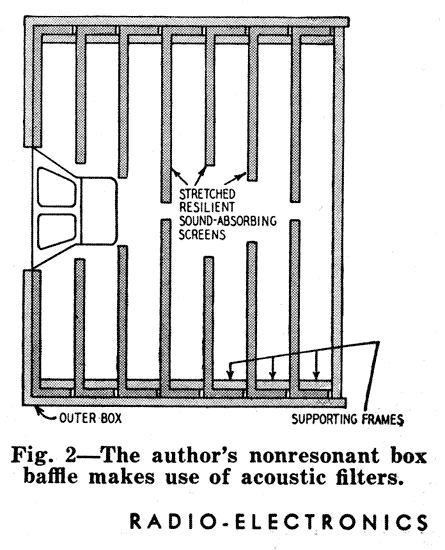

RadioElectronics Article
HiFi article
The Patent.

this is worth trying, it s what I had in mind when I built my 15” speaker
A Big'un - the Audio Nirvana Super 15
There’s a related design called the Boffle, you can Google that.
Cool thanks! And sorry I haven't been getting my notifications for some reason so I miss a lot on here when I post, although I'm not posting much anyhow etc.
I'll check out the Boffle thank you.
