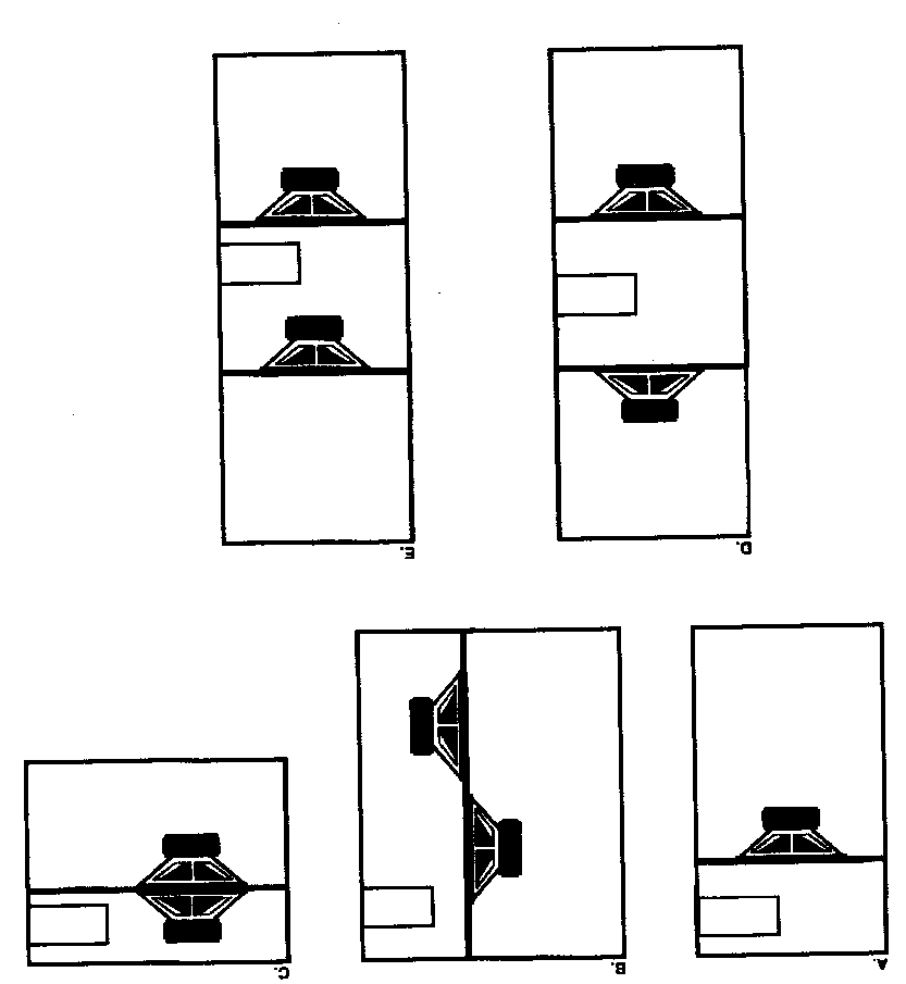

Yea they need a baffle/large sealed enclosure, preferably infinite baffle.
I’m working on a mini setup right now of this fan sub with the blades I’ll let you know if it works its almost finished.
I reckon this would work 2 subwoofers with massive excursion e.g. jlaudio w7, mtx thunder9500 or the RFL subwoofer would work great with like 4 inch travel, 2 of those subs forcing the air out of a very small port that’s like have the pressure of the fan sub.
the fan sub's claim to fame is its large displacement not high pressure. It can move a huge amount of air at low frequencies compared to any reasonable number of conventional subwoofers. What Hayden seems to have come up with is a compression driver in that it would produce high pressure, but not the necessary volume at say five hertz. Horn load it, then we are talking!

Yes, that is what i mean by volume. Volume in the physical sense. If you put dc to a fan subwoofer it could move enough air to fill up a hot air balloon if given enough time. If you gave dc to a conventional subwoofer the cones would move to their xmax and stop. now, most of the time we are nowhere near dc, however the volume of air which needs to be moved at five hz is pretty much unachieveable by conventional means. This is where a fan subwoofer comes in. Horns are a different beast altogether which i dont understand so I will recite the doctrine: horns convert high pressure into high volume like a transformer. I think your diagram is very interesting because you have drawn a horn compression driver without knowing what one looks like!
The small sealed chamber behind the woofers limits their excursion and their functionality to moving small amounts of air at high pressures. Then the air must exit through a small mouth which again reduces the excursion and increases the pressure. In a proper compression driver what all this equates to is a lightweight diaphram which doesnt have to move much. This allows one to concentrate a strong magnetic force on a short voice coil capable of generating large amounts of force. In order to reap this advantage a horn must be added to convet the high pressure into high volume. There is always a tradeoff, especially down low, where a horn capable of acting at five hz would have to have to have a mouth of a quarter the wavelength of sound in air at five hz.
The surrounding air (ie. the air in your room) has a low pressure, so a high pressure build-up like in front of a driver is inefficient in transporting it's energy too the surrounding air.
A horn transforms the high pressure (/low velocity) in front of the driver into low pressure (/high velocity). This way it's much more efficient in the energy transport to the surrounding air, resulting in higher SPL (sound pressure level).
To direct the sound, the length and moutharea of a horn need to be in proportion to the size of the wavelength, that the loudspeaker is going to reproduce.
A 5 Hz wavelength is ~ 67 meter (~220 ft.). To keep the horn small, the horn length is ussually the same as the lowest 1/4 wavelength it represents, so 67/4 meter (still very long).
Below the 1/4 wavelength resonance the horn frequency response drops of quickly. If the energy at the rear of the driver is utilized (like with a closed box) these properties can be optimised for the desired parameters.
The fan would likely still need a IB as rearchamber if at all.
