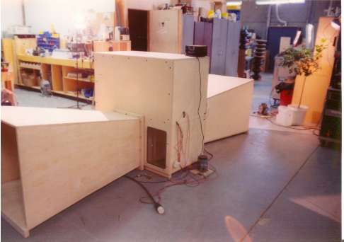

Tom Danley did some designs like this. They were called Servo-Valve loudspeakers, and developed air movement in each direction by using a four-way valve with a servo-motor operating a lightweight panel to divert the air flow. A fan operating with a constant speed provided the airflow, and at zero output, the valve was oriented so that no air movement was produced. Something about ungodly amounts of information at 3 Hz was mentioned.

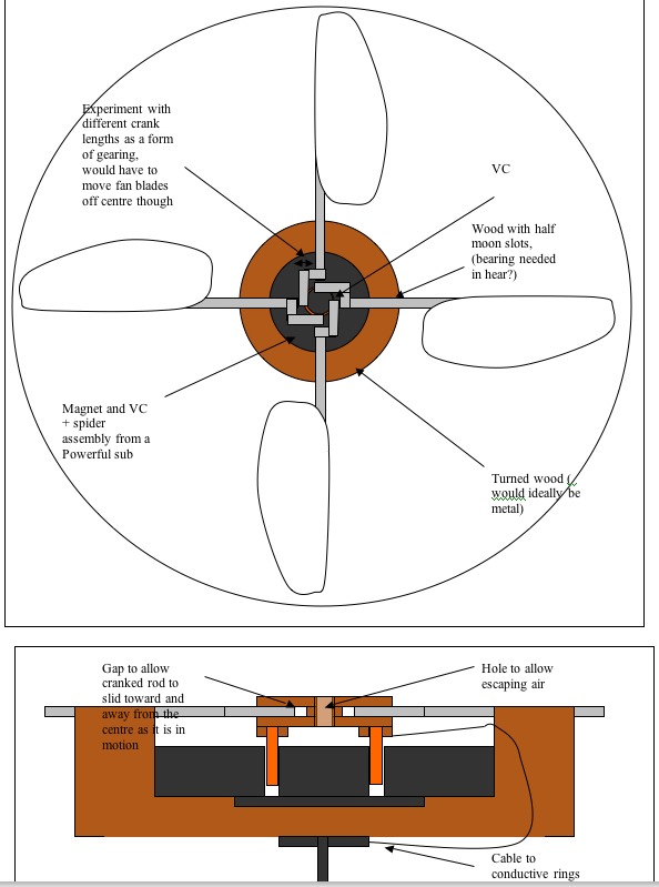

the pic below is a realy bad diagram (drawn in word for lack of anything better to use) to try to explain how i intend to make my vaiable pitch prop. feed back would be cool.
some things i dident mention on the diagram, i beleve the shafts to the fan blades should be holow and eather bent, or cut and glued/solderd/welded at the cranks. idealy i beleve they should be made from carbon fiber to be stiff and light, but i dont beleve ill be able to get access to any to test this. ill prob use small copper pipe or some kind of plastic.. i also think the blades should be made out of carbon fiber for the same resons. might have to resort to glass fiber though.

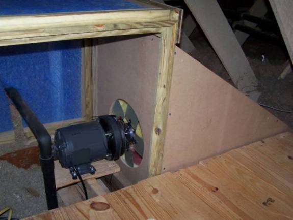

FYI, if you want to build a fan subwoofer, you need a baffle of some kind. Otherwise the rear wave will come around and cancel out the front wave. The fan woofer shown in this thread is installed in the attic for an infinite baffle. You could also use a window.

those pics of the inner workings look not disimilear to what i had in mind, allthough surly by making the shafts and crank linkage things outa what looks to be aluminium there limiting there higher end output by the weight and therefore the speed that the mecanisum could change direction.
i beleve if all the moving parts that the VC will have to move should be as light and stiff as posible that the unit would be able to cover the freqency range simmiler to that of say an 18" bass driver used in live sound systems, but obviously with extended low end responce.
idealy i think the shafts and cranks shoud me produced out of carbon fiber rods, or at least holow tubes of alu.
