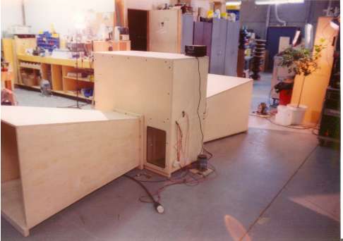

Both the Thigpen fan design and the Danley vane are making an amplifier, actually. A large amount of power moves a big mass (driver) and a relatively small amount of power is used to modulate the flow.
The Thigpen Rotary sub works exactly like a helicopter swash plate, but only does half of the functions--all blades twist the same amount at the same time. In a helicopter, one control twists all blades and the other control makes them twist more on one side than the other. (See http://travel.howstuffworks.com/helicopter5.htm)
In a rotary woofer, I would recommend a single servo motor, or a pair that can push on a swashplate.
A bandpass box to contain the out-of-band noise (like everything from 50Hz up) could be built just like a (somewhat larger) car muffler.
On the backside, some sort of infinite baffle box to waste the entire rear wave would be fine. An attic, the whole outdoors (venting through an exterior wall).
Nothing says that the control of the blade pitch needs to come from behind the blades. A motor in back spins the axle that drives all of the fan action, and a linkage on the other side of the blades could tie into the pitch controls.
The suggestion to have a servo motor on each blade was pretty wild, but may ultimately be the design with the lowest noise.
Since we don't really care how much mass is spinning -- we actually want lots of mass/momentum on that whole assembly. The only low mass component would be the blades themselves. You could actually mount several servo motors and spin the whole mess.
What would be a decent way of running the signal to the servo motors, then? Would need to be something like the concentric traces used in rotating lights (like older police car lights or disco spinners).

A 10", 12", or even 18" driver isn't going to be able to have anywhere near as much output as this thing at infrasonic frequencies. And there is no "wind", at least not in a sense that makes it separate from sound. It's simply pressure waves.
Hayden said:
btw the fan must have fast acceleration because the wind takes longer to reach you than audio does.
The fansub runs at a constant speed, it's the pitch of the blades changing that creates the sound, it alternatly sucks and blows air in the room creating a pressure change, it's a different effect to a normal fan blowing air around in a room. When there is no sound playing the fansub doesn't blow any air, it just spins with the blades at 0 angle of attack.
