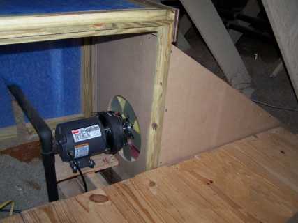

Interesting, I spent about 45 min in the room listening, taking pics and talking to Bruce. I certainly noticed no adverse effects afterward.
It's a 3 phase 1/3rd hp motor spinning at a constant 300rpm. A 3 phase motor is used becase it's rotation is smoother than single phase.
The flat sided blades create a rising response as the frequencies drop. The curved blades have a flat response as frequency goes down
Here are some more pics of the Thigpen rotary woofer.
Experiencing it was so cool, I certainly want one ....😀
The high cost is due to the fact that the current units are hand made. Once in production the price will of course drop.

i was wondering when you would see this thread. i wish you had better pictures of the fin assembly and how they are actually tilted. it looks like a black spider back there, just like a regular old driver motor assembly.
Hi Rob,
Yep according to Bruce basically it is. The trick and not well reproduced in the pics is the articulation assembly. Think of a helicopter rotor, that's basically what's involved for each blade.
The hand in the pic holding the blade, is that of the machinist who made the demo units.
I think the demo at the RMAF was a test run prior to CES.
Edit: there appears to be only one actuator rod from the VC. That rotates one blade, the blades are connected together inside the hub... (I think... 😉 )
