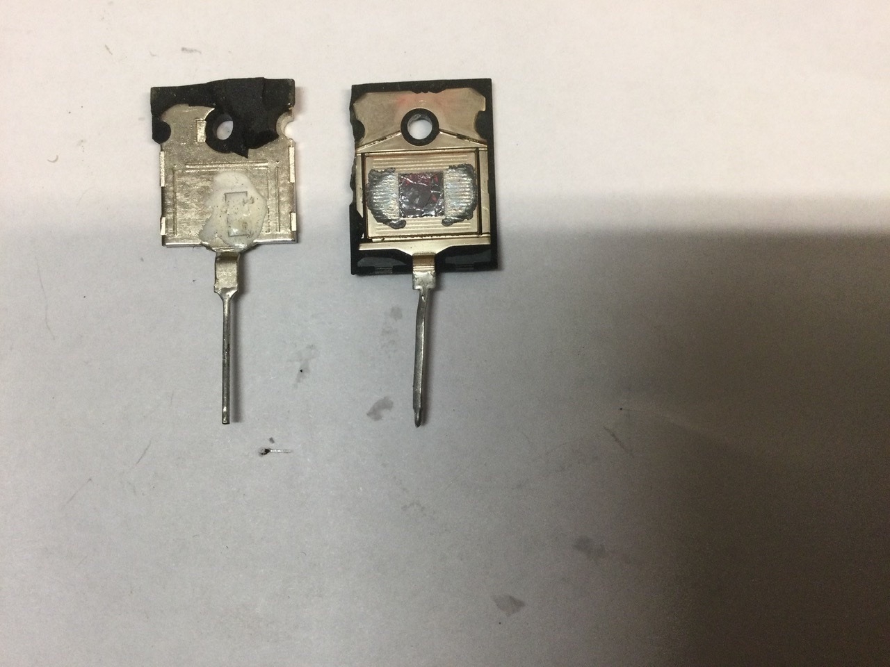

The wires connecting Base and Emitter to the die were very thin on these TIP29955s....
Way thinner than on these TO-3s
I would say they were 'hair' thin...
In the first post there is a picture of Mouser bag - it clearly states COO : CN.
That is to say : Country Of Origin : China.
You were actually able to see the wires? Usually, when you smash open a flatpack the whole top half of the die (along with the bond wires) gets sheared off like in 57. When they survive intact (with white goo) you know they’re fake.
They snapped, but I could see their diameter on the edge of the chunk of plastic..
Looked thin..
Looked thin..
