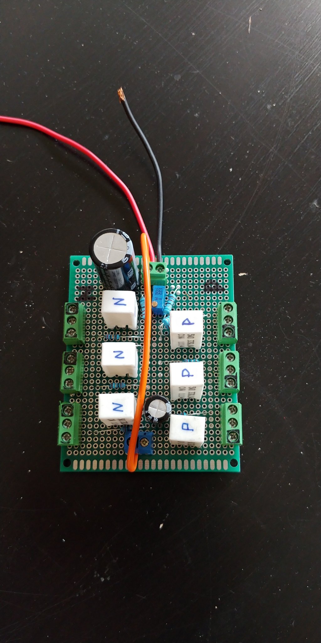

You were the one complaining that the gain was low at 12 not 20. All I was pointing out was that the gain spec. of 20 is at 4A, which I doubt is the current at which your meter is measuring it at.
Power transistors are loosing gain when current increases.
Genuine TIP transistors are showing gain 60-80 on the same meter.
All other BJT transistor I'm testing with this meter also show gains matching their datasheets (at small currents)
I literally tested 100s of BJT power transistors with it.
If these fake ones show gain 12 with a small current, with bigger current gonna show even less.
All in all, I'm more concerned about the pinout of these transistors, not the gain.
Wrong pinout makes them unusable no matter what.

It is not true to imply that a gain of 12 at the current your meter measures the gain at means it will be less at higher currents. That depends on whether the current your meter is measuring is below or above the peak gain. If your transistors have a peak gain at 500mA it could well be that the gain at 1mA is low.
Do you know what current your meter uses to measure the gain?
All I was suggesting is that you make some other measurements to verify your suspicion as others have also said. And the collector-to tab connectivity.
But it IS the point, that´s why we suggest established measuring methods, instead of relying on an unknown meter programmer´s decisions.Please don't turn this thread into "How to properly measure stuff", because that's not the point.
I already mentioned at least twice, that I do not use this meter to measure anything.
This meter was only used to visualize the problem with pinout for the purpose of this thread; low beta was just an icing on the cake.
After I emailed Mouser executives, as Rayma suggested, I got a promise of refund,
and they investigating the issue to find out what exactly happened.
So at least will get my $40 back.
Kudos to emily.gay@mouser.com, their Service Excellence Manager.
Now the question - where should I buy genuine TIP2955s ?

It is not possible to detect pinout on "any" BJT for certain. Some Germanium "choppers" were truly reversible C for E. When there is a difference it shows in B-E breakdown or forward/reverse hFE at normal current. The ancestral 2N3055 was a BIG device with huge low-end fall-off. The modern "3055" and complement 2955 does better but still may be a worst-case that the tester-maker had not seen.At least it detects pinouts correctly.

Did you measure the connectivity between the centre lead and tab?
