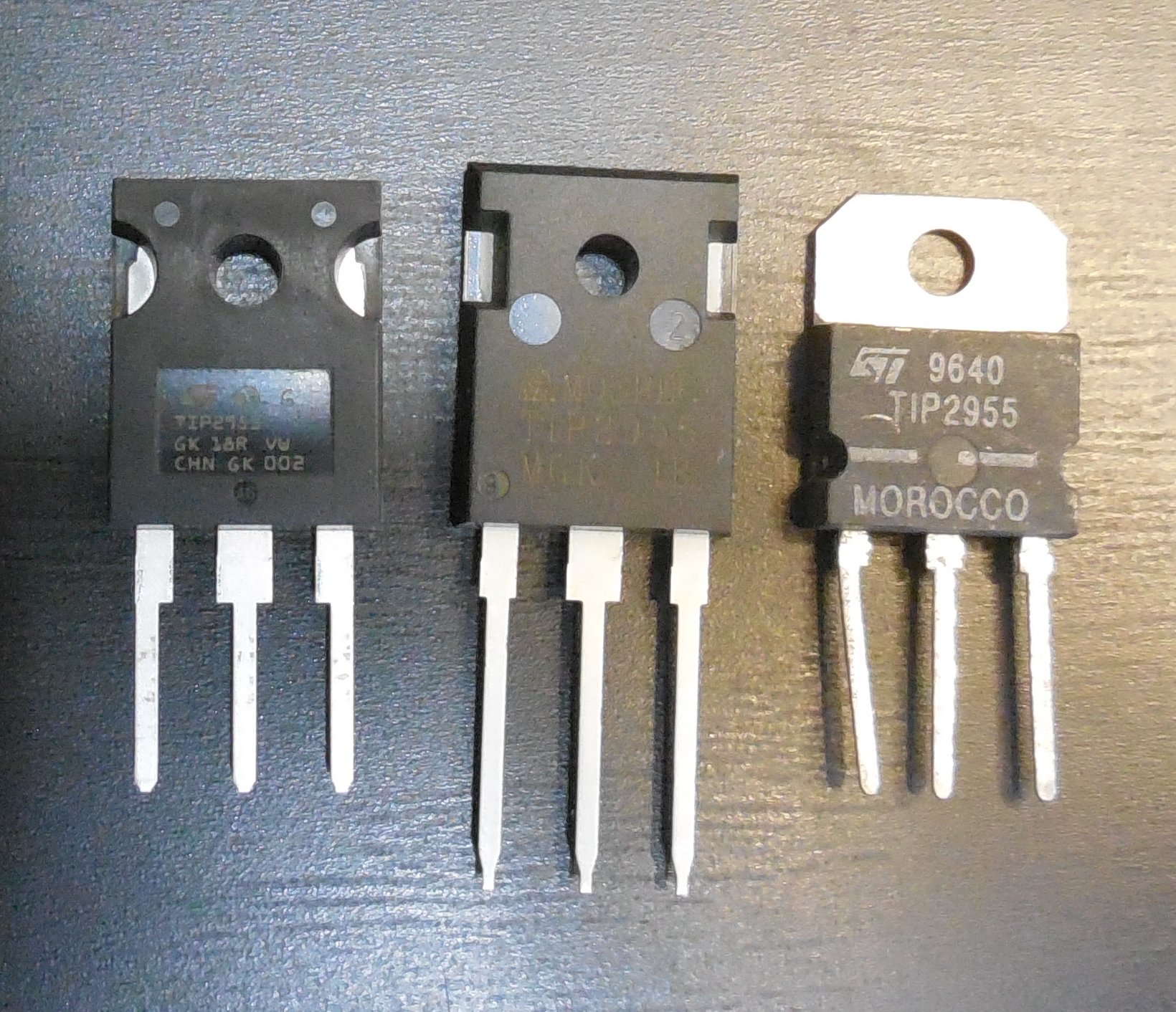

Got more TIP2955 transistors from Newark.com and Digikey.
On this photo: the one on the left is from Mouser (STI) - fake or damaged (don't work in the tester and in actual circuit);
the two on the right : TO-218 STI (Digikey), and the other one Multicomp (Newark)) - working perfectly in the tester and in the actual circuit.

The ones on the right are rare-ish metal tab ones, grab a few more while they last.
The left one has printing inside a glossy pocket, the font is correct, check the data sheet for the cut-out design and dimensions, as traders can tell fakes apart at a glance, I did never ask them how, maybe the overall feel and look.

They haven‘t made that TO-218 in over a decade (Note the 1996 date code). I’m surprised Digikey still had any of them. I can still find them from surplus dealers occasionally. Last ones were clearly STs, re-badged for some second source. Didn’t recognize the logo, but had the Morocco origin code. Measured and worked fine. In with the same batch we’re some TO-247’s with the more modern MAR origin code. They measured identical.
TIPs I got from Mouser recently with the China code on them measured somewhat different. Over 2X increase in capacitance, indicative of a larger die. Higher hFE, too. The lead frames of the modern CHN and MAR coded devices look exactly the same (see the back).

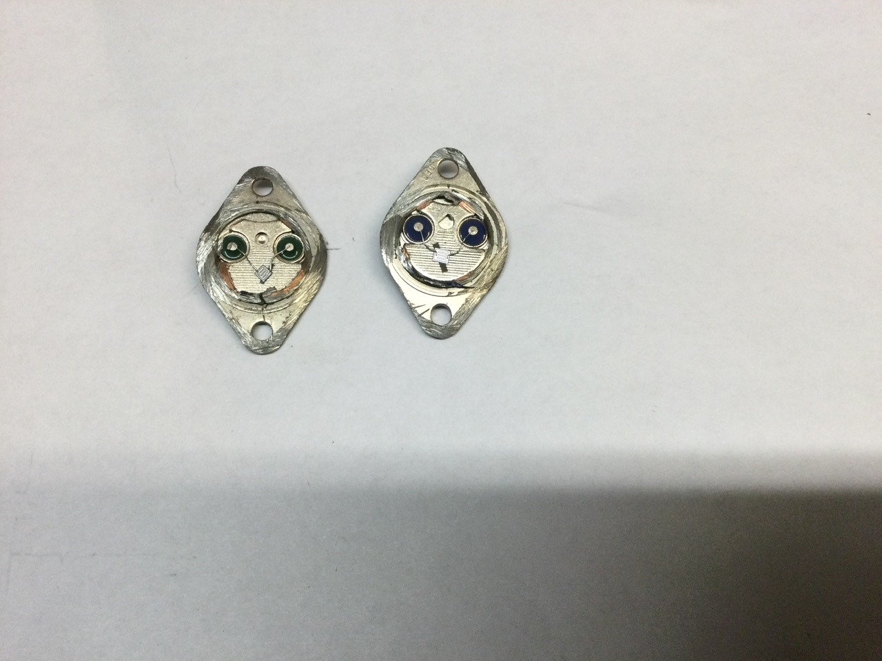

The ones in the center in post 51 are Mospec - which makes good copies of most of the obsolete 2N devices. I’ve gotten a number of their TO-3’s and haven’t found anything wrong with them. They had the white goo inside, but a full size die, mounted at a 45 degree angle, with a proper copper heat spreader coin. And took a hacksaw to open - the lids have proper hermetic seal.

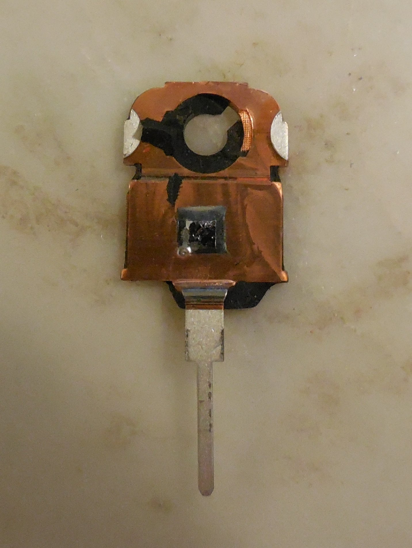

That's the bad/fake one from Mouser.
I didn't open any good ones, so have nothing to compare with...
Still meant to be a 15A transistor with a 15A emitter bond wire. That sets lower limits on die size
