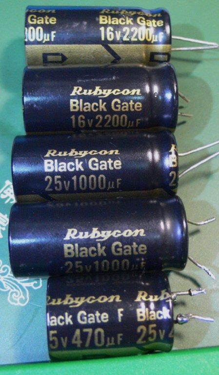

Fake Blackgates??
Congratulations all pics seems originals😉
I'm grateful for the education here. Even with all the differences pointed out by valve, you believe they are all originals?
Have you ever seen a BG you didn't believe was original?
I've seen very poor copies of caps that are obvious to anyone, but most good copies I've seen are indistinguishable externally. That's why I'm amazed you're able to determine they are in fact originals.
You my friend, possess powers far beyond my own.

You must read between lines, my afirmation is only looks originals. I doubt you have had and ear at some time a black gate😀
Different case size for same value, 220uf 100v standard? Anybody else found this? Seems a little suspect to me!
different can size for the same type, and value ?.. yes, that does seem weird, and suspect
..... so are the Tufnol ones genuine?
I have 220uf/100V with tufnol ends

My Blackgates , all originals - from appointed dealer . Note the words are very "gold" & crisp , I am told the faked ones are with less "gold" & blurred lettering - one point that faked goods manufacturers do not want to invest too much money in . This also applies to other faked goods from China ,
please take it as a rough guideline if you are not 100% sure of it is genuine .

I have using these caps from time to time and since some of them are used ones , removed from my own gears that I no longer used , I used to take measurement to see if it did stay in shape and hold a charge without quickly dis-charging it , from all my past experiences , these caps were always closed to within 5% tolerance before any re-forming . Some of my caps are over 10 years old , some maybe 15 years , but most of them were used in mild conditions , never too hot , thus , they remain in good shape .
The word length of Rubycon is @90% the length of Blackgate . Not exactly the same . Space or no space between , both are originals .
