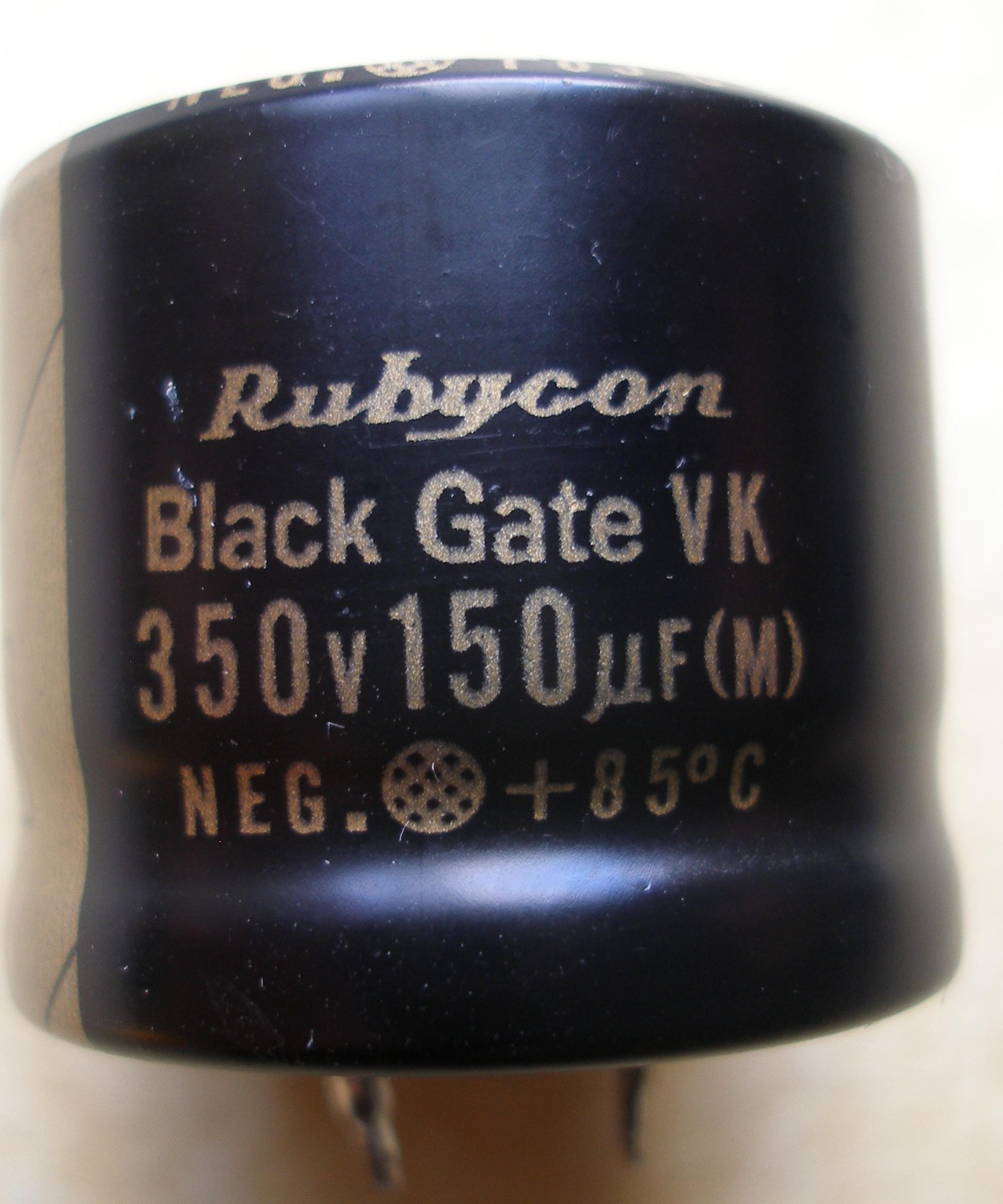

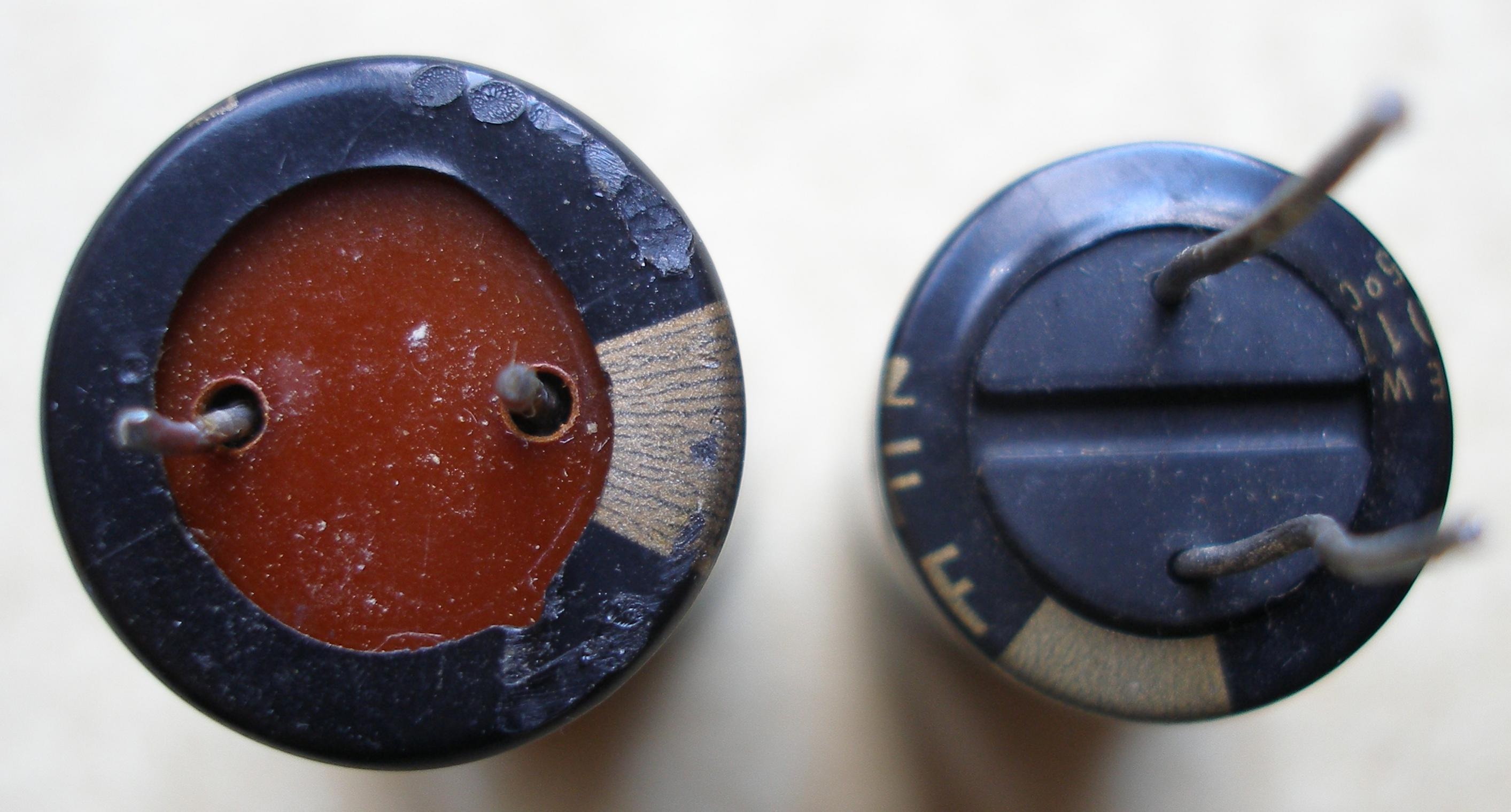

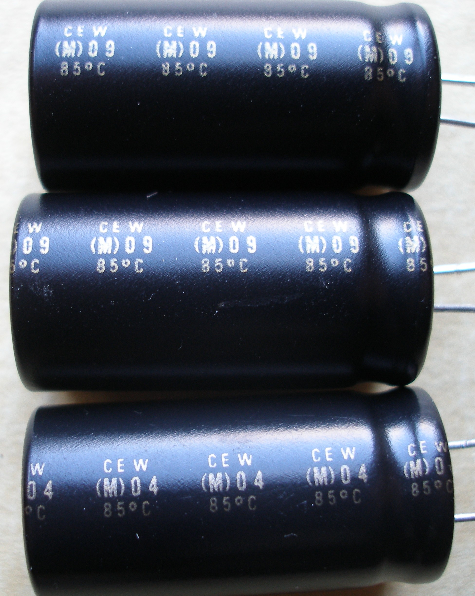

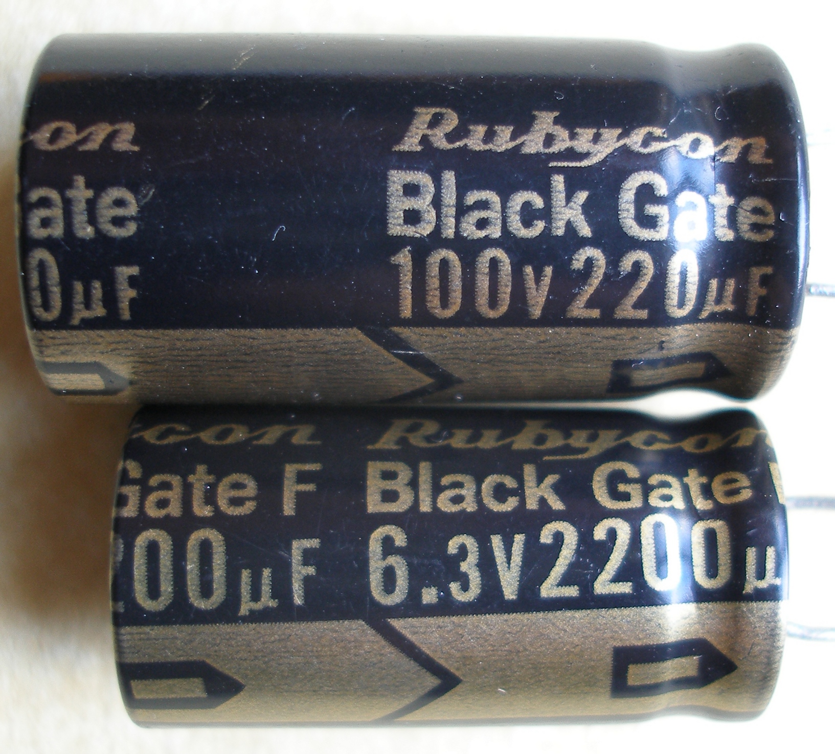

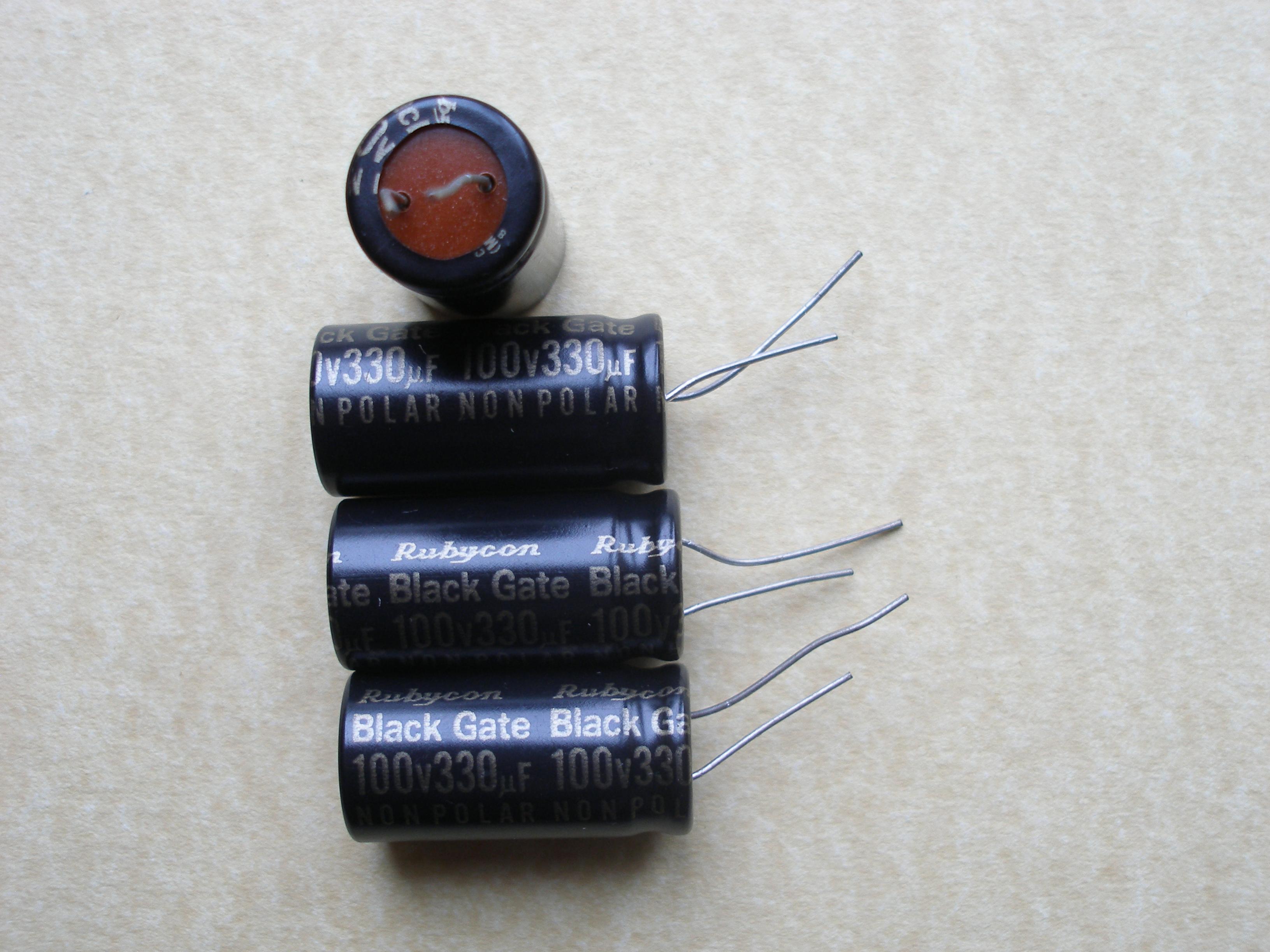

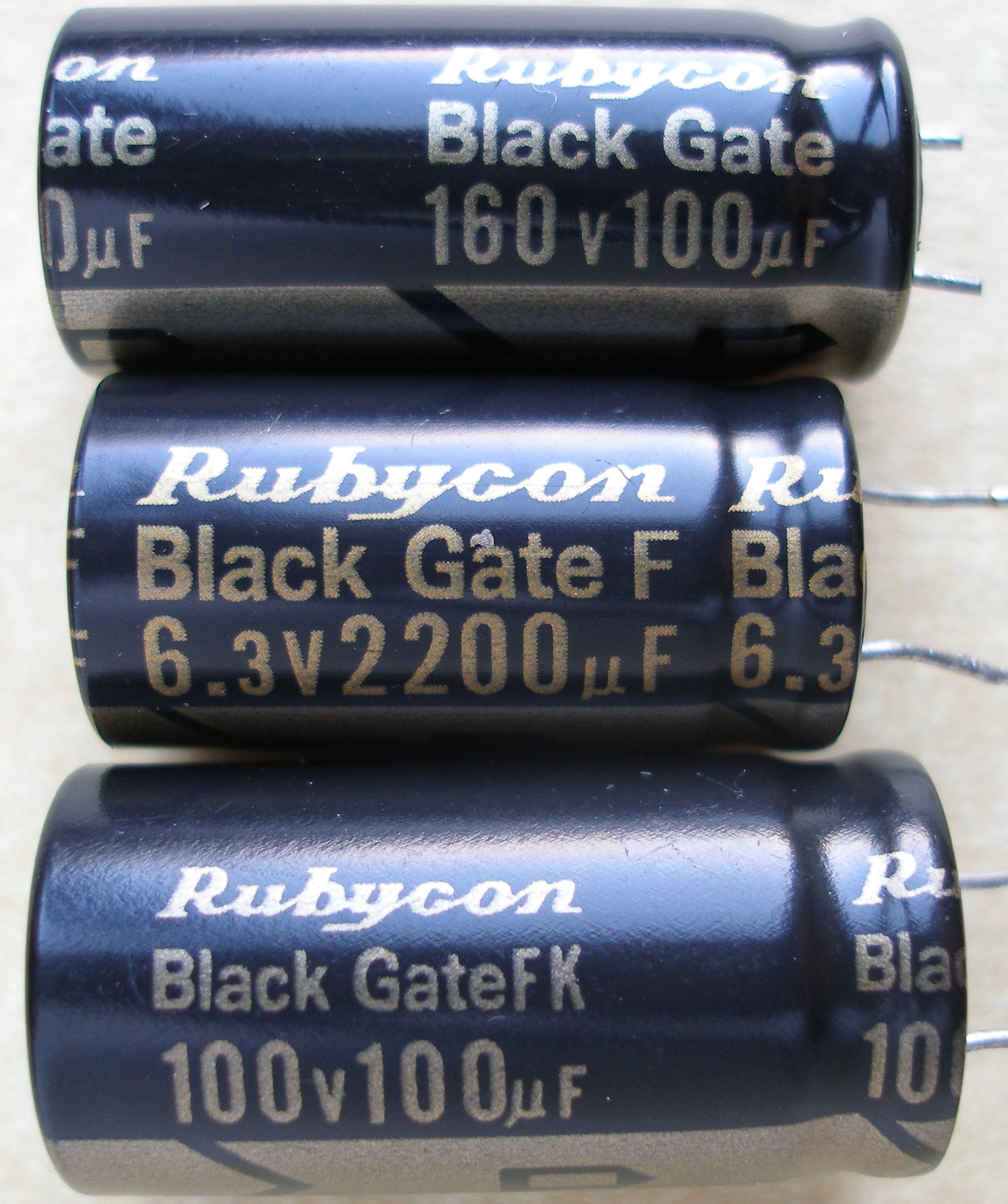

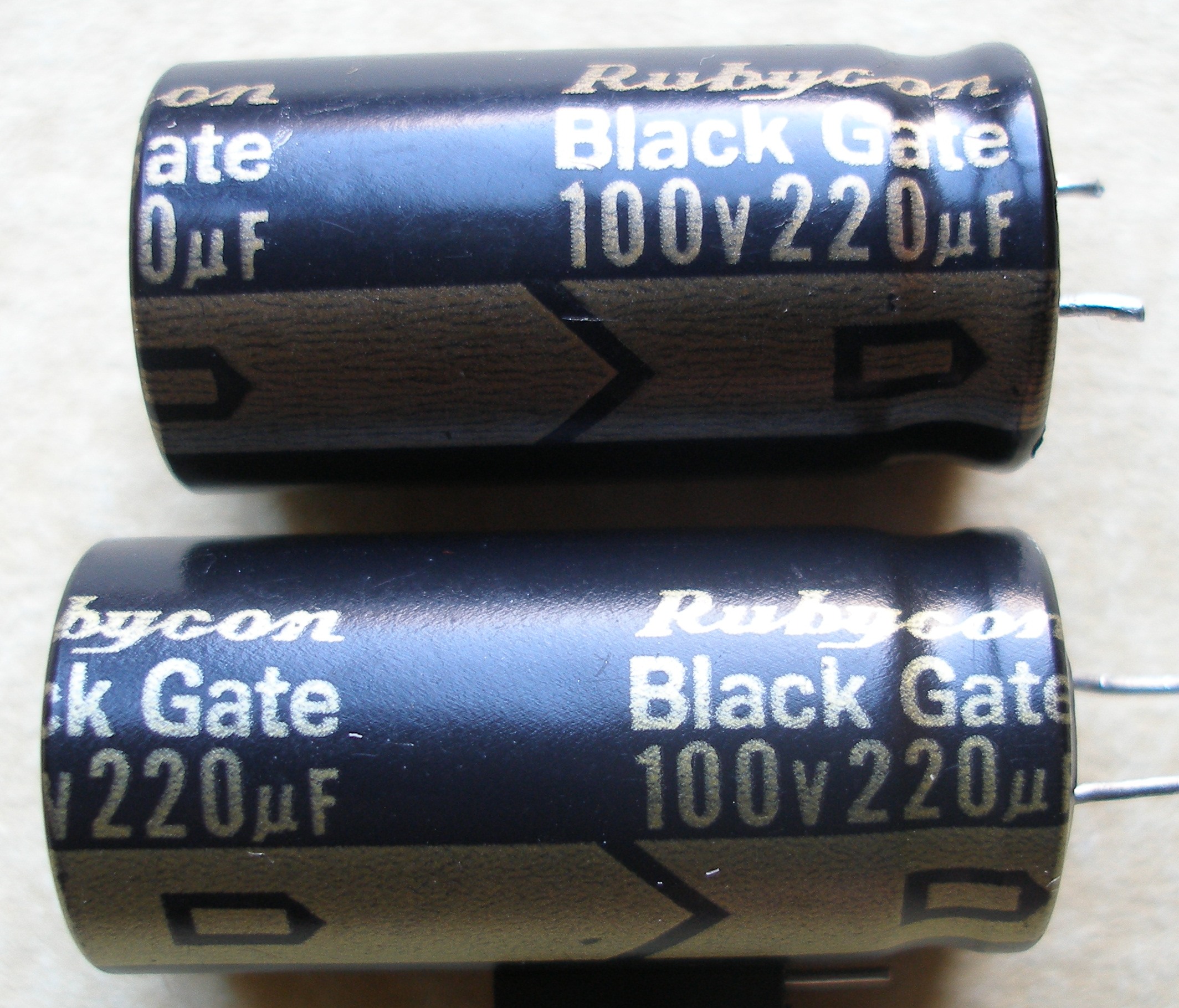

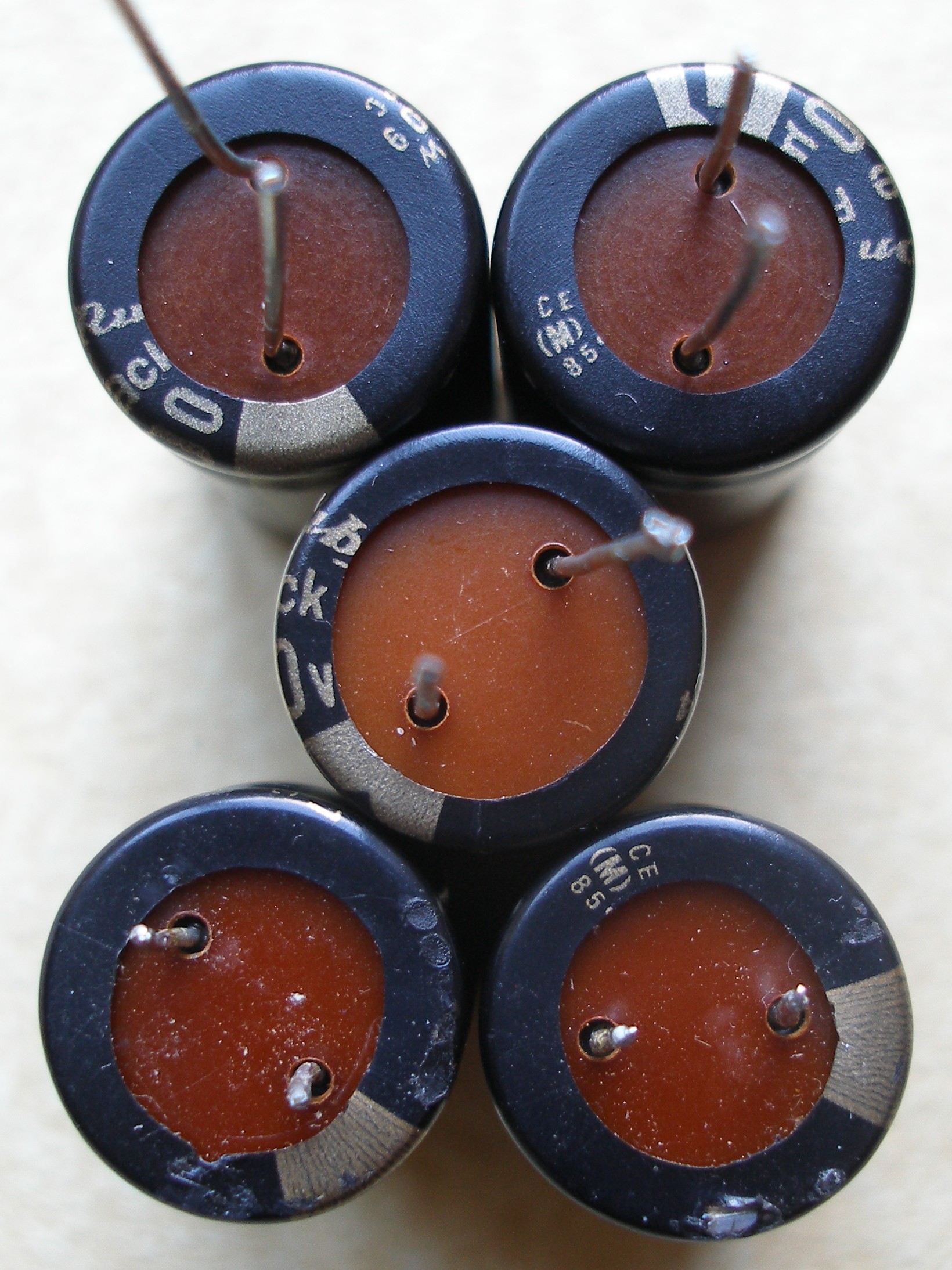

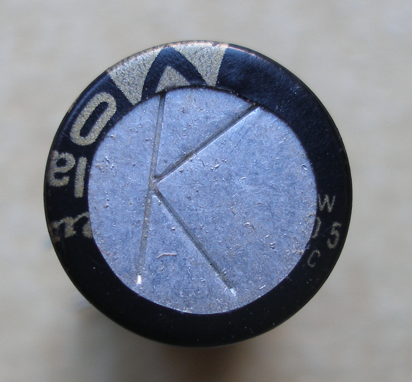

Some more photos below showing different print layouts. This info from a batch of around 35 new/used capacitors of various values. These were purchased more than ten years ago at a time when I wouldn't have thought it financially viable to fake them.
Generally "Rubycon" appears to be the same length as "Black Gate" but not always the case. See the 330uf 100v NP's and the 150uf 350v VK.
There appear to be two different fonts, one looking bolder than the other. Subtle, but there all the same. Difference in colouring as well, one brighter and "more gold" than the other although the photos may not show this very well. Don't think this would be down to natural fading or temperature effects.
Different case size for same value, 220uf 100v standard? Anybody else found this? Seems a little suspect to me!
All end caps the same, silver "K", except high voltage VK which has plain black plastic base.
Leads caps either orange/brown Tufnol style or grey/black, grooved rubber. The Tufnol caps vary in colour. Looking at photos of BG's on Google, I'm seeing mainly grooved grey/black style caps so are the Tufnol ones genuine?
Most values are within 3-10% tolerance, a couple around 11%.
Weights of caps don't seem to vary more than 1-3% between matching values.
Not sure if this info is of use to anyone but if people can have a look at their own stock, which they know to be genuine, then maybe it will help in a small way to identifying any possible fakes out there!
