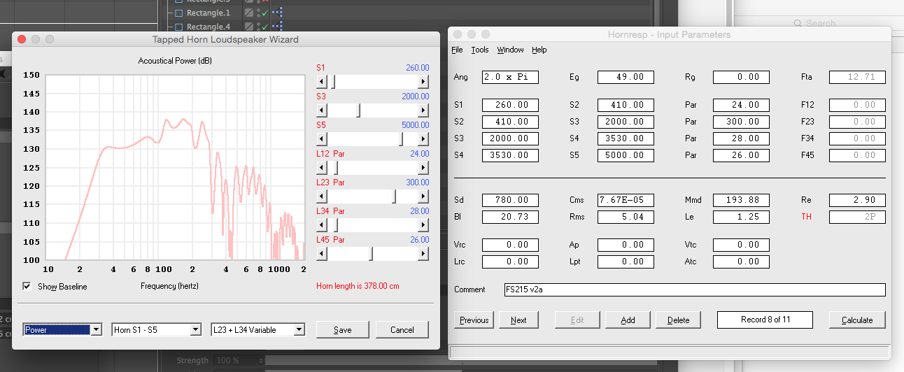

What do y'all know about mouth dimensions / specifically height to width ratio? I feel like a mouth that is generally more square is preferred? The fold above has a mouth about twice as wide as it is tall.
The 2:1 aspect ratio is not problematic, and since this just bass there's no problem with altered directivity. IMO the potential issue would be the volume in the cone added to the throat and the potential obstruction at the mouth.

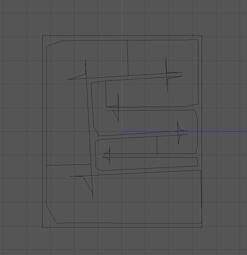

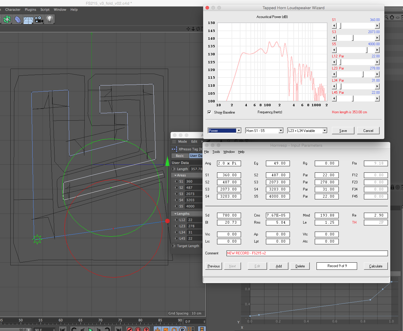

Another rough fold with a secondary expansion from S3-S5 to give more room for the driver
32h x 24w x 25d (each)

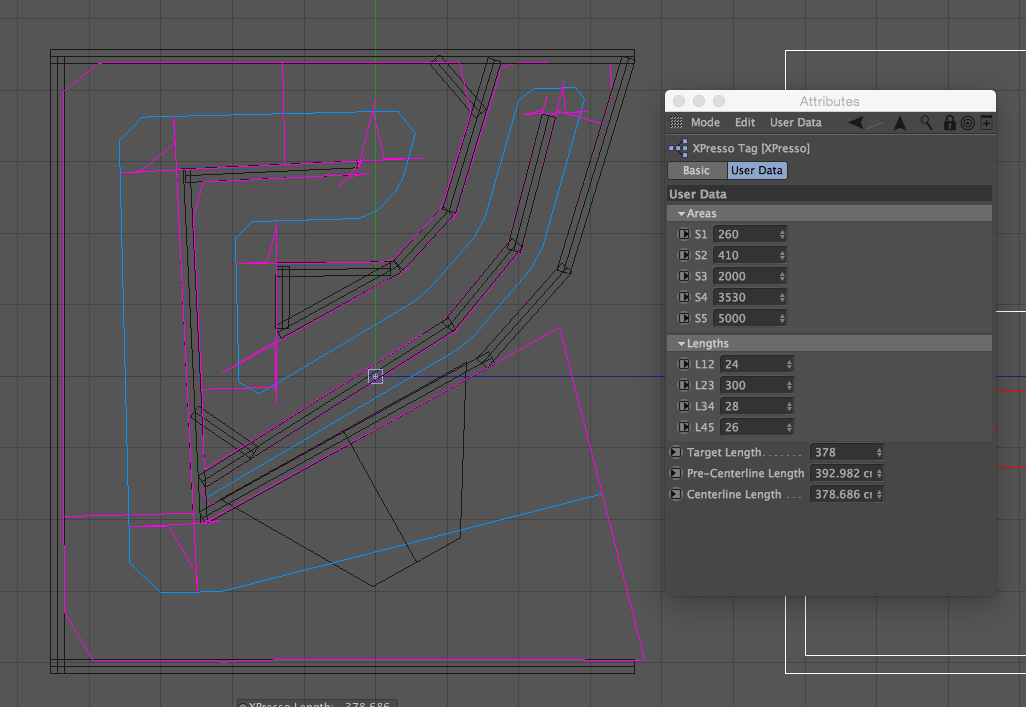

Looking pretty good. You'll get a better estimate of the actual path length using the "advanced centerline method". The more folds you have in your TH, the more inaccurate the centerline method will be.

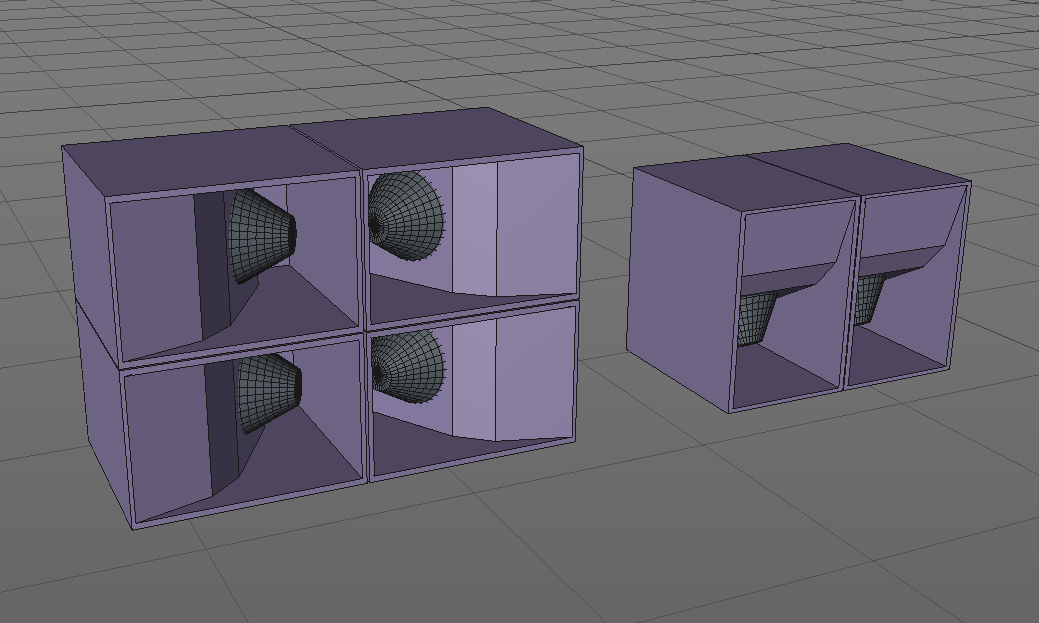

Disclaimer: I'm up for a challenging build, so please don't dissuade me on this idea because of build difficulty.
Okay here's my question..
The end of the horn has almost a scoop on the end. Not really sure how to sim this, or what it would do to the response.
