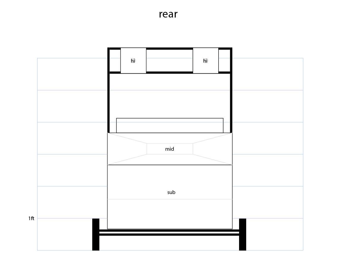

The other thing I am dealing with except for top-heaviness is height of the deck for DJ equipment. If I am going to do a dual 10" for midbass, the 10s have to be placed horizontally rather than vertically.. I have about 12" height to work with in the midbass cabinet.

Oh, it just clicked:
547434d1462493780t-faitalpro-15hp1060-vs-3015lf-tapped-horn-screen-shot-2016-05-05-5.05.49-pm.png
Bass bins at the bottom, midbass on top of it, and the tweeters up high.
You don't want the tweeters that far from the midbass; it's going to create some nightmarish comb filtering. I can understand why you're avoiding the Synergy route, it *would* make it top heavy.
If it were me, I'd ditch the tweeters up high and go with a two-way Synergy horn where the midbass horn is located now.
So it would still be a three-way, but the mids and the highs would be coherent and would have superior directivity, which is really nice with percussive music like EDM.

But then the highs would get lost in the first few people of the dance party in front?
The biggest use of it is when stopped, and the DJ is on the decks.
I could see the synergy horn working, only if it were telescopic and could be raised up when stopped, in the down position when traveling. That's actually what i did with the previous bicycle build shown in my previous post
Then I would have a lot of weight up top, or I could put it right above the sub but then if anyone stands up next to the sub to dance (which they will) then highs get lost into the person's belly 😉
I hope I'm not sounding argumentative here, I know I'm a bit of a Danley fanboy.
With conventional speakers, you *do* have that issue where something can block the high frequencies.
With a constant directivity horn, like the SH-50, the entire mouth of the horn is playing the high frequencies. So it's like having a full range driver that measures 30" x 30". You could literally stick your head in the mouth of the horn and it's not going to sound much different.
I had a pair of SH-50s playing in my living room one day, and our ten year old daughter was sitting a foot away from them. I had four speakers set up in the living room, and while I was playing music, our daughter pointed at the SH-50 and asked "is it on?" IE, she was a foot away from the thing and she couldn't tell that the sound was coming out of the speaker. That's the weird thing about CD horns; the sound doesn't come from one point in space, it's everywhere. (Hence "constant directivity.")

Interesting. No you don't sound argumentative at all. You just really love synergy horns 😀 Which is perfectly fine!
You are convincing me to give more thought to it, which is probably a good thing. I think a synergy mounted on a telescopic rack could be way awesome. I might just do that.
