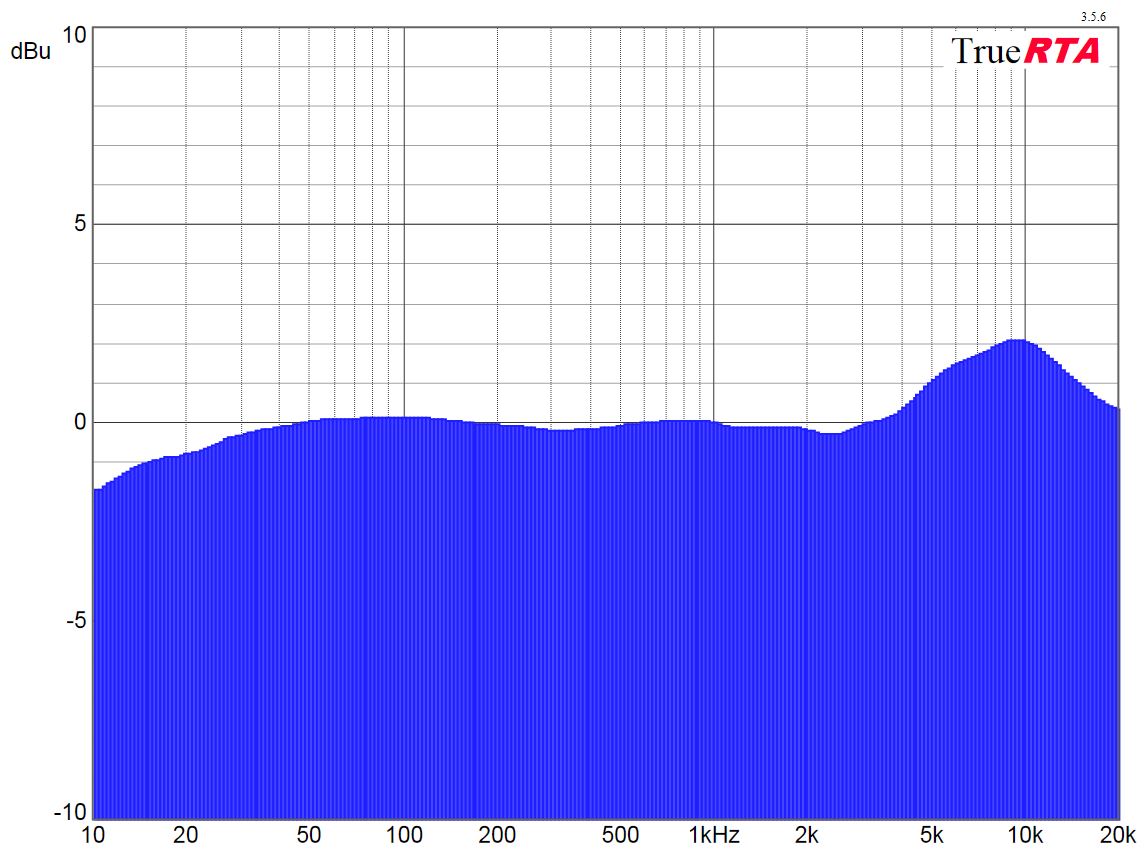

One year (a few years back) I won an EMM-6 that had the cal file to download (from PE) but was ALSO calibrated by CSL. The cal files did not match, not even closely. The CSL file had the standard looking (panni condenser mic capsule) curve that you've seen online. PE's had that weird "rhythm" of rises and falls in the upper octaves, which I'd have to conclude were bogus.

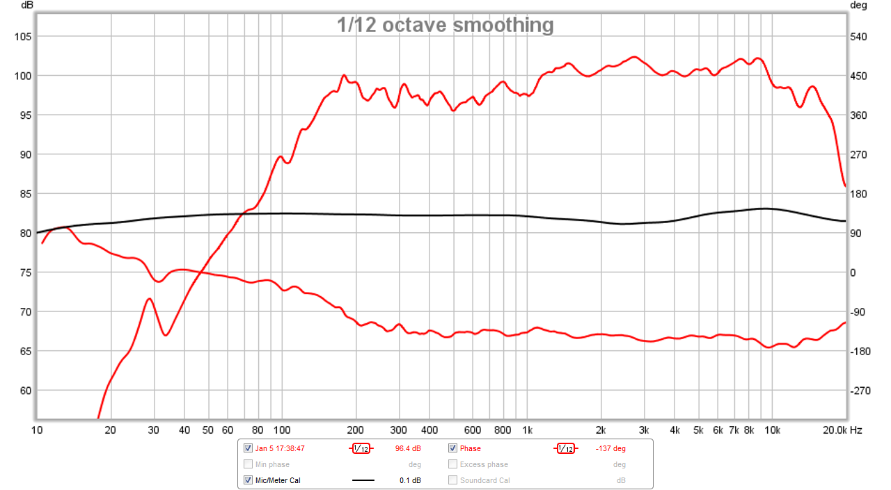

Here is an example of one of my measurements of the Nautaloss speaker with the UMM-6 showing the mic calibration correction curve. The cal file has about +/-1.1dB max corrections in the higher octaves. That is not going to change things that much.

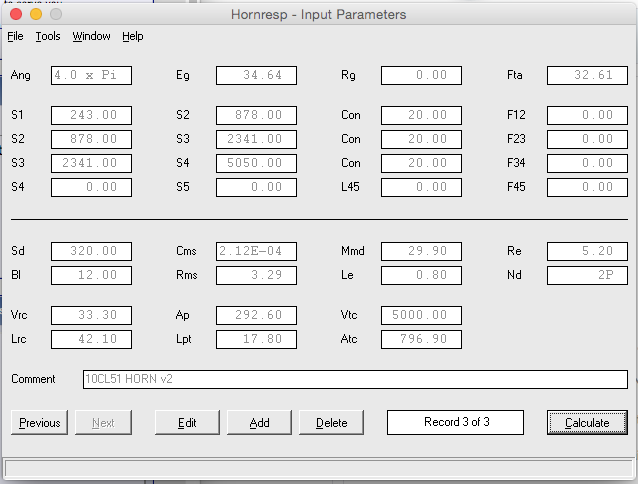

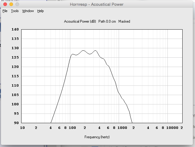

I spent the night simming a front loaded midbass with dual 10CL51's, nothing really that fancy but it's what I can handle for the moment 😉
Since my latest use for this sub is on a mobile bicycle trailer, I fear that a synergy horn mounted up high would need lots of structural support which would likely make it a bit top heavy, not good for going downhill around corners. I would ideally like to keep most of the weight closer to the ground.
Not opposed to the idea, though, maybe it could be mounted telescopically (lowered before transporting and raised up when stopped / dj active)
Here is what I have so far for a dual 10CL51 FLH midbass to match the 28-100hz FS215 and HF144 CD(s) I have. I am still tweaking, so [as always] please be my guest if you have suggestions. Right now I am thinking my throat chamber volume might be a bit too high and I'm loosing too much in the high frequencies. Was hoping that I can crossover somewhere in between 500-750hz to the HF144

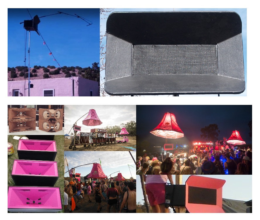

A bicycle-drawn Synergy horn? This sounds, um, interesting! (My other hobby is building bikes.)
I have one of those Harbor Freight DIY trailers, and I've daydreamed about making a mini-Caleb. Basically a scaled down version of the Danley Caleb. Only problem is I have absolutely no use for it! But it would be a fun project.
Ahhhhh thank you SO much for reminding me about the harbor freight trailers! It is absolutely the best solution... then I can tow it long distance with a car as well 😀

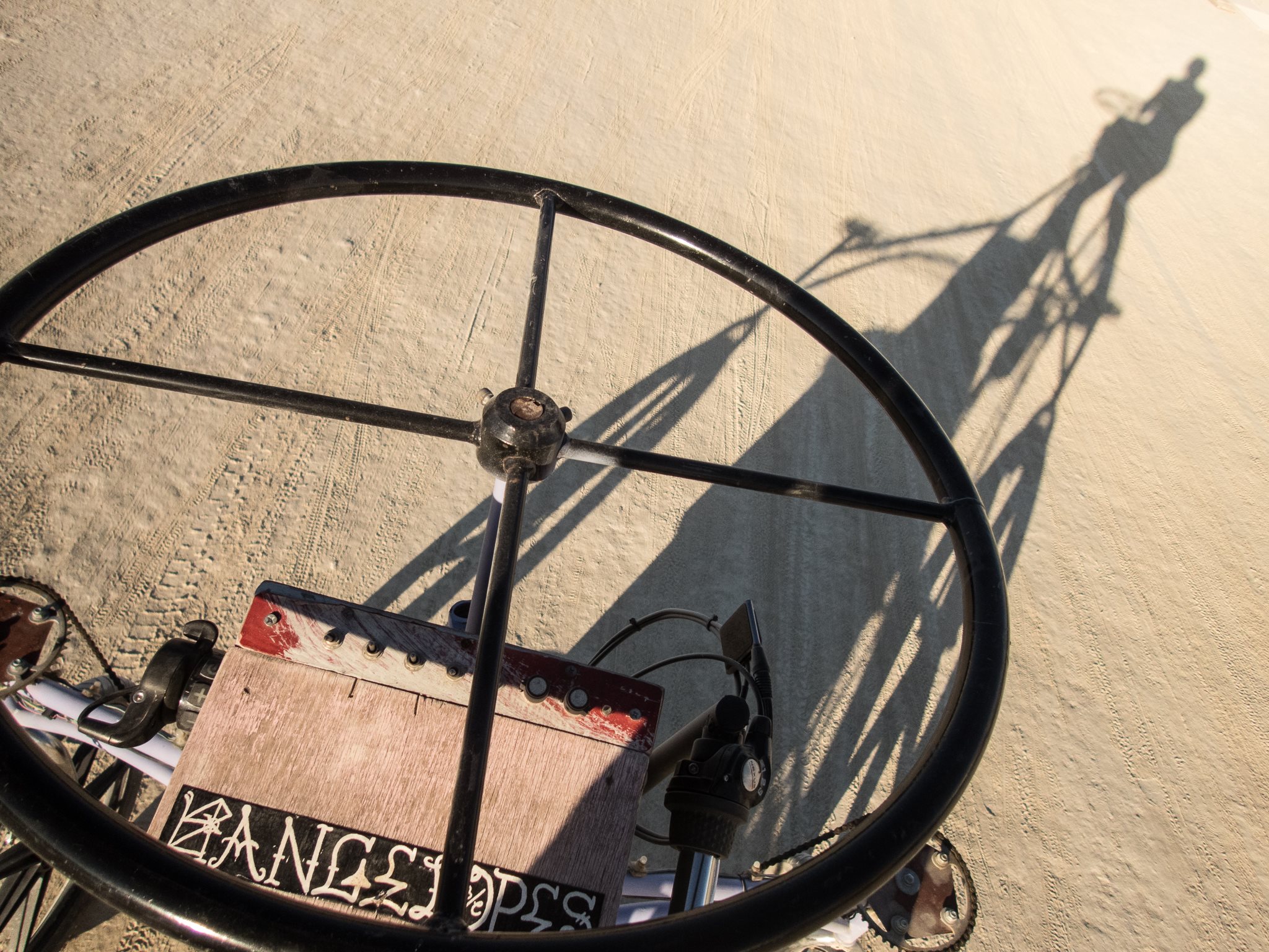

Well if you are into bikes, then this post is for you. Here is the bike that will be pulling the system. I welded most of it up a few years back, then made some improvements this past August... including a 36V 500W motor assist and extended cargo capacity to hold a 800W on board generator which continuously recharges the e-bike battery if needed. It already has a small tripath system with a couple of 4" FE126EN's in ported boxes, but it is simply not enough.
Anyone willing to look over my sim above? I am admittedly a little bit rusty in hornresp. It has been a while 😉
