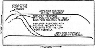

It's called "motor-boating", and is the result of the phase shift of the
transformer response at low frequencies. The cure is less positive feedback.
A nice reviewer for Stereophile sent me a copy of the 1957 article about
PCF, where they discuss this issue. They experienced a bump in the response
and potential instability (motor-boating) as they increased the pcf figure.
I don't recall them mentioning the cause, but it being 1957 it's a safe bet
that it was from the output transformer of the amplifier.
As noted previously, the other thing that can cause this problem in an amplifier
where a transformer used to process negative feedback is a high impedance
DC source - the amplifier wants to be DC coupled to some impedance.
In the F6 the input Fet buffer takes care of that.
Here is a curve from the article:
