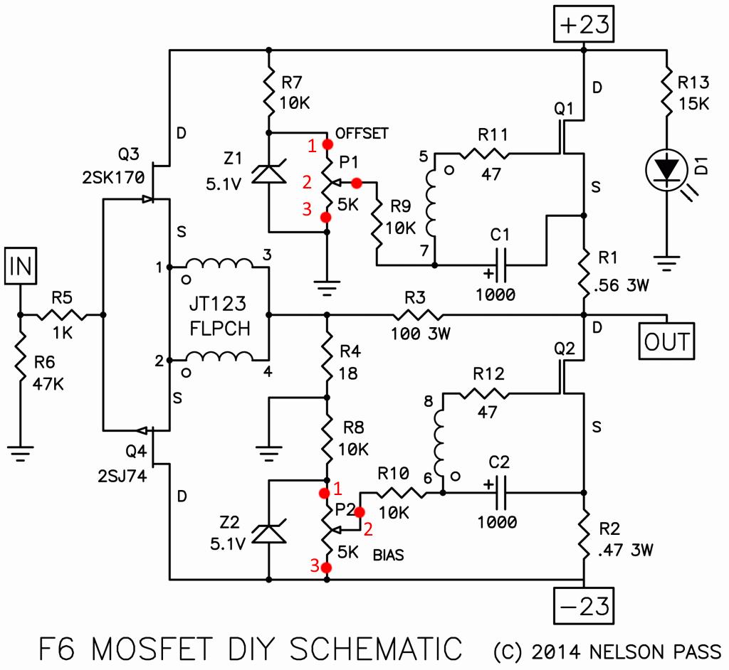

Imagine we mesuring resistance in two points 1 and 2.
Pot is 5K, so which resistance must be at OFFSET and BIAS pot, when we start amplifer first time?

Moving 2 closer to 1 increases voltage at gate relative to source thus increasing current, moving 2 to 3 decreases it.
So set them at 3 during startup and you'll be fine. Another note though is that the 5.1V zeners are low enough that even if you start them at 1 they won't conduct that much current anyway so as long as you don't let them simmer for a long time you should be fine.
one DVM across R1 or R2 , to measure Iq
second DVM from Out to GND , to measure output DC offset
start with both pots on minimum ( short between wiper and lower pin) , iteratively, few turns one then other
soon you'll get which one is for you setting Iq and which one DC ..... fact is that both are adjusting both values 🙂

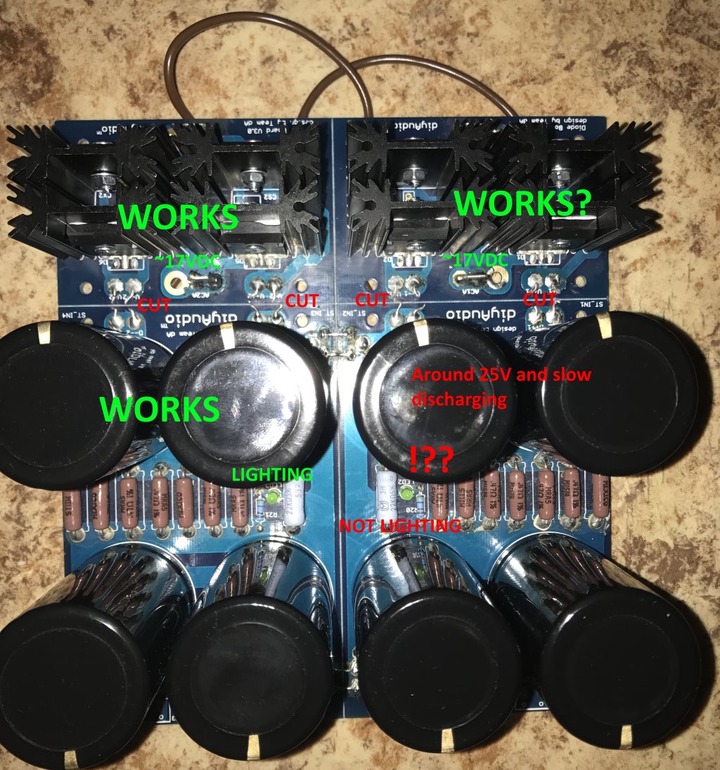

One part of my bi-polar PSU not working, and i have no idea why.
Only one LED indicates that left PSU part working, also ... i see small smoke from one of diodes... and immedately turn off amplifer. What a $%()% 😡
I cut diode bridges from capacitors filter PCB and trying to swap diode bridge from working (left on picture) part to right part of PSU, but it did not help!
Also each capacitor PSU charged around 25VDC and slowly discharge, so probably no short circut inside capacitors or on PCB.
Also diode bridges when separated also working too without any issues.
Also each capacitor PCB when charged have enough power to light 36V 60W bulb for around 2 seconds...
Very strange behavour, can someone help with this!?

check for shorts , there is no other explanation
orientation of parts ?

When i charge for 1 second left and right capacitor bank (PCB) they have much power to light 36V 60W light bulb for around 2 seconds, so probably no short circut.
Careful not to short any of your mounting washers to the rail pads.
I did this once and got the same symptoms you have.
If you have mounting washers top and bottom of pcb be careful that none of them are touching any of the rail pads (shorting to earth)
If you are shorting only one rail it will still light up bulb.
well , you reprted that you have problem
try to be systematic , and use bulb tester
is diode bridge functional ?
is cap bank functional ( no shorts - check with buzzer on your DMM) ?
is everything oriented as prescribed ?
something is wrong ...... and as long pcbs are at your bench , only you can find where is the culprit

Which problem may be if after diode bridge i get only 17VDC (must be AC*1.414=25.45V) and on transformer secondary 18VAC. Also i try diode bridges from Vishay and remove thermistor, but voltage after diode bridge still remains 17VDC😕
there will not be 1.41 without caps

check diodes with diode test , check caps for shorts
connect them together , power up via bulb tester
report here

I make an research, i make following decision - short in one or more caps.
Caps probably arrive damaged, because diode bridge functioning normally and everything is soldered correctly.
Also one of wire from diode bridge (600V 35A Vishay) moves when i turn on amplifer, that's because MUCH use of current - short.
