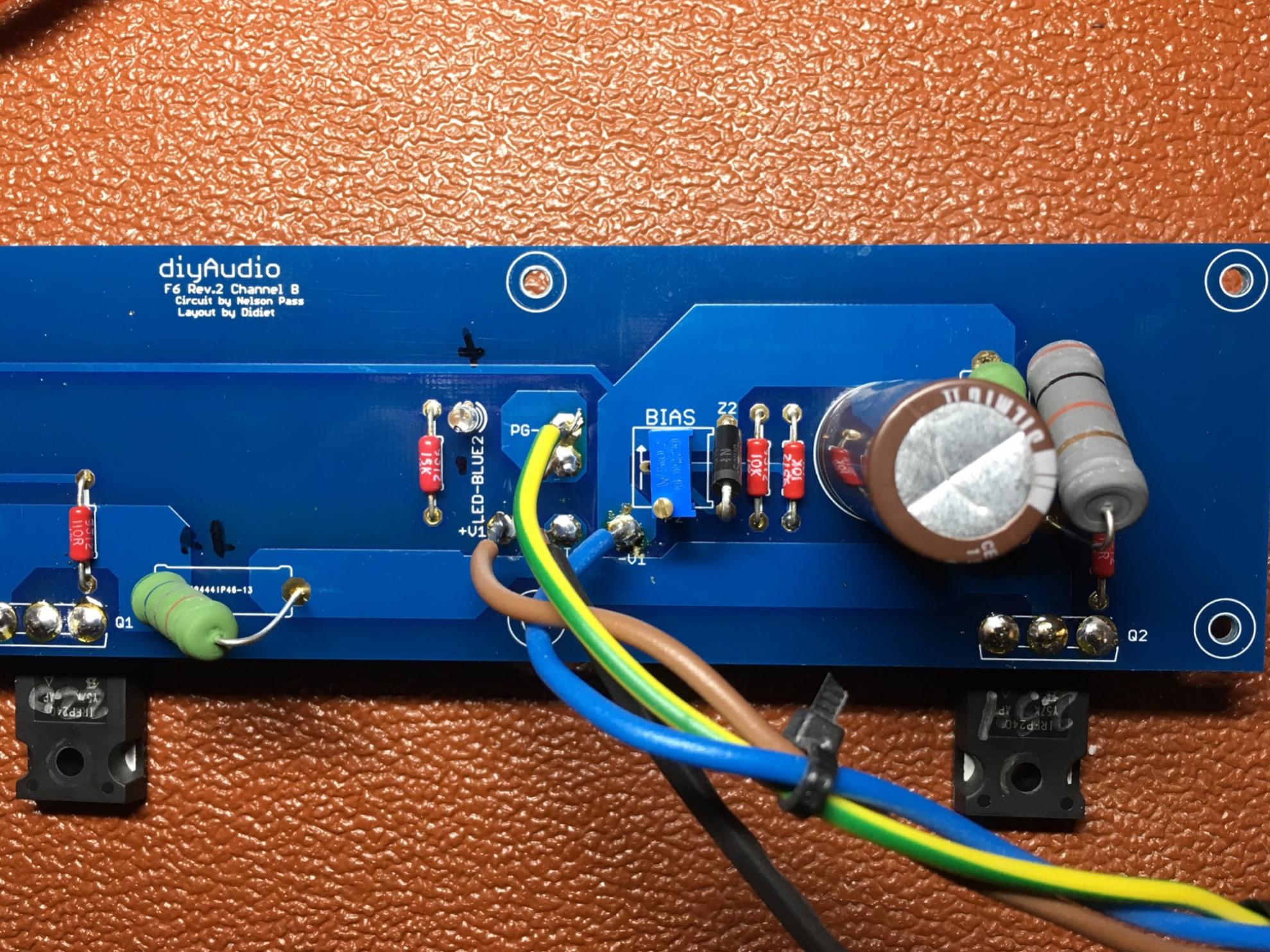

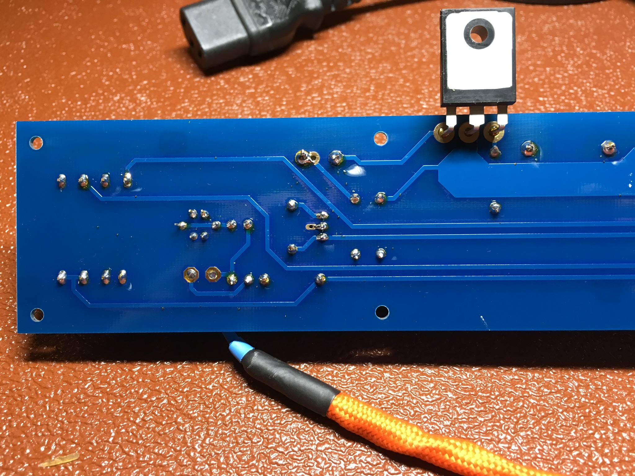

Diagnostic Pics
I’ve attached some pics. Let me know if they aren’t clear enough. I have more, I didn’t want to swamp the thread with pics.
6L6, thanks in particular to you. Without your guide(s) this would just be a dream.
Al
Al
Al,
Have you tried to turn down the bias on channel B with the tester in place? It's unlikely you'll hurt anything with it (bulb) connected.
Re-attach the board to the sinks and give it a go. If the bias pot does react properly (I.E., you can get the bulb to dim) than attempt to bias to about 1/4 of the suggested ammount and adjust DC offset to zero. Then remove bulb and measure

With tester in place, bias appears to read zero (Measuring across the legs of R2 - the green one just to the right of the cap in the first pic) and P2 does not seem to have any effect - no voltage or dimming of the limiter bulb.
There is a hot dust smell, but I can’t locate any hot spot/components.
Hmmmmm. Ok, that's not right.
Look for poor solder joints, make sure your power connections are 100% proper, and doublecheck that you have no crumbs of metal in the Mosfet insulators.
Result!
Heated all the joints up again with a hot iron. Sorted. Must have had a duff joint despite them all looking right.

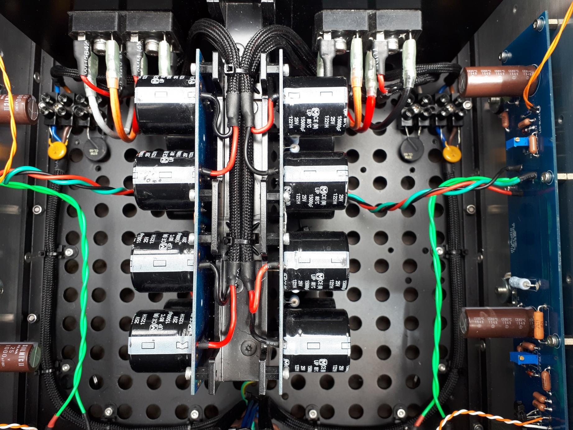

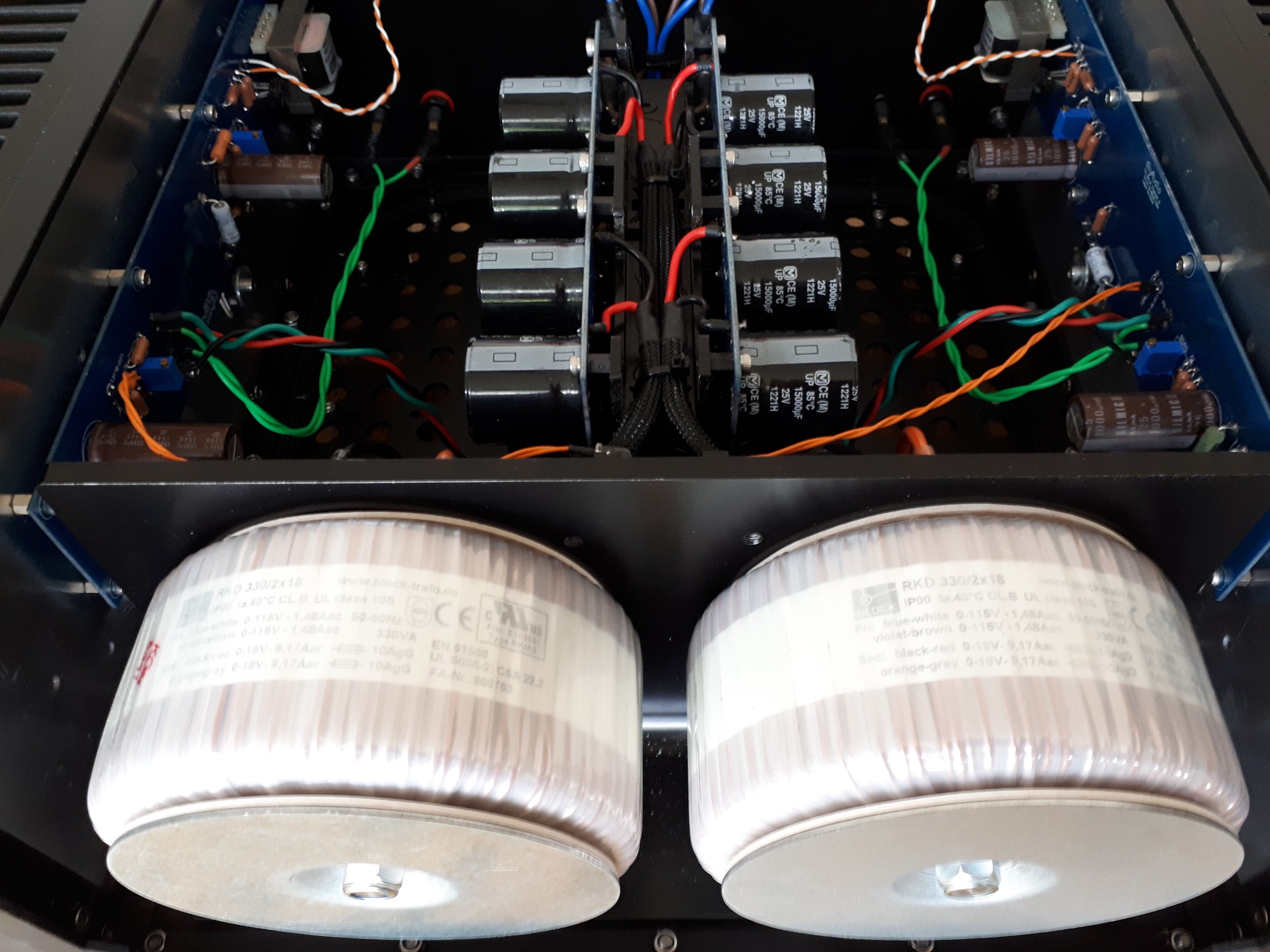

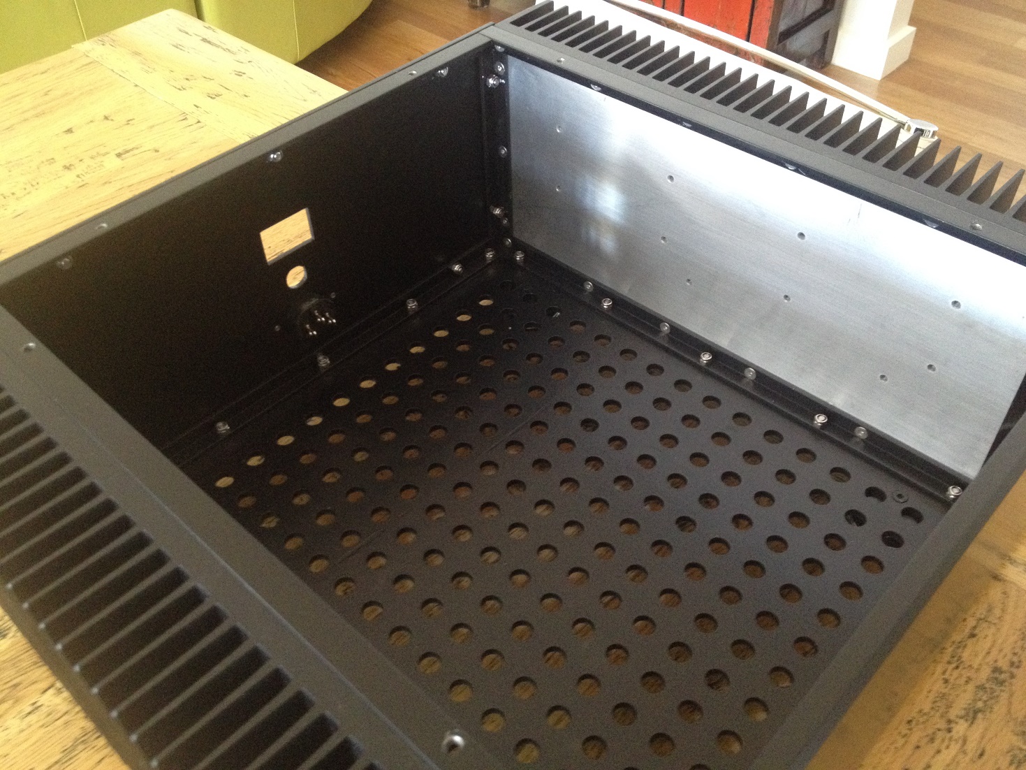

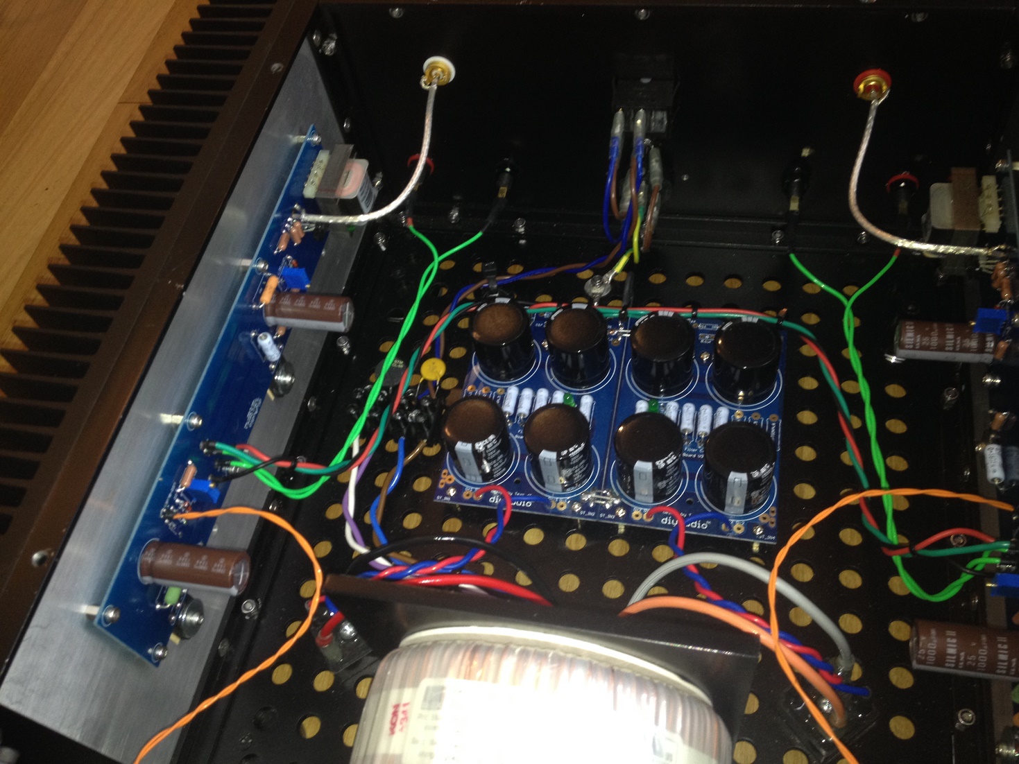

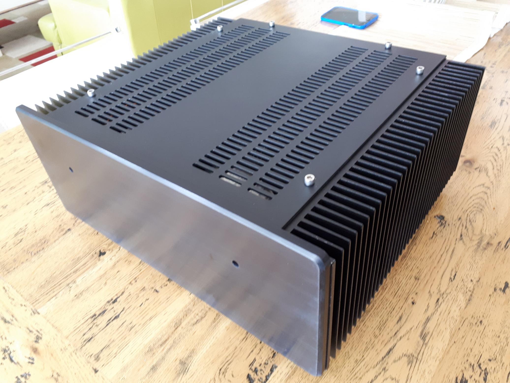

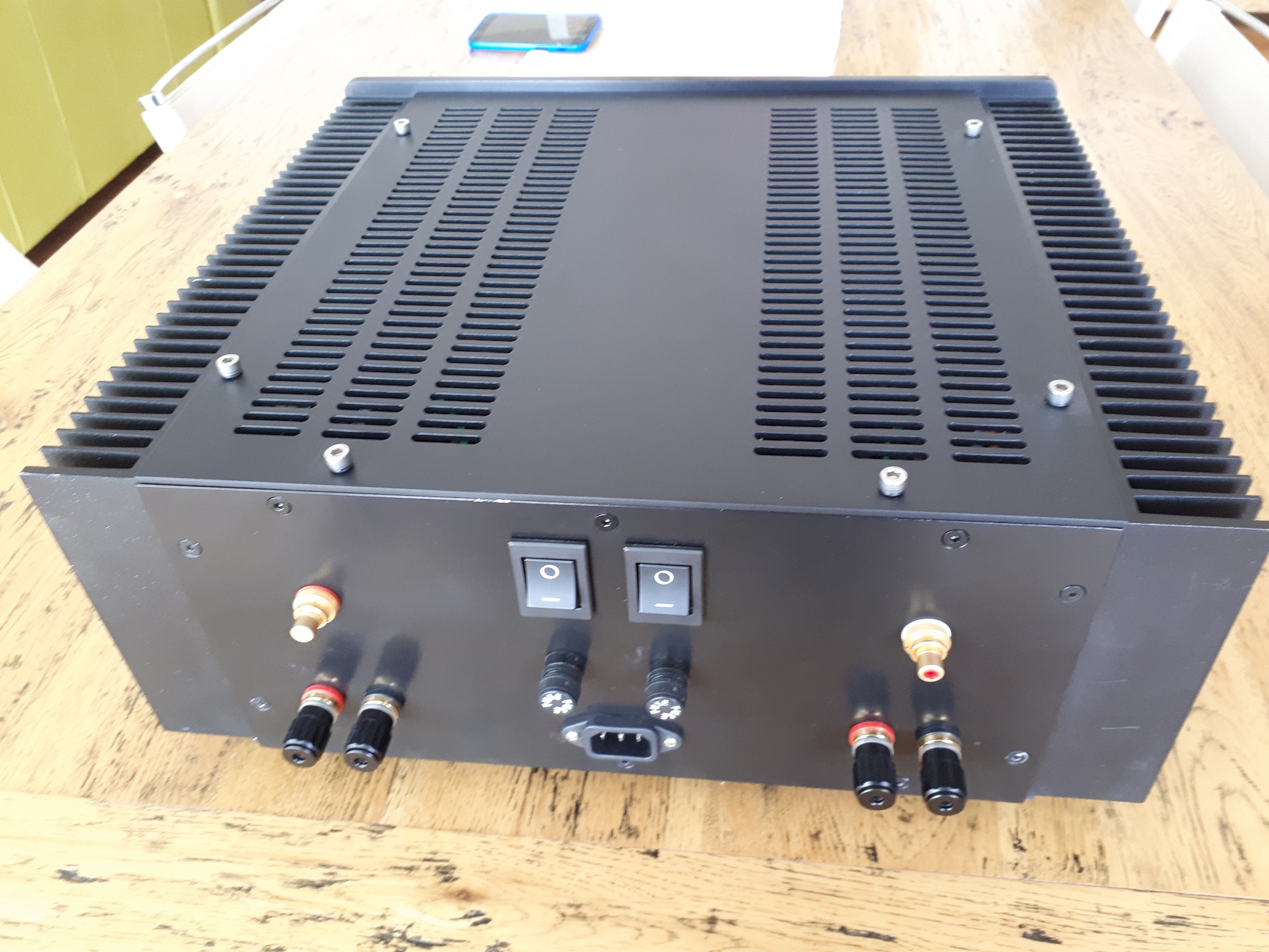

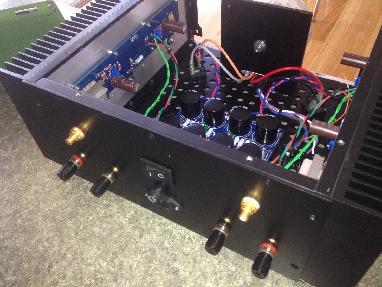

Another F6 Completed
This is my first post (ever), and the F6 is my first DIY amplifier apart from a Bottlehead Crack some years ago. I would not have attempted this build without the clear instructions and pictures in this excellent guide. Manythanks to 6L6.
It all went exactly to plan. I used 5.6v Zeners and changed R7/8to 4.7K. Everything else is as per this guide. It must be said that having an assembly of unfamiliar parts come to life for the first time after tentatively adjusting some voltages, was a thrill not experienced since my youth (a verylong time ago), and happily, all without injury or release of magic smoke.
Some pictures are attached (Ihope) for proof of build. Chassis is mine, all aluminium, using Conradheatsinks. I went to a bit of effort to make it as integral as possible to increase thermal mass and surface area without increasing chassis size. Seems to work well with bias set at .59v
The build had a standard PSU at first because I was not game to deviate from basic instructions.
But I have since made it dual mono in preparation to try the F4 amp (yup, it’s true, you just can’t build oneof these things once you start). In fact I have just completed the BA3 pre-ampwhile waiting for the F4 parts to arrive (very bitten by this bug).
Thanks to Nelson Pass for sharing his art, to 6L6 for his work onthese guides and to ZM for his knowledge and humour along the way, and to allthose who contribute to this great DIY site.
