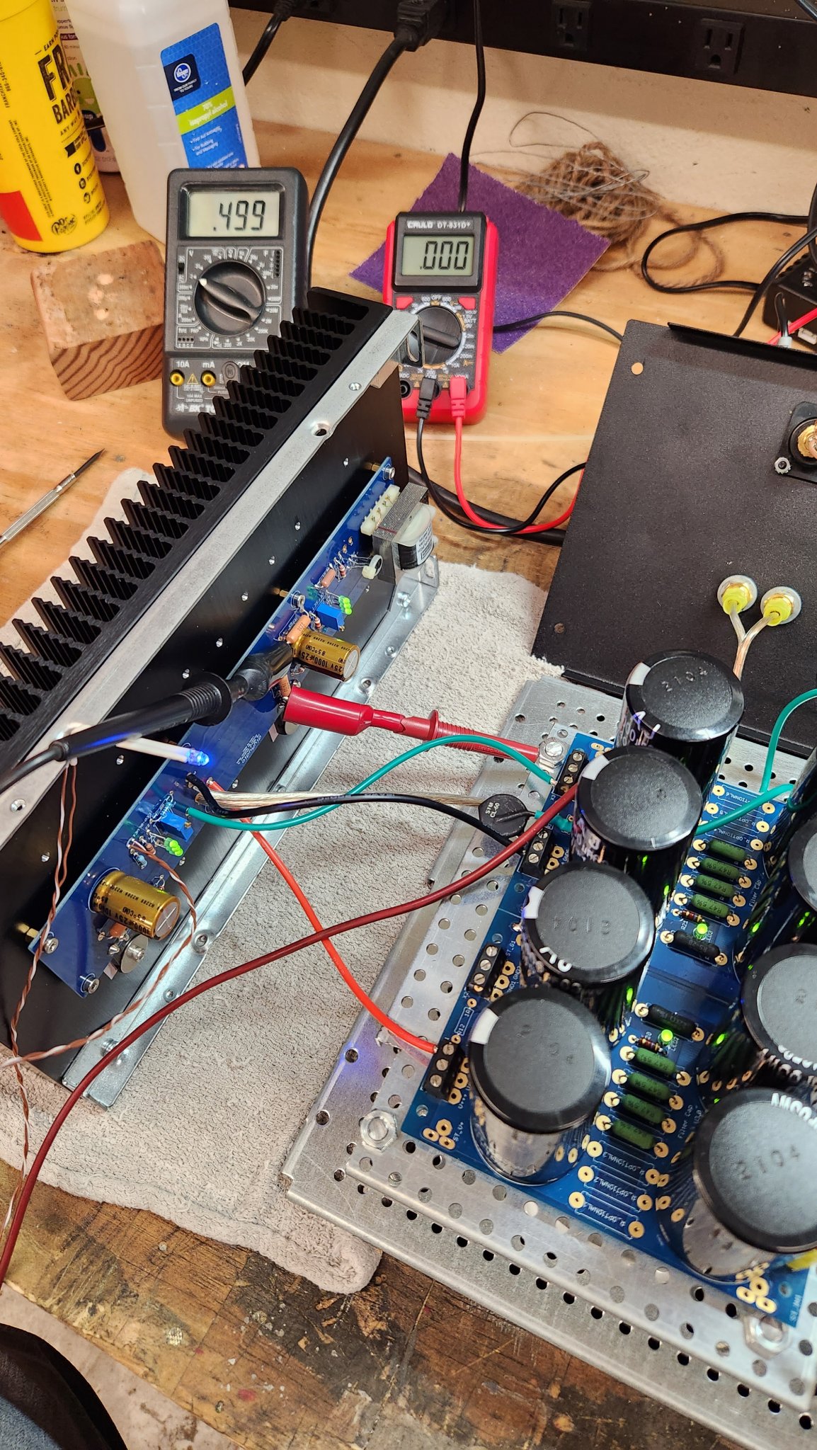

Thanks for explaining which PCB is with LED on negative. This is my case. Thanks a lot. Will go to check it. Interesting why there is not polarity labeling on PCB for LED… it will make life so much easier for newbies like meHi Nicholas -
As Dennis pointed out, yes. One LED is on the negative rail. The PCBs are not exact mirror images. The one with the LED on the negative rail is the one where R2 is not labeled and is placed 'above' C2. Hope that helps.
If the PCB is still unmounted, hold it up to a strong light and follow the traces. "Illuminating!" to make a pun.
As others have pointed out, the boards aren't mirrored and the rails flip between them. Seeing where the ground traces are helps learn the layout and how it matches to the schematic.

I turned the polarity of that misleading LED and have just finished setting up F6 and made some listenings with test speakers. Everything went smoothly. Good temperatures on MOSFETs, BIAS set up to 600 mV (+- 1 mV or less), about 0,0 mV offset (+- 0,5 mV or less) on both channels. By the way, is 60* C ok for Jfets? Haven’t seen any info about them, only about MOSFETs.
It seems to be, that everything is good. Very glad about that! Thank you Dennis and 6sX7 for your help with that LED.

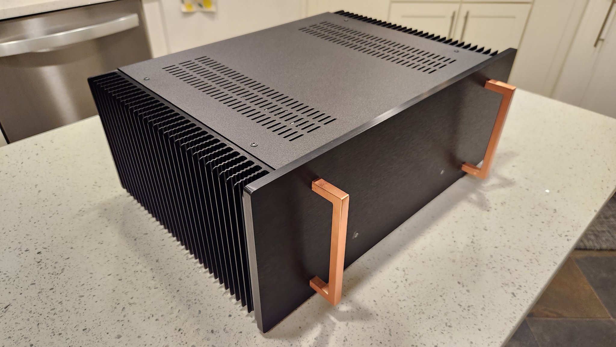

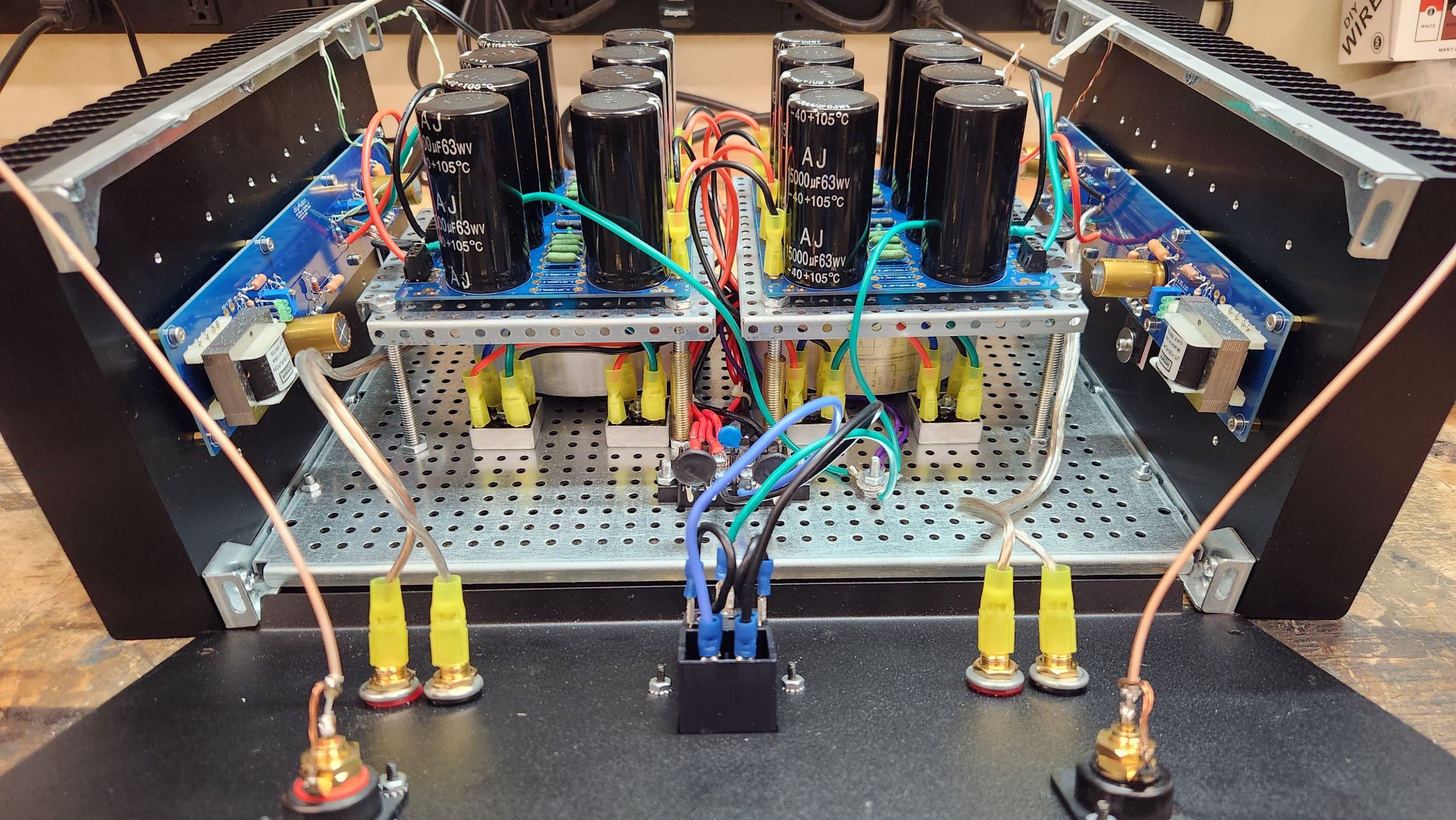

Deluxe 4U case, PSU boards, amplifier boards with transformers and transistors all sourced from the store. Antek 150VA power transformers. Filter caps from Apex Jr and most everything else from Mouser. I built this amp stock save for the picomods and dual mono power supplies. Currently biased at 550mv. I found nothing tricky at all to implement the dual mono configuration; each PSU drives its own channel with each PSU board grounded through its own CL60 to the single star ground. This power supply configuration allows short wiring runs but due to my stacked PSU getting to the bias adjustments is tricky. I left the wires to all panels long so I may remove any heatsink or panel without disconnecting any wiring. Final biasing had the case stacked together like a house of cards; only bolting it together once that was complete Absolutely zero hum with no extra shielding on input transformer or twisted wiring needed. Build it as described by 6L6 and it will be dead quiet. Entire build was straightforward with no surprises save some trepidation during biasing until the meters started showing activity (I started with all pots at their middle range). Once I started getting readings I found everything to be quite linear and the absolute final adjustments were made after cooking it for an hour between each adjustment.

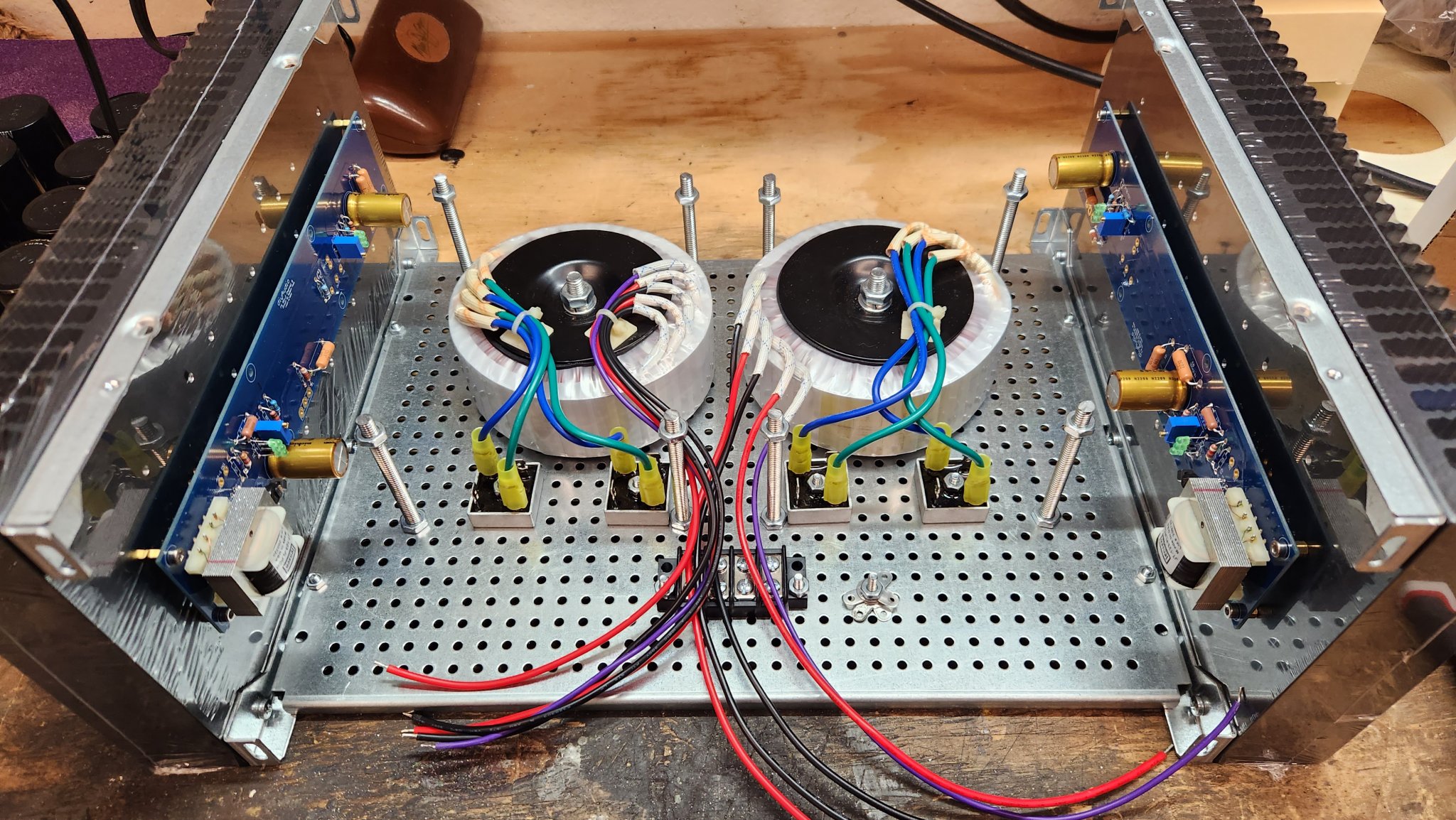

Layout of transformers and rectifier bridges. The transformer on right does not yet have all its wires dressed; finished state will be as the left side. You can see the all thread standoffs in place that will support the PSU boards above the transformers. Heatsinks and amplifier boards only mocked up here; heat shrink is still in place to protect from scratches.

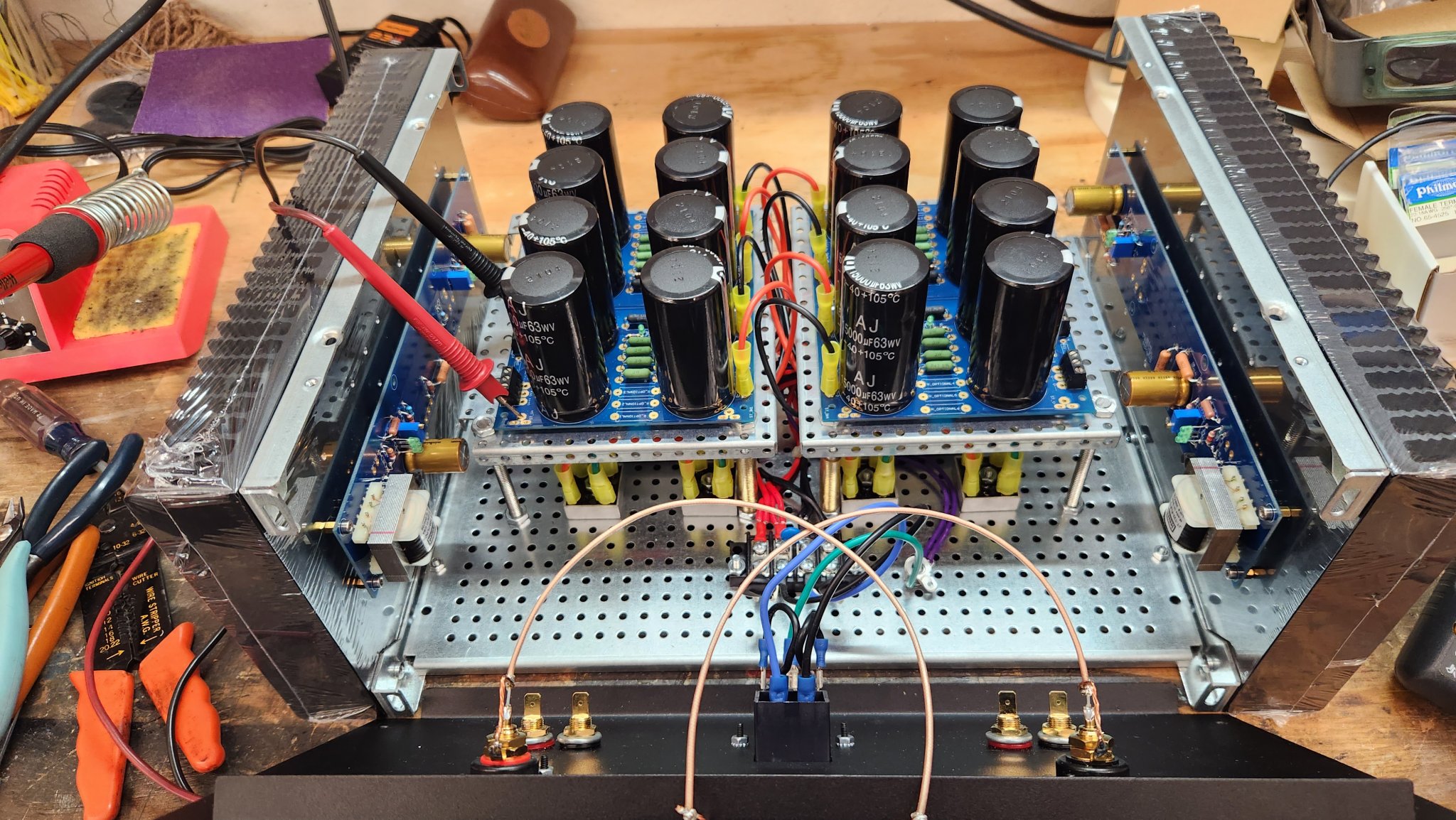

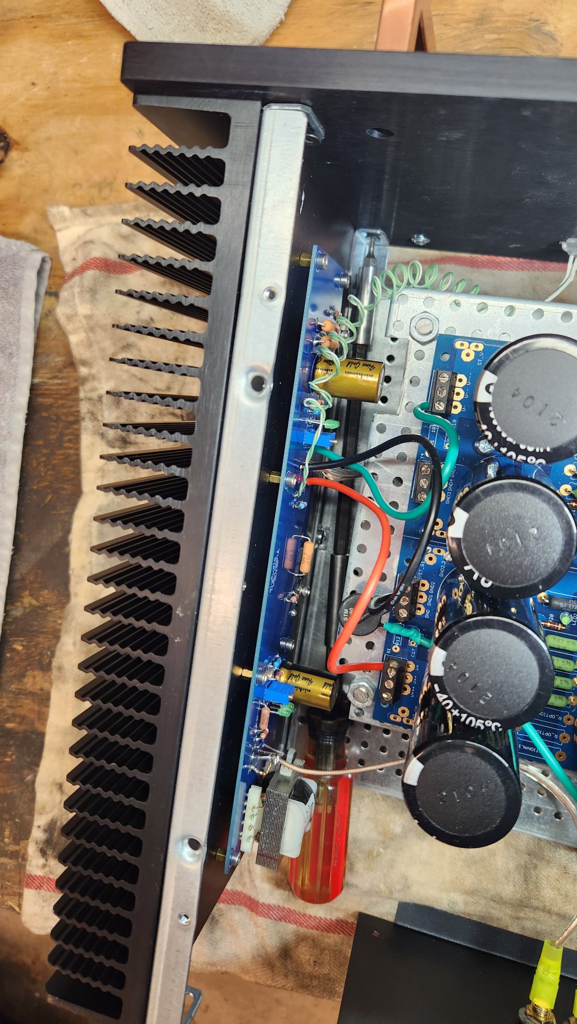

All PSU wiring completed and being tested. PSU boards mounted in place to standoffs using riser panels from the store. I wished to mount the PSU boards using the holes between the filer caps and therefore could not use a simple standoff as the transformers would be in the way. The riser panels mount to the all thread standoffs, and the PSU boards than mount to the riser with wiring from the rectifiers coming up through the the middle. Notice that the riser panels are notched to clear the caps on the amp boards and how access to the bias and offset pots is not convenient. Wiring of IEC terminal and power transformers is as all other Firstwatt amps with two CL60 to limit inrush and a safety cap across the line voltage. Difficult to make out in the picture but the standoffs nearest the line voltage terminal block each have pieces of neoprene tubing slid over them as extra insurance against abrading the power wires.

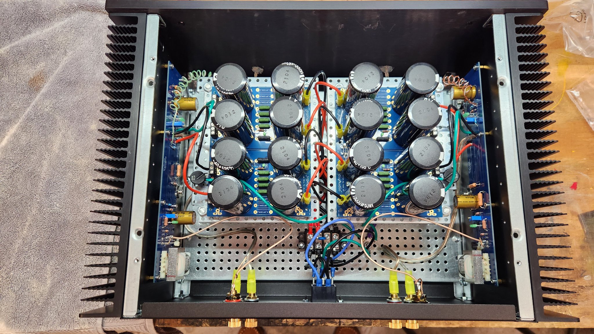

Completed wiring. You can make out the CL60 for ground on each PSU board. The green wire from each heads to the star ground where the IEC ground and transformer static shields are also connected. Shielded coax for signal inputs; it and the line voltage input wiring again left long so the back panel can be unbolted and laid flat if desired.
Initial biasing in progress before stacking the case together to "cook" for an hour. Final setting was 550mV with 0V offset.
How I was able to easily mount the front panel. Notice nut driver with extension and allen bit attached. This made what would have been a tedious operation a breeze by zipping all four screws right in! Also a good shot of final wiring. Coiled twisted pair goes to LED indicator in face plate. Also a good shot showing notches in riser panel to clear caps on amp board.
Time to solder the input coax to the amp boards and close up rear panel.

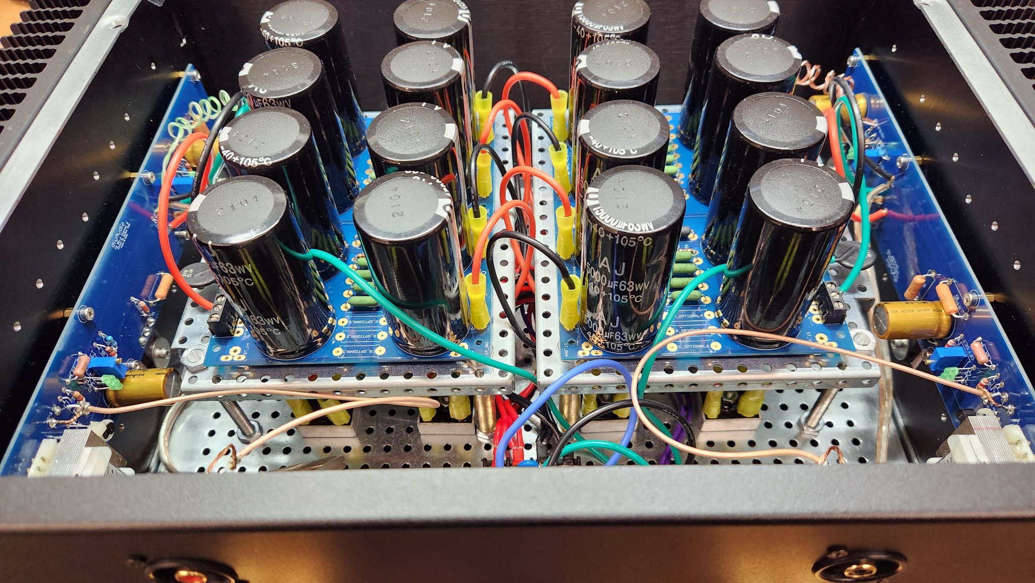

Good overall internal shot. There's about 1/4" clearance between the filter caps and top cover when fitted.

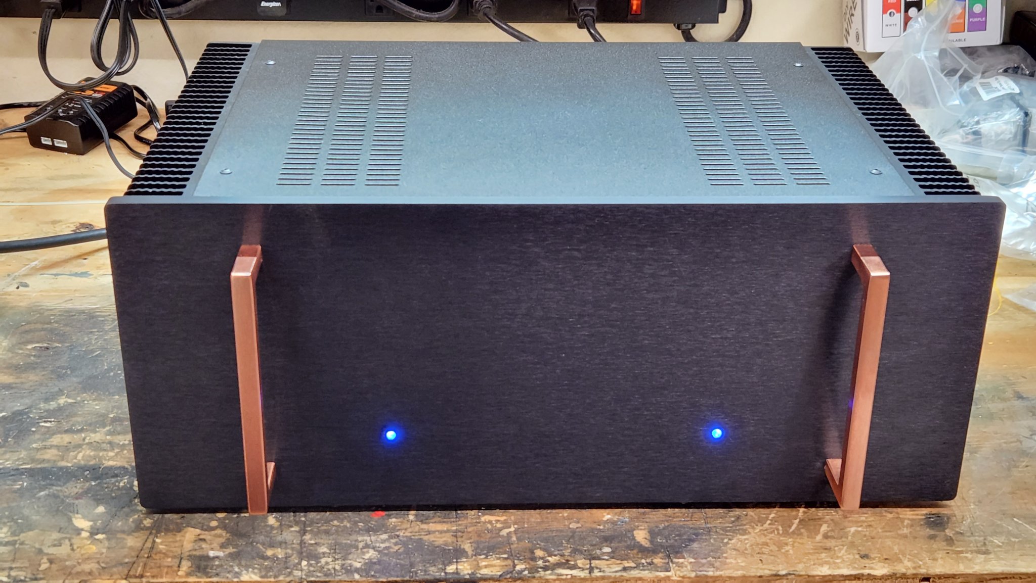

Big sexy beast at just over 40 pounds! Handles are rose gold kitchen cabinet pieces from Amazon. LED displays are holes drilled through front panel and then filled with hot glue. LED's are then hot glued onto back of faceplate so glue acts as a diffusor. Only thing I will change at this point is to up the resistance to the display LED's as I find this too bright. I may add an additional power switch to the front panel in the future but at same time I tend to leave my amps on 24 hrs a day so not a necessity.
Gratuitous amp porn shot
This amp has floored me! It drives a pair of DIY Jim Holtz/Curt Campbell Bordeaux speakers and I was concerned I'd be lacking power as this amp replaces a PAIR of Carvers that were each bridged to over 200W as monoblocks. My speakers are setup to accommodate bi-amping and if the F6 lacked grunt the back up plan was to run it through the mids and ribbons only and leave the bass to something else. I was gobsmacked when I first installed the F6! I can only describe it as fantastic sounding and cannot believe how deep the bass goes and how well controlled it is. The midrange and ribbons are also signing like they never have and these speakers now show me what they are truly capable of. This "little" amp beats the crap out of what was there before and can take on all comers; regardless of power. After adjusting speaker levels in my processor I can still push the volume to uncomfortable levels if desired with absolutely zero noise. This project has exceeded my expectations in every way thanks to all who've shared along the way. Enjoy the music!

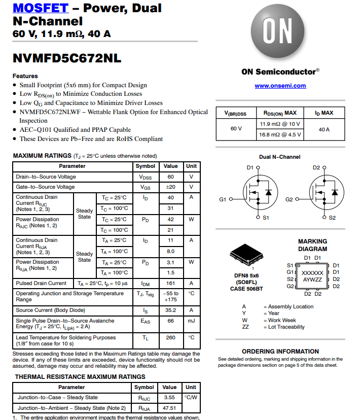

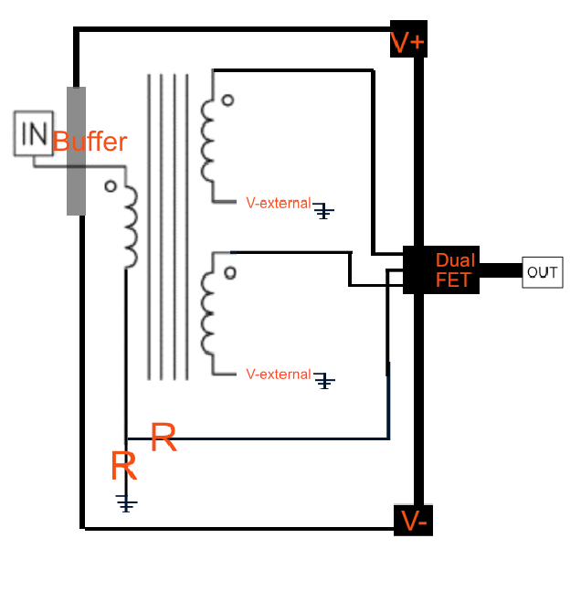

Since the nature of the bias voltage is now sorted out I come to another interesting problem. If the aforementioned battery sourced bias were to be employed, how would it tie in, and will this negate the need for the capacitors? In NP's early simplified schematic he referenced the bias to the source pins without the caps; he only then adds caps when the bias circuit reference is moved to ground.
Big picture here is what I'm thinking about. I want to attempt an R-core made with Arnon7 electrical steel. An R-core F6 with single primary, as NP originally envisioned. I like the idea of chopping out the bias circuit for an externally sourced voltage. If the caps can go thanks to the external bias voltage even better. Lastly, I'm looking at using a dual channel mosfet SMD. That combination of mods, on paper, appears to take the F6 in a very minimal direction, in terms of parts count and connectivity.
I think this guy looks pretty interesting. I'm practically assuming it would need to be water cooled, CPU style, perhaps on both sides of the chip. I did bounce the key spec off of several other FETs, several in stock SiCs included, and it holds up really well. I'm thinking you may get good match potential on a single die IC. I see it does have the extra diode symbol, dunno if that means anything here:
Note - Was typing before you put up the diagram of your simplified idea. I think I follow. Very cool! Looking forward to see how this all shapes up. DIY at its best.
@ItsAllInMyHead
About the role of the caps, I don't have a good guess just yet. And what ever I come up with will be a guess lol.
Glad you like the little sketch. It would be really cool looking I think, as it's very close to the original simplified circuit --but all of the requisite functions are there, just sort of off the board. Like you mention with ZM's boards. As to the rational, I'm just playing and this particular amp is super cool to play around with owing to the plentiful details provided in the lecture.
I'll see If I can get a decent R core figured out first. But I'm not sure if it will even be feasible to cool a dual channel FET, so my breath isn't being held on that deal. I'm trying three different things in the sketch and if I can make at least one of them work I'll be happy.
