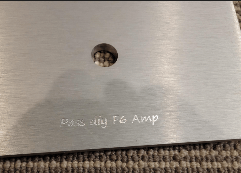

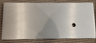

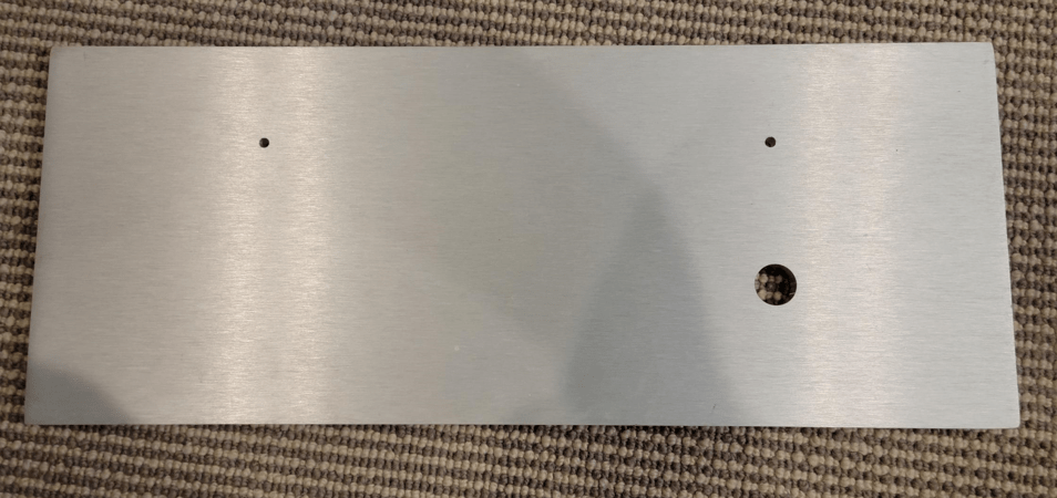

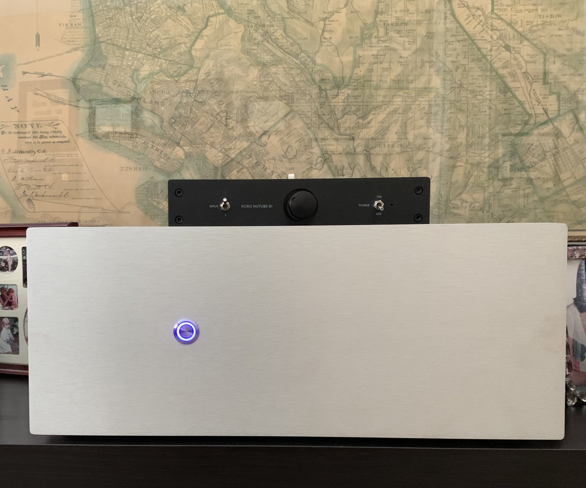

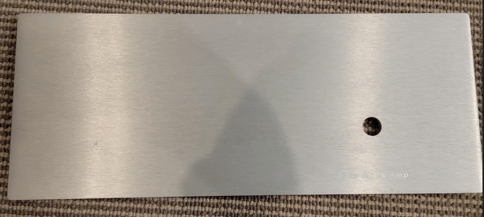

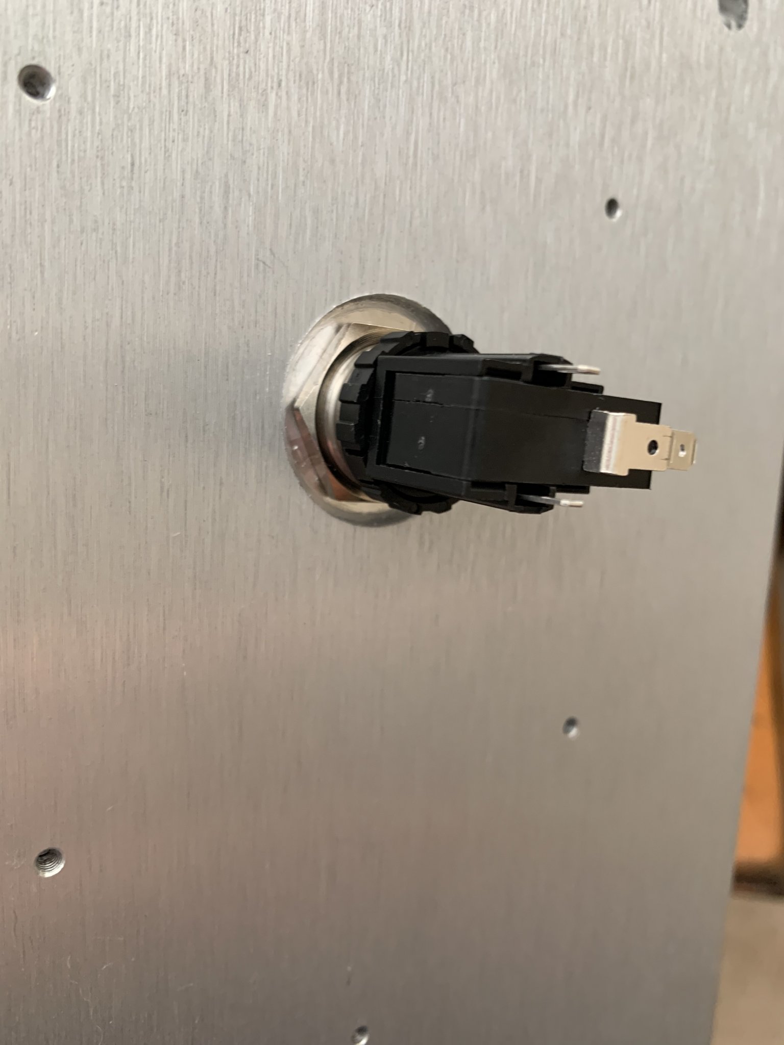

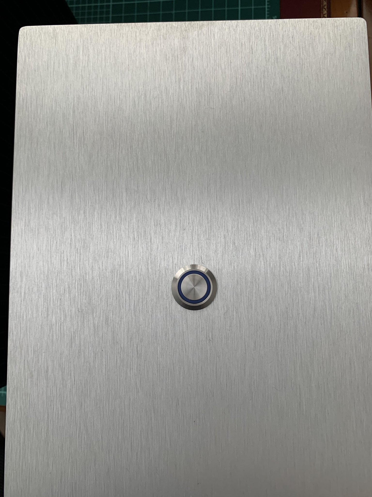

Finally sourced a push button switch for the panel front. It is a TE Connectivity AVH19LSFE7241604 Mouser #655-2-2364570-0. The led is powered from one of the power supply channels. Had to install offset due to conflict with transformer.Thanks for the suggestion and the link to Mark Johnson's thread. I am going to go simple and find a toggle switch to install on the front panel or perhaps the top panel.
