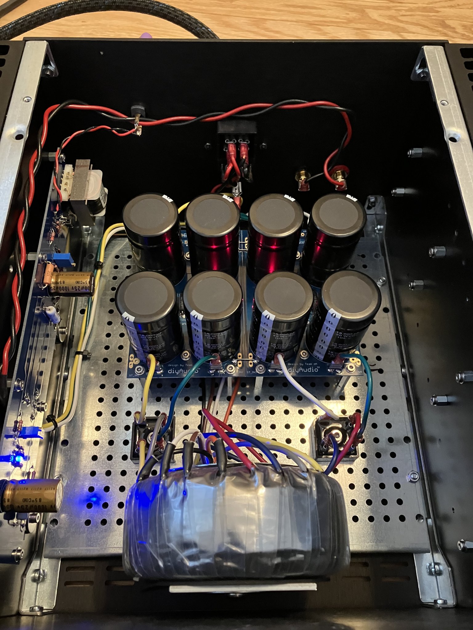

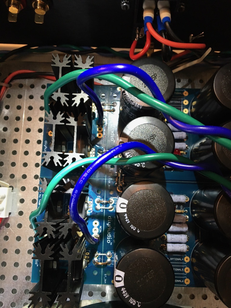

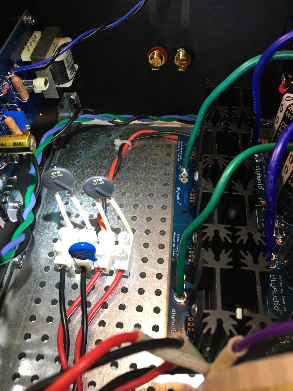

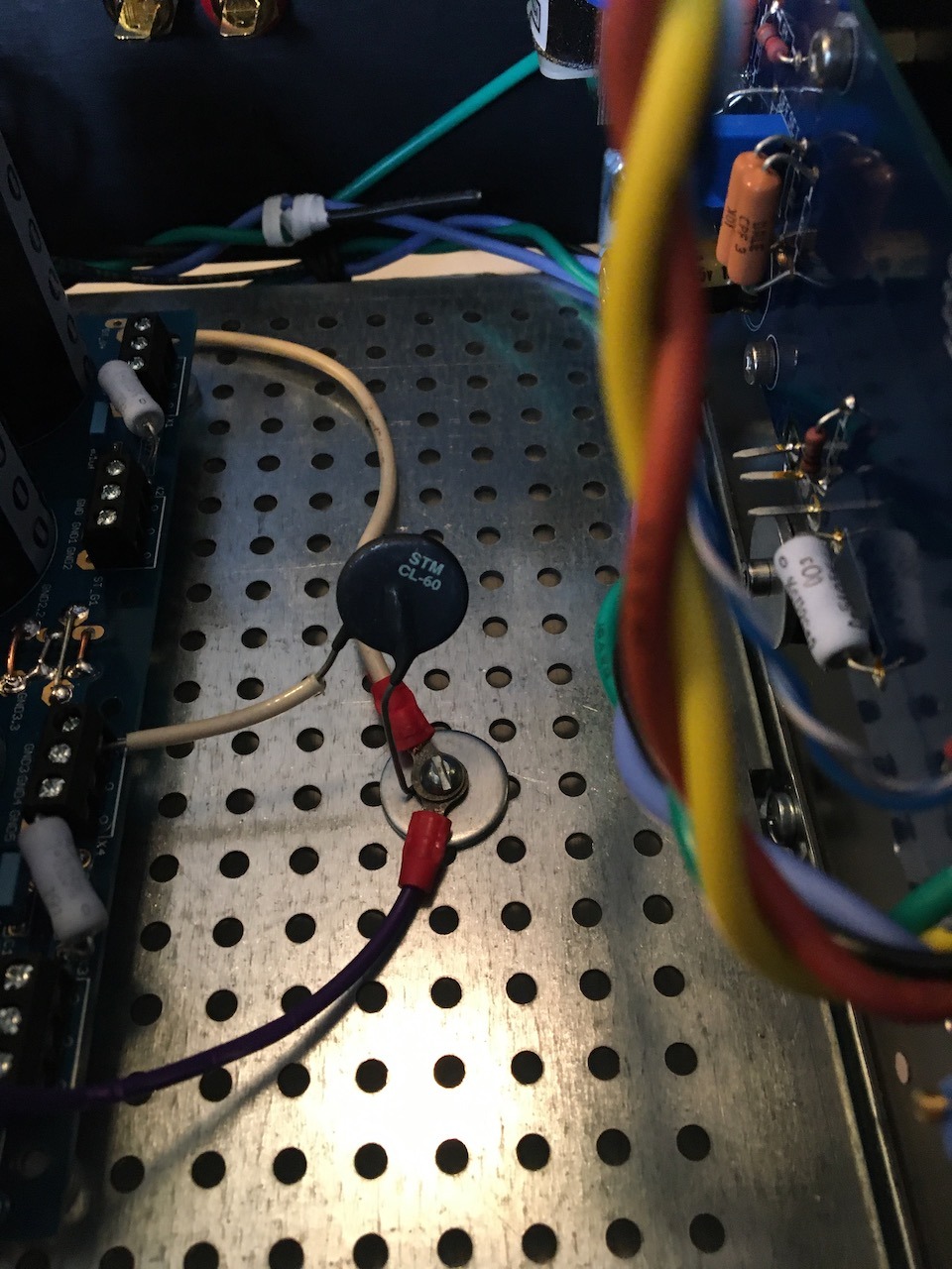

Finally got around to mounting the transformer vertically which gave me space to move the filter board forward and declutter some things. Got one channel running with the new filter board and the CL-60 soft start circuit finally implemented. 18,000 uF 50V 105C caps rated for 8k hours. Will get the other channel upgraded. After that, some fully stuffed rectifier boards to replace the discrete bridges.

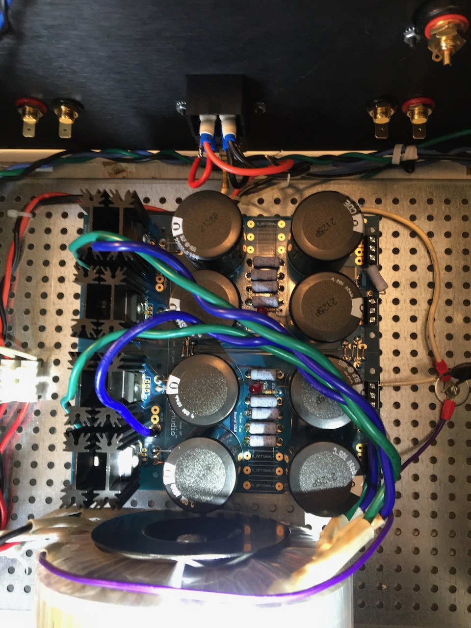

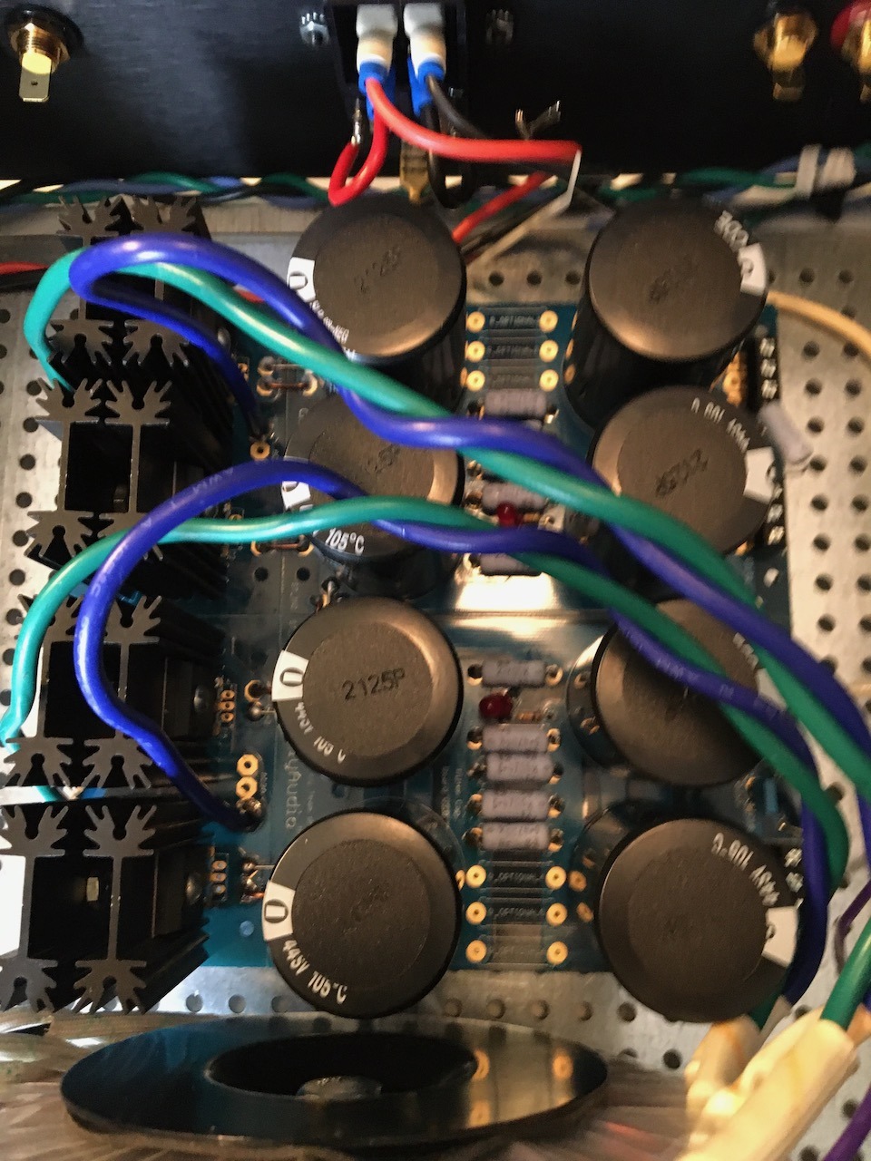

Today I fired up the power supply on my F6 kit for the first time. There is no connection from the power supply to the F6 amp boards yet. I ran the mains power through my dim bulb tester, which glowed bright then dimmed to off. Nothing exploded but one of the LEDs (the negative voltage channel) did not light so I turned everything off right away. The fuses on the AC input to the amp did not blow. I searched for a reason why the LED did not light and for shorts but nothing was obvious. However, I am not certain what I am looking for either. Both LEDs are connected with proper polarity ie. negative leg to ground. I Did some testing looking at continuity and noticed there seemed to be continuity between the grounds on the power PCB and both the plus and minus voltage connections on the power PCB. Then I noticed that the readout on the meter started low and grew higher so I suspect the current from my meter is charging the capacitors. Maybe that is ok?
So at the moment I only know that the led on the negative rail does not light. Is it possibly just a damaged LED?
I would really appreciate it if someone could look at the pictures I have attached of the power supply to see if everything appears to be in order. I a bit nervous about a second try with power, really don't want to fry anything if possible.
The negative voltage channel for which the LED did not light is the lower one as shown in img_1360, 1361, 1363.
If it had powered up without incident I was going to check for a DC voltage across the V- to Grnd and the V+ to Grnd looking for something around 23 volts in each case. Is that correct and are any other tests recommended before connecting the first amp board?
That's incorrect. The negative (cathode) leg has to go to the 'lower voltage' side.
So for the positive rail, for anode goes to the V+ and the cathode to GND.
For the negative rail, the anode goes to GND, and the cathode to V-.
Edit: For the voltage measurement, with the COM / black probe on GRD, you should measure about +24V with
the red probe at V+, and about -24V with the red probe at V-. The exact value isn't too important.
Dennis,
Thanks! That must be my problem. Do you think if I reverse the offending LED it will work or should I replace it? Is it likely I damaged anything else?

So taking the sage advice of the honorable 6sX7, both leds lit up and 24.4 volts was measured at each the negative and positive rail. Color me happy. Many Thanks again. Onward!
