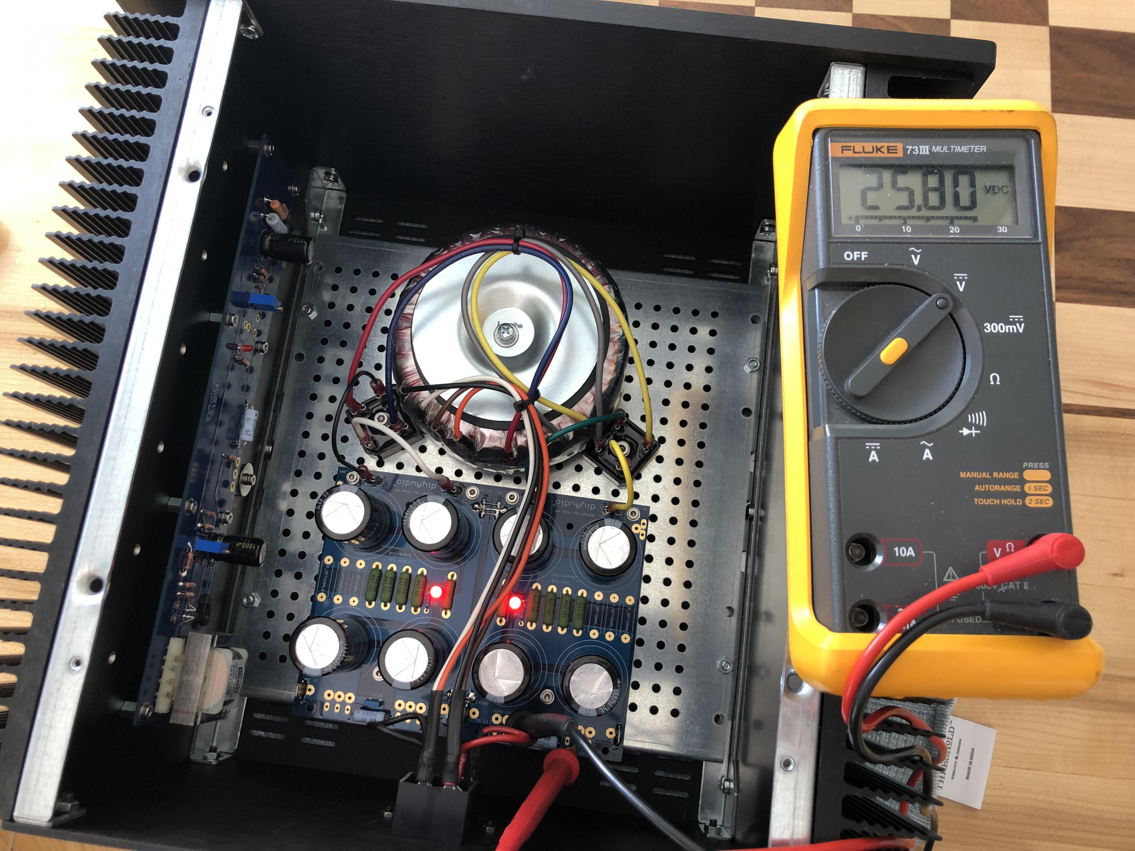

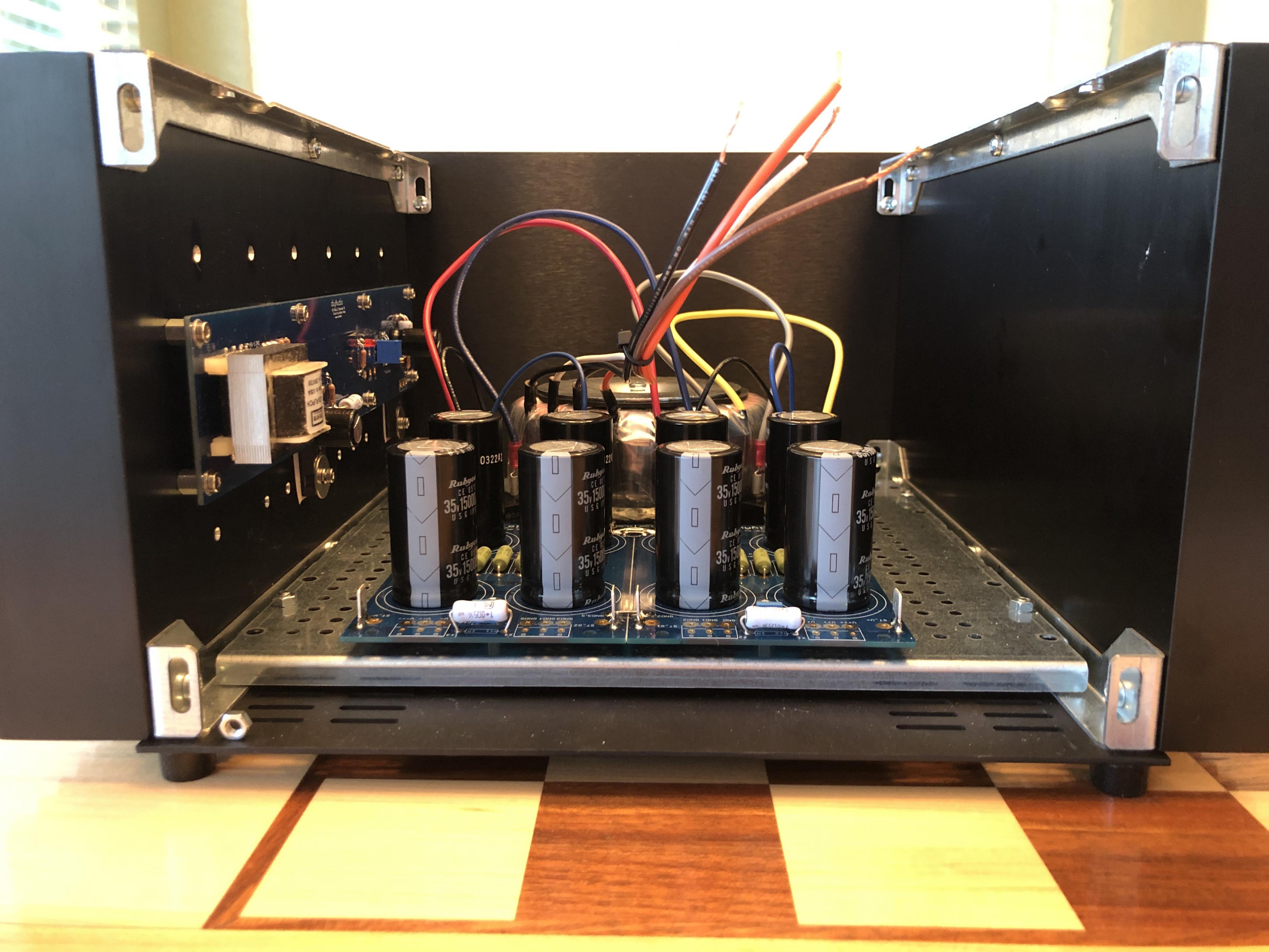

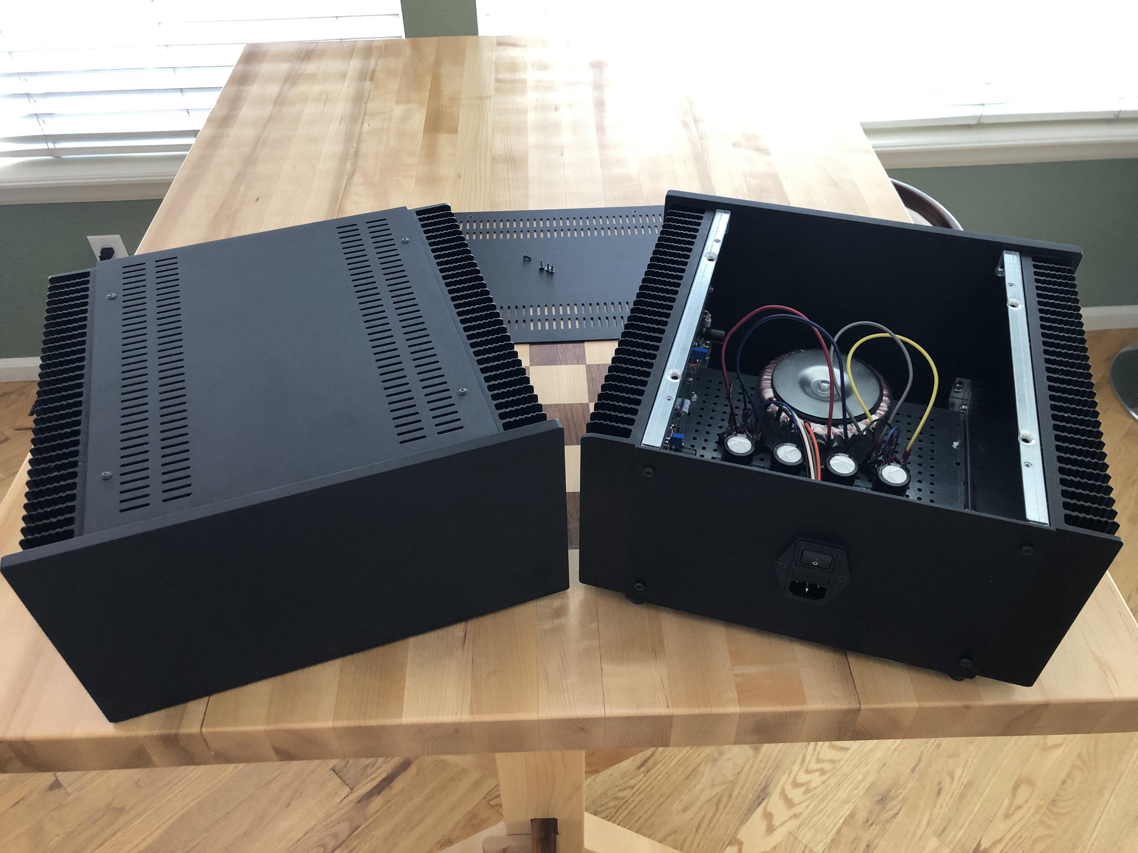

Still a bit to go, holes to drill, wire to wire, bias to bias but, thanks to Modushop and Gianluca, F6 monoblocks have appropriate cages.
Building them as single ended monoblocks. One channel/signal board per chassis. Considering going balanced down the road and set things up so it is easy to do (2nd transformer, 2nd psu board, 2nd signal board). Will have to replace or tap the heatsink but everything else is bolt on.
As I used the PSU boards per the build thread for a stereo set, I may have an overkill capacitor bank but learning as I go.

Suggest you add a thermistor or 'soft-start' circuit for that large capacitor load, and also include another one for the 'ground lift' too as per the basic F6 power supply diagram - perhaps you can create some space for this if you can move the transformer & pcb towards the front or to one side...
Thanks! I'm researching that bit tonight in prep for my next Mouser order. very used to vacuum tubes so still adjusting from high voltage to high current thinking.
I think there is room there without having to move anything. There is more space than the picture lets on. If not, moving one of the diode bridges should do the trick (he types hopefully).
CL 60's are the thermistors to use if I remember correctly.
https://www.mouser.com/ProductDetail/Amphenol-Advanced-Sensors/CL-60?qs=w3gjcs3NwciEQjXGFRAAAA==
I ordered a few extra of them as they are a hot item in all of these designs. If you are doing the 15000uf caps then I think you can get away without the soft start. I am not an expert though. I have the 18000uf caps (I think 6l6 suggested them a while back) and haven't had any transformer issues so far. I only have the CL-60s on the transformer inputs and ground to the power supply board.
Youn could also use Ametherm SL22-20007 https://www.mouser.com/datasheet/2/600/SL2220007-276391.pdf
if you can't get the CL-60s.
I prefer Mark Johnson's Softstart PCB: low voltage On-Off switch drives AC mains relay \ includes soft start .. H9KPXG
The problem with "Thermistors" is that if you turn the amp off and then turn it back on without waiting for the CL-60 to cool off you have no inrush limiting. Then the inrush Gotcha! Themistors have no such problems for ground lift and are recommended for that.
Copy that and thanks, Mike.
Do you know what issues arise with the transformer? I'm using Hammonds with a 220VAC rating since it is one signal board per power supply. Guessing there will be a bit of current limiting due to the lower VAC limit but don't know if it will cause a hardship with current transients on the transformer (windings buzzing loose, thermal overload, etc.)
Vacuum tube rectifiers make all this so much easier but that's a different beast with its own issues.
