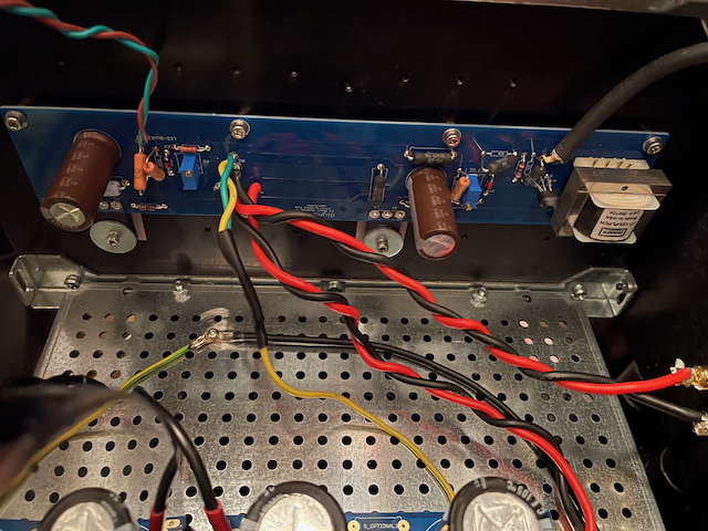

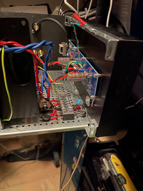

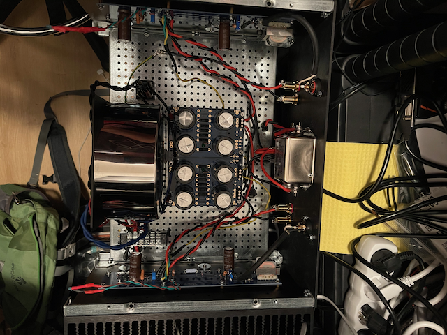

Hi guys, I have some pics of the build i'm just trying to set the bias now
the right Channel set perfect the left channel has an issue
bias set ok to 500 mv but the offset has 17-18v coming through the speaker terminals and the pot does not have an effect something also my led is not on but that could be from soldering to hot.
any thoughts before I take that board out.

bias trouble and fix
got it fixed I resoldered the pot and changed the 10k res, and I flipped the led,
it was in correctly - to - and + to + but didn't work until I flipped it not sure what's going on there but it works now, bias set to 500 mv and offset 0
very stable,,.. time for a sound test :)
