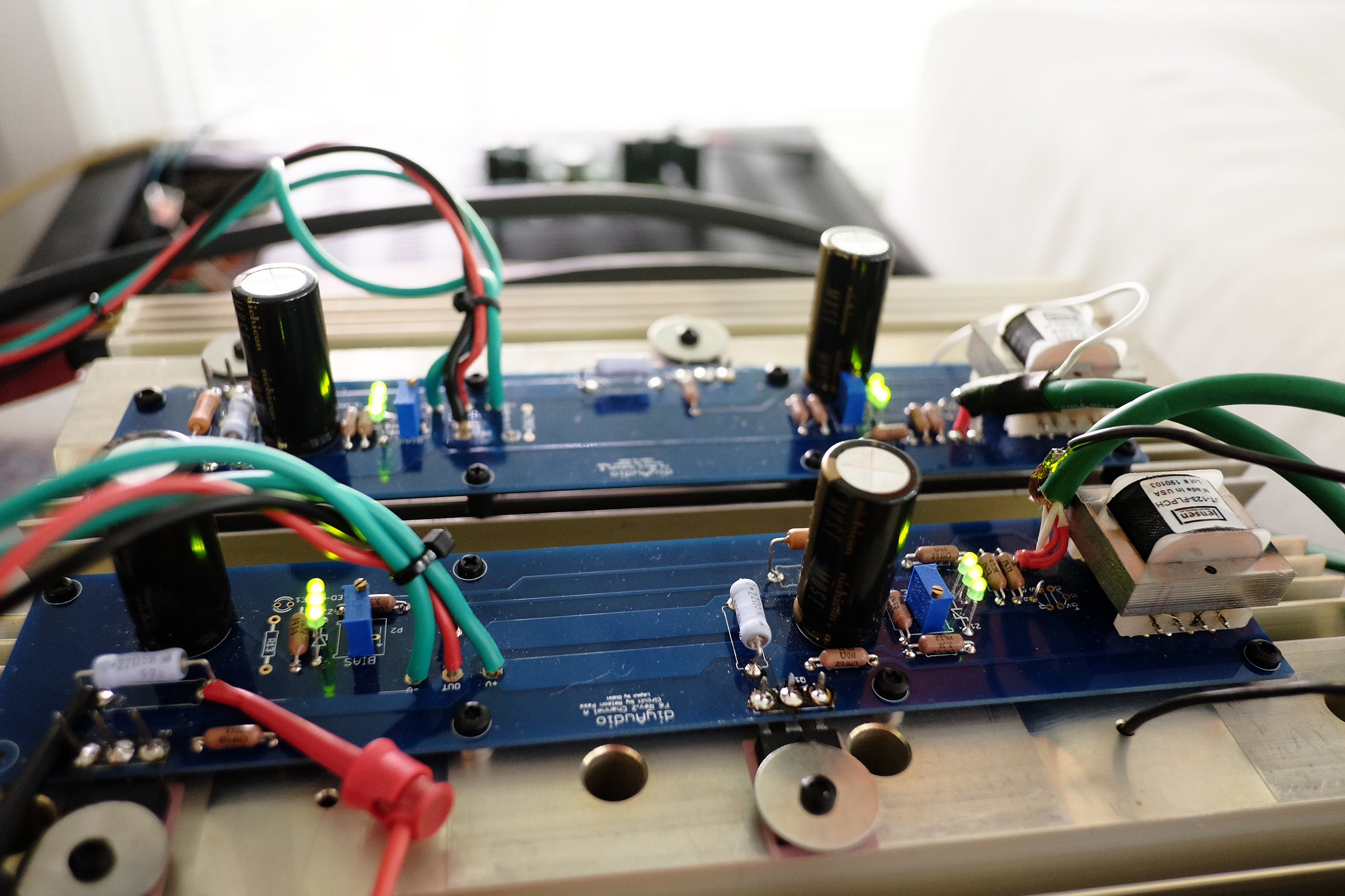

Could you tell us a bit more what went into your choice of MOSFETs and R1,2 values?

Well if you installed the green leds then you don't need 0.47 Ohms.
With 0.22 Ohms you have less heat in the resistor. Less heat equals less thermal distortion. This was an observation I made while testing resistors, some resistors were bloody terrible. The best I measured were Vishay CPF. I am sure there are also many other good choices though.
Regarding mosfets these were carefully chosen based on transconductance values to provide a certain sonic character without needing any degeneration whatsoever.
The other method is to use degeneration but that leads to some increased higher order harmonics.
The end result should be something that approaches the sound of J2 but with only a single gain stage, and is also much better into reactive loads.
In other words, it's bloody good.

Pico, if I go with your 3 led solution, I should change the .47’s to .22 ohms?
Just want to make sure I understand.
Thanks very much
If you are building on a fresh pcb then yes.
If you have to desolder parts, then I’ll leave it up to you to decide.
But doesn't the choice of R1,2 of 0.56/0.47 vs 0.22/0.22 also influence the composition of harmonics, if I understood Nelson's talk correctly and also the discussion in some of the other threads (a while back, when I wasn't on this forum yet)?
So basically going degenerate (R1 == R2) de-emphasizes third harmonics, so it would result in relatively more second harmonics (or was it the other way round)? I hope to find some time to start playing with REW soon.
I do think I hear a difference in the sonic signature (aka sounds more better bloody good) after the changes, which in my case included going with 2picoDumbs' alternative mosfets.
