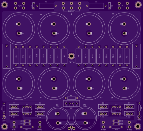

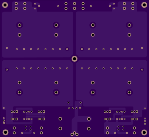

some while ago I made PCB design similar to diyaudiostore universal power supply, but with LT4320 + mosfet rectification and onboard dc blocker. Have not built it yet. Take a look - if you like it, I can share gerber files. PCB size is 155x142mm
