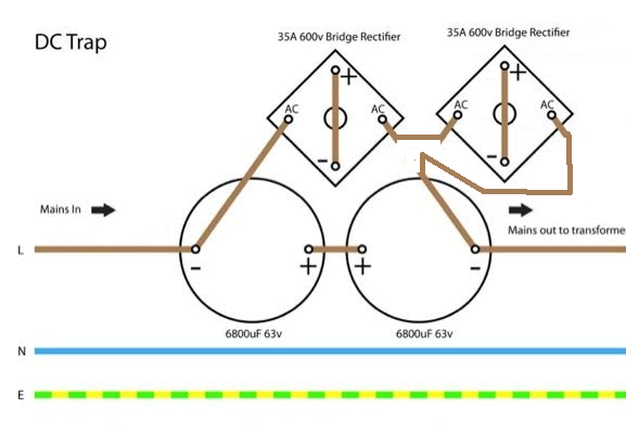

The basic GB bridges are very convenient and having all four diodes on the one substrate makes for closely matched performance so it'd be pretty unusual to get one to be faulty but maybe one leaky diode might create something like the problems here - it's certainly a puzzle.
At the moment I think the most likely problem is:
1) DC on the mains
2) Faulty Bridge rectifier
3) Or something dumb that has been overlooked, eg incorrect installation of ground lift
thermistor or poor quality connections etc.
4) Maybe hum is being picked up on the Jensen from other electrical equipment nearby.
With 90dB speakers, there should be dead silence at his speakers.
It's not terrible but there is something not right, it would be in his interest persisting with it to get it fixed.
Here is one example of a dc blocker circuit. I think some member posted it but it's essentially the same as the Rod Elliot one but with greater DC blocking potential
Not hard to build at all. I would use caps with screw terminals.
Just add more bridges in series if the level of DC is quite high.
2 bridges should be sufficient though.

Yep, totally agree about using the "better" caps in the dc trap - it does make a difference - and remember 'peranders' dc traps that use different number of diodes to counter higher levels of the dc component - still available, I think.

My thought is that I do have noise/DC on the mains. However, replacing the Bridge Recifers is inexpensive and easy, so I will do that as well.
If the issue is with something in your items 3 or 4, shouldn’t I be able to change the amplitude of the hum in some way?
This is nice and simple - ordering parts to play around with it. Thanks!
