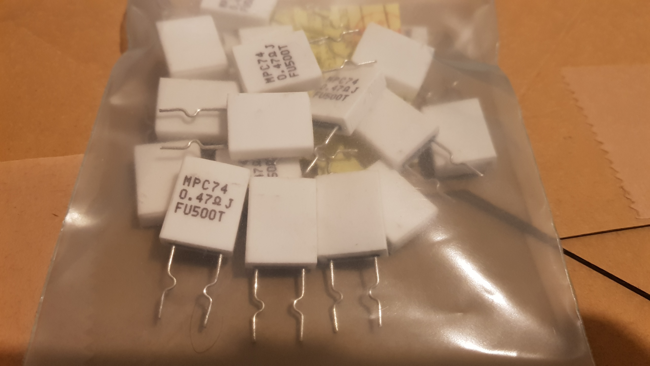

They are non-magnetic which is good, but so are Panasonic and Vishay. So there is no advantage in that regard vs Panasonic and Vishay.
What I don't like about the MPC74 resistors I measured is that there thermal behaviour is ridiculously bad. Resistance is all over the place (both positive and negative) dynamically as they heat up.
This does not occur at all with Vishay.
I guess another way to put it, is, if MPC74 are considered good then Vishay CPF3 are orders of magnitude better eg something like 100 times measurably better. That's not an exageraion either.

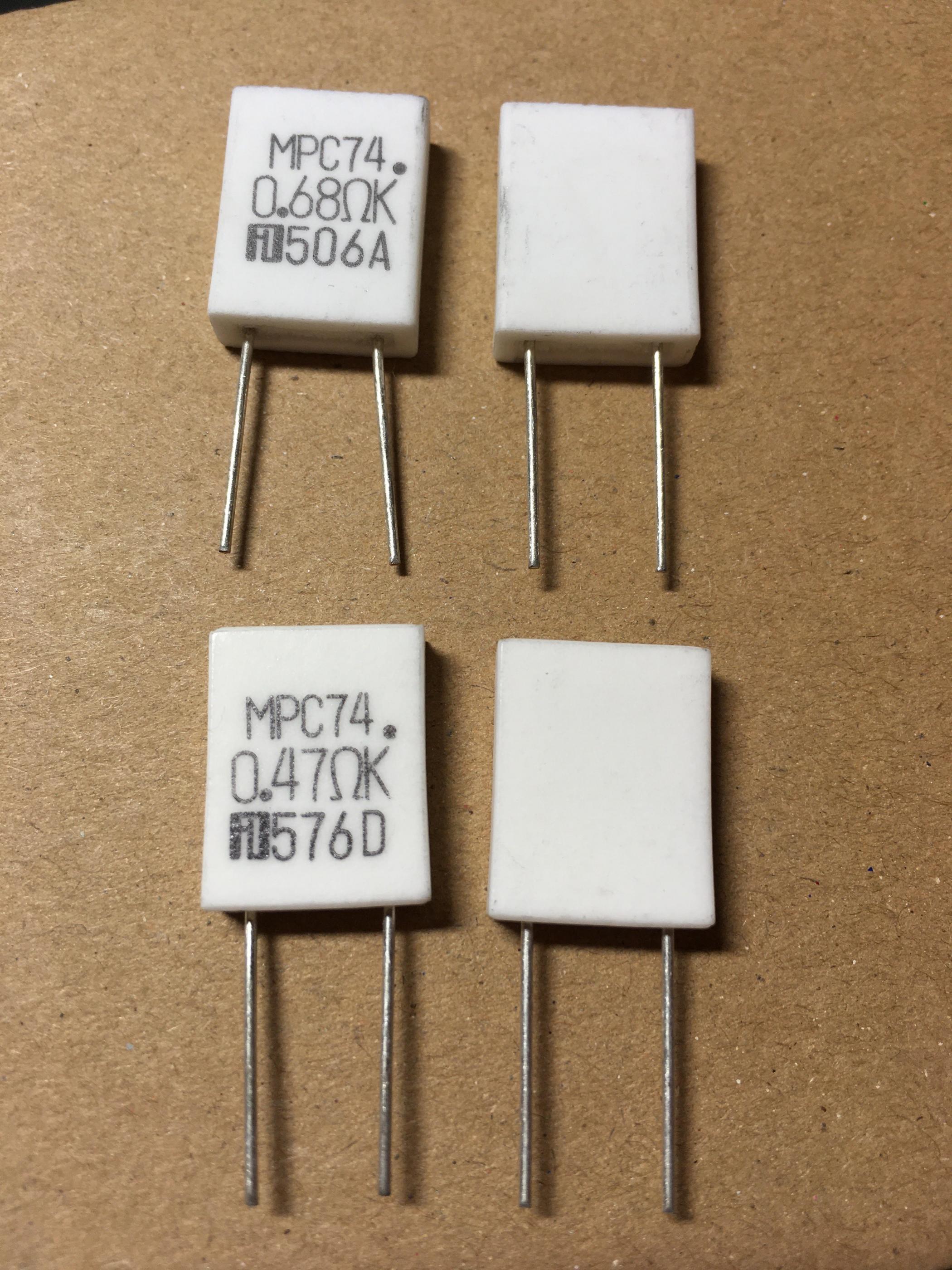

Hi,2 picoDumbs-san
The MPC74 in your photo seems to be different from mine.
I purchased these at an electrical parts store in Japan.
It's hard to recognize, but the product pictures of the manufacturers are the same as mine.
Metal Plate Cement Resistors | 抵抗器 ハイブリッドIC | 福島双羽電機株式会社

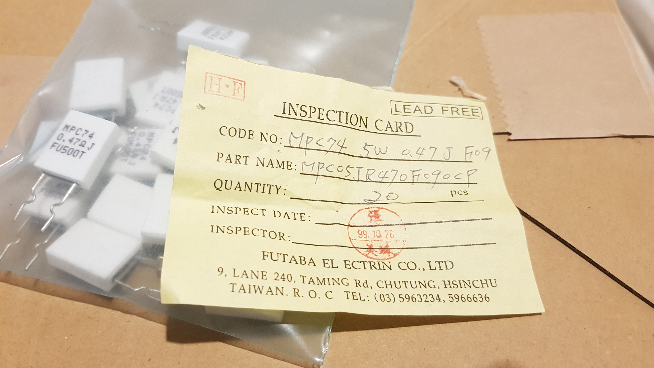

These were purchased directly from Futaba.
Here is Futaba's inspection receipt.
Says Futaba Taiwan, so I guess your ones are Futaba Japan, and mine are Futaba Taiwan.
I will try and get hold of the Futaba Japan parts to see if they are better.
Oh, I see. I did not know Taiwan Futaba.

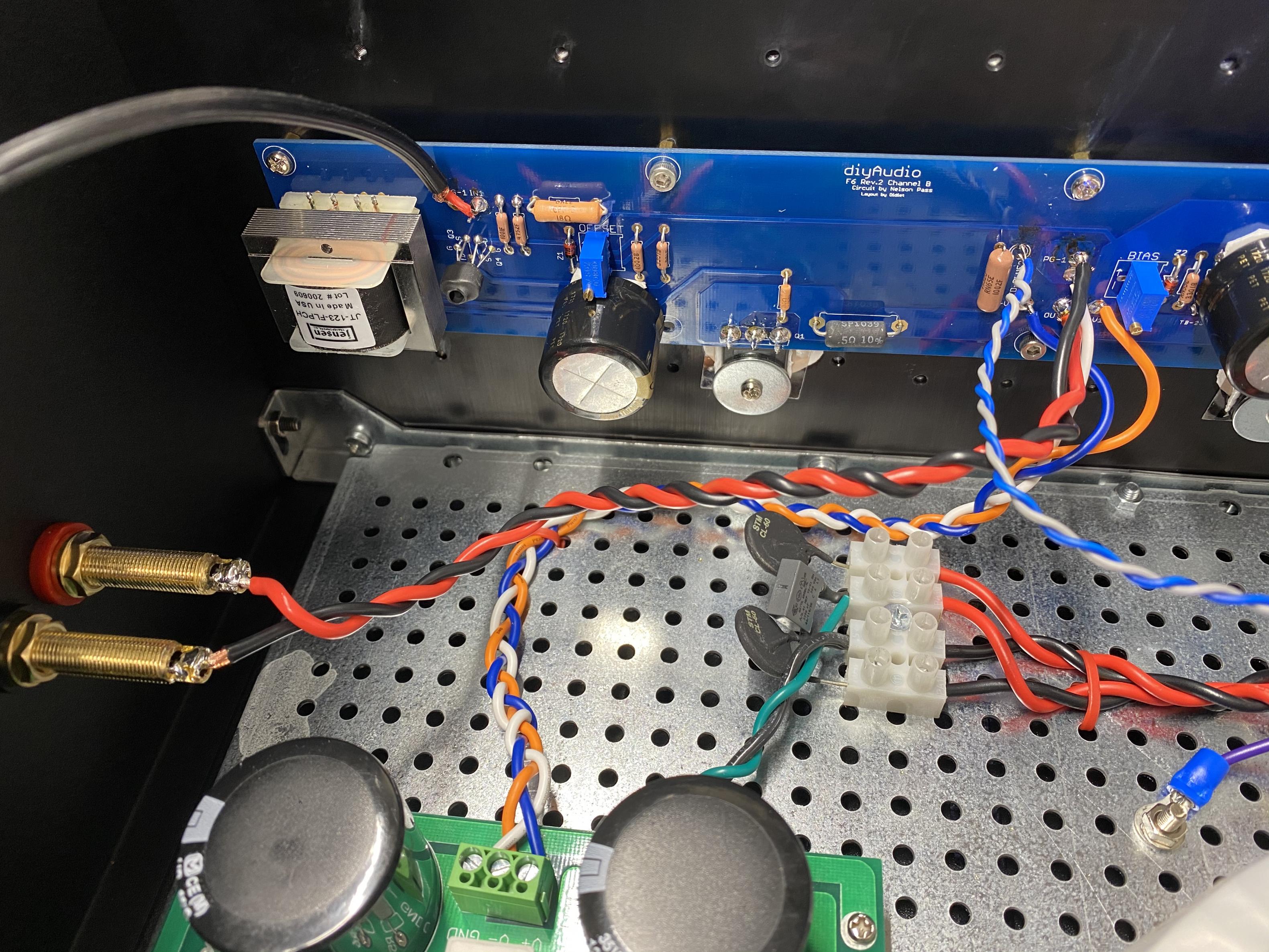

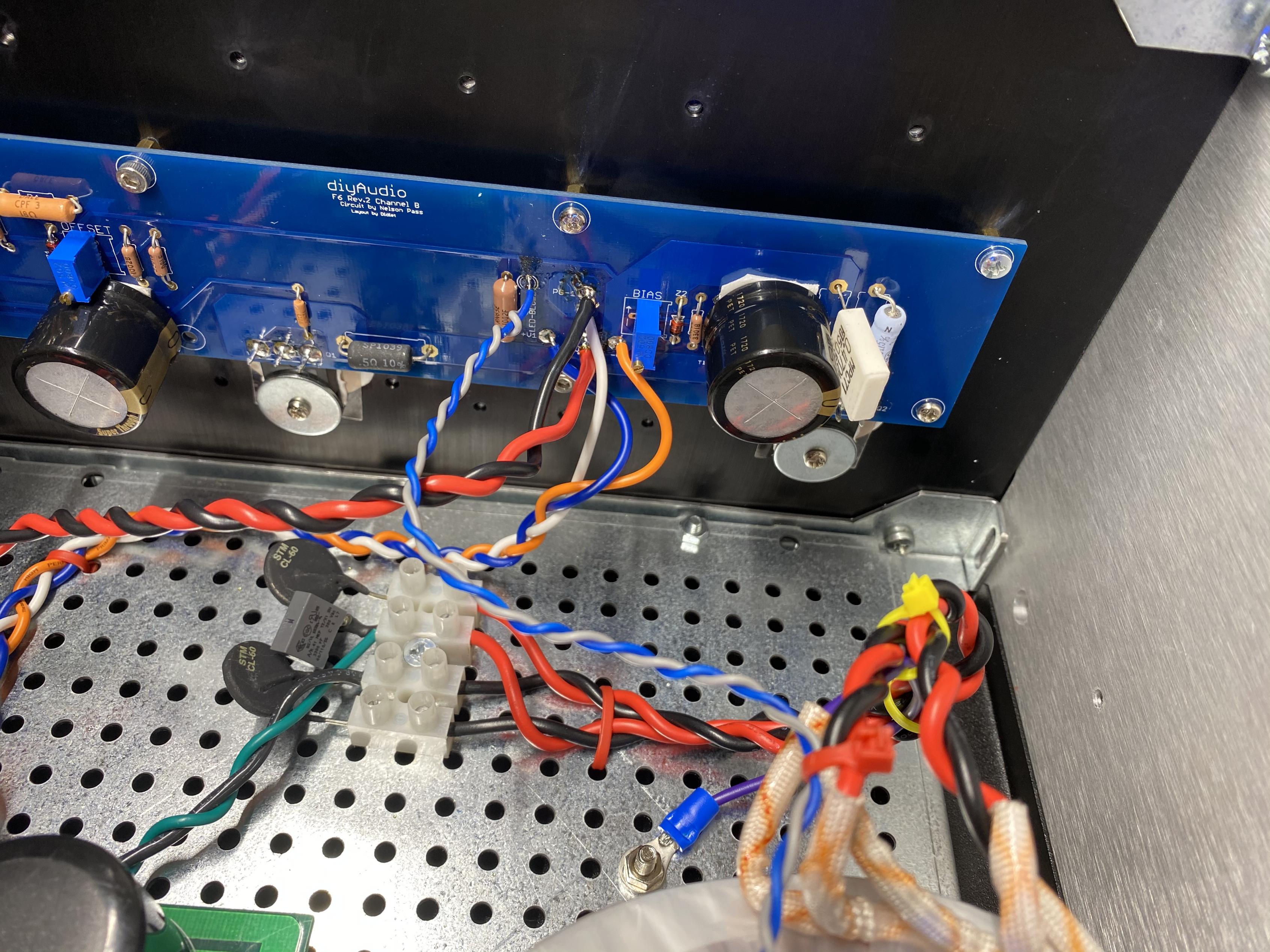

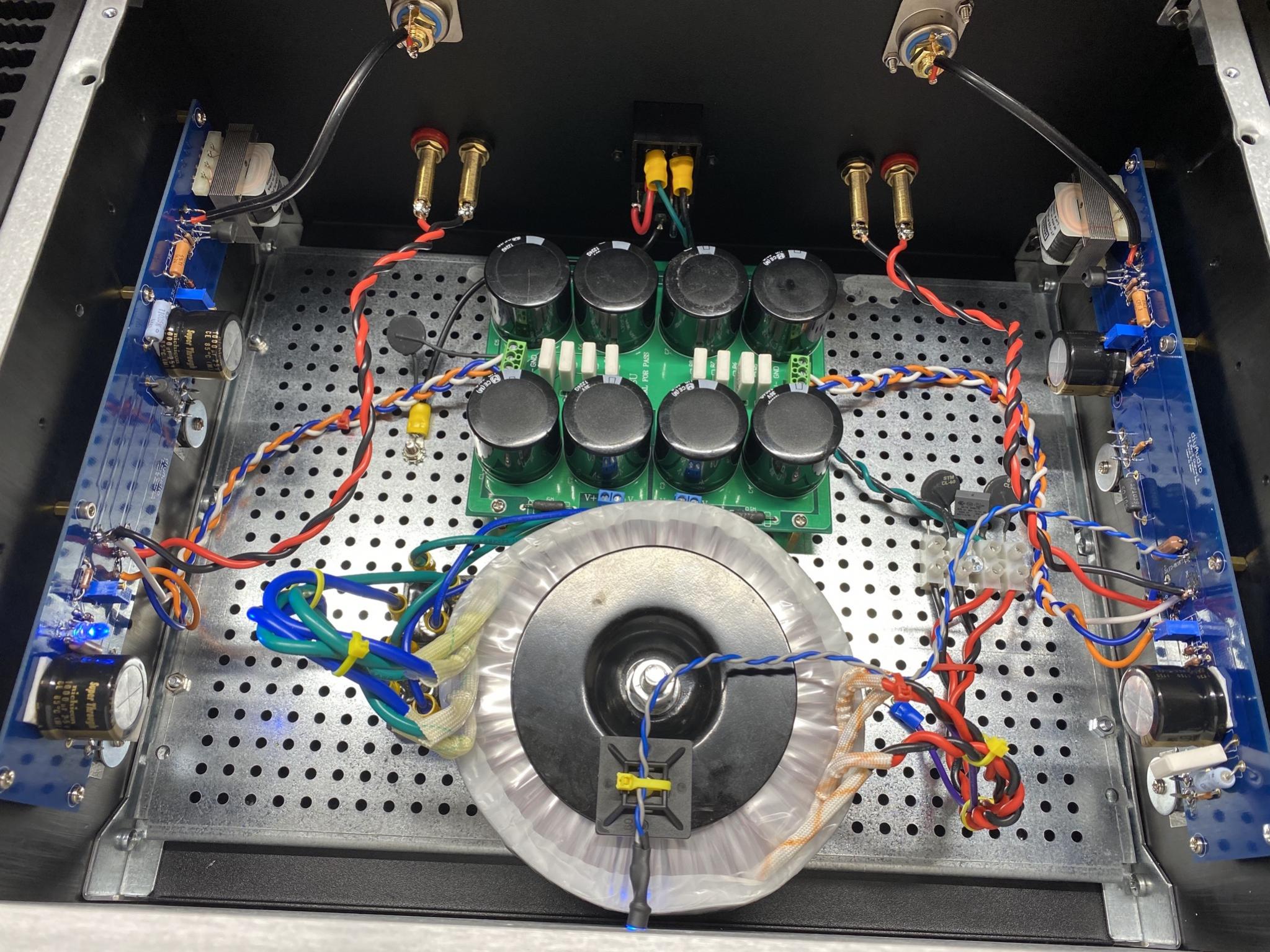

Just finished my F6 build but ran into a small problem.
Both sides of the amp biased fine to .5V, offset set to 0. I plugged in speakers and the right side is much quieter than the other. I swapped rca, swapped cables, and swapped speakers but it always came down to the right side much quieter. When I listen to just the right channel it is distorts at higher volumes.
Hoping to get any help possible.

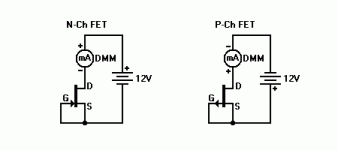

From a reputable seller. I have a friend with an audio store here in Houston that received a large amount of kits from a customer they included a lot of matched pairs of Toshiba JFETs. I’ve used quite a few of them in builds with 0 issues but maybe this pair could be a dud?
Any way to test them while hooked up?
If I replace them, do I need to replace both channels or can one side be a different matched pair?
