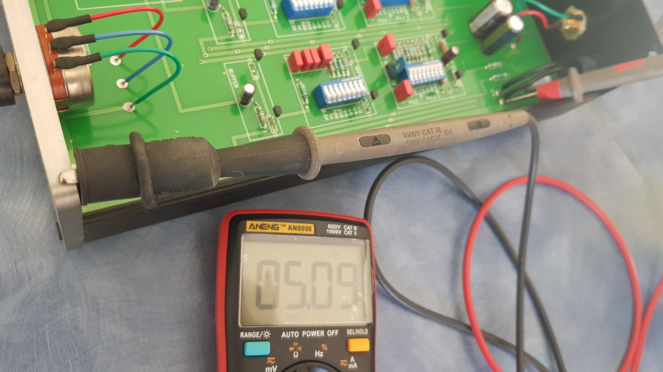

Measure resistance from 0V on Meanwell psu to chassis.
no reading discontinued

In my regular B1 (the original), the chassis and psu 0V are intended to be connected.
You should measure 0 Ohms (or near it due to some contact resistance of your probes) here, not open circuit.
Are you using metal standoffs on your pcb?
In the original B1 pcb this electrical connection was made from the pcb through the pcb standoffs
You need to fix this connection.

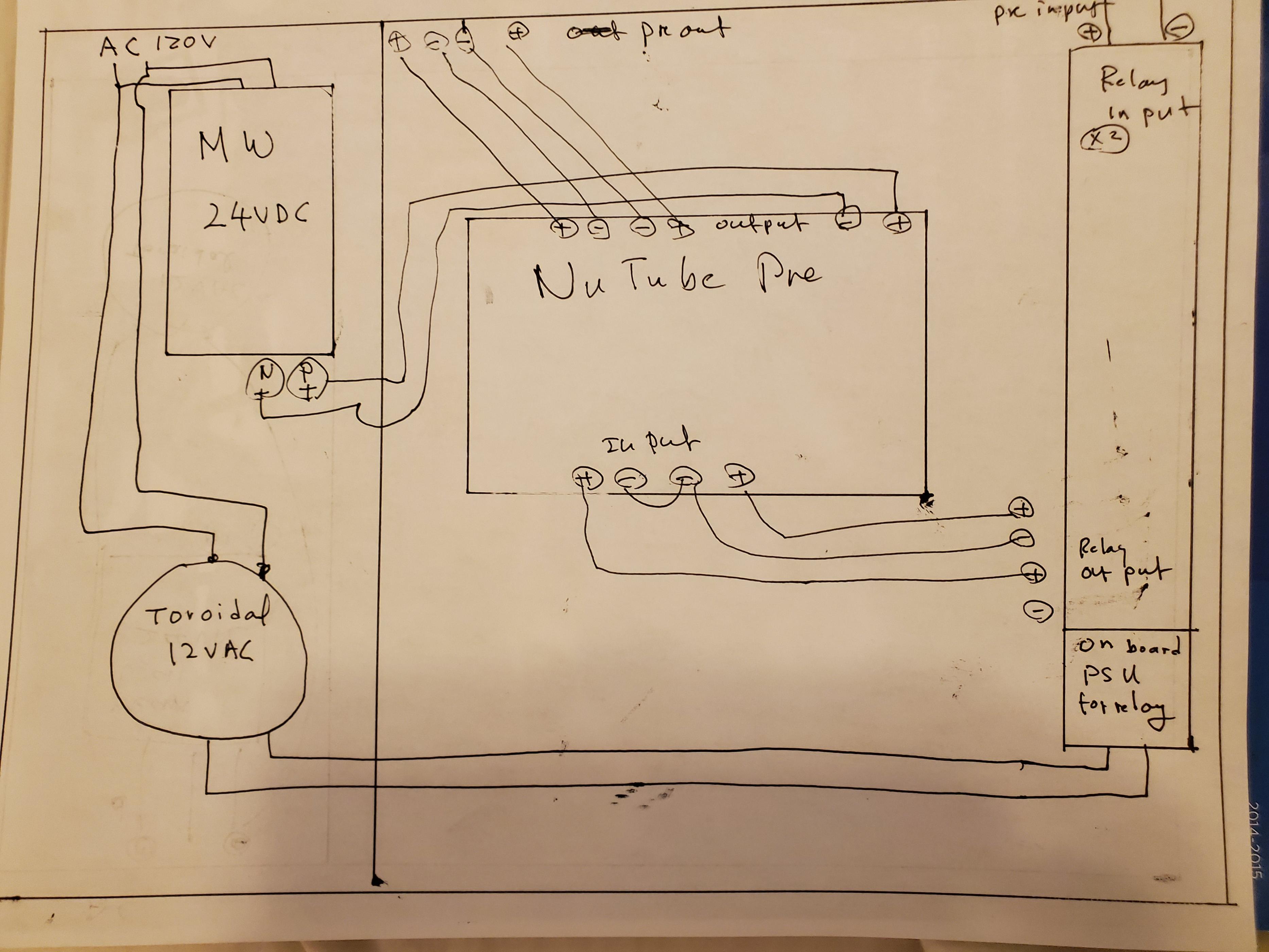

@Yaho: What about the stepped attenuator relay board and its power supply? (From your post in the B1 Korg thread.) How is this connected?
A wiring diagram and some pics would certainly help 2 picoDumbs and others to help you.

Measure resistance from 0V on Meanwell psu to chassiscorrection...O ohm

Also how is the Meanwell psu 0V connected to chassis?
I did not connect PSU 0V to the chassis. Should I? Just to be sure, 0V is the negative side of PSU?
