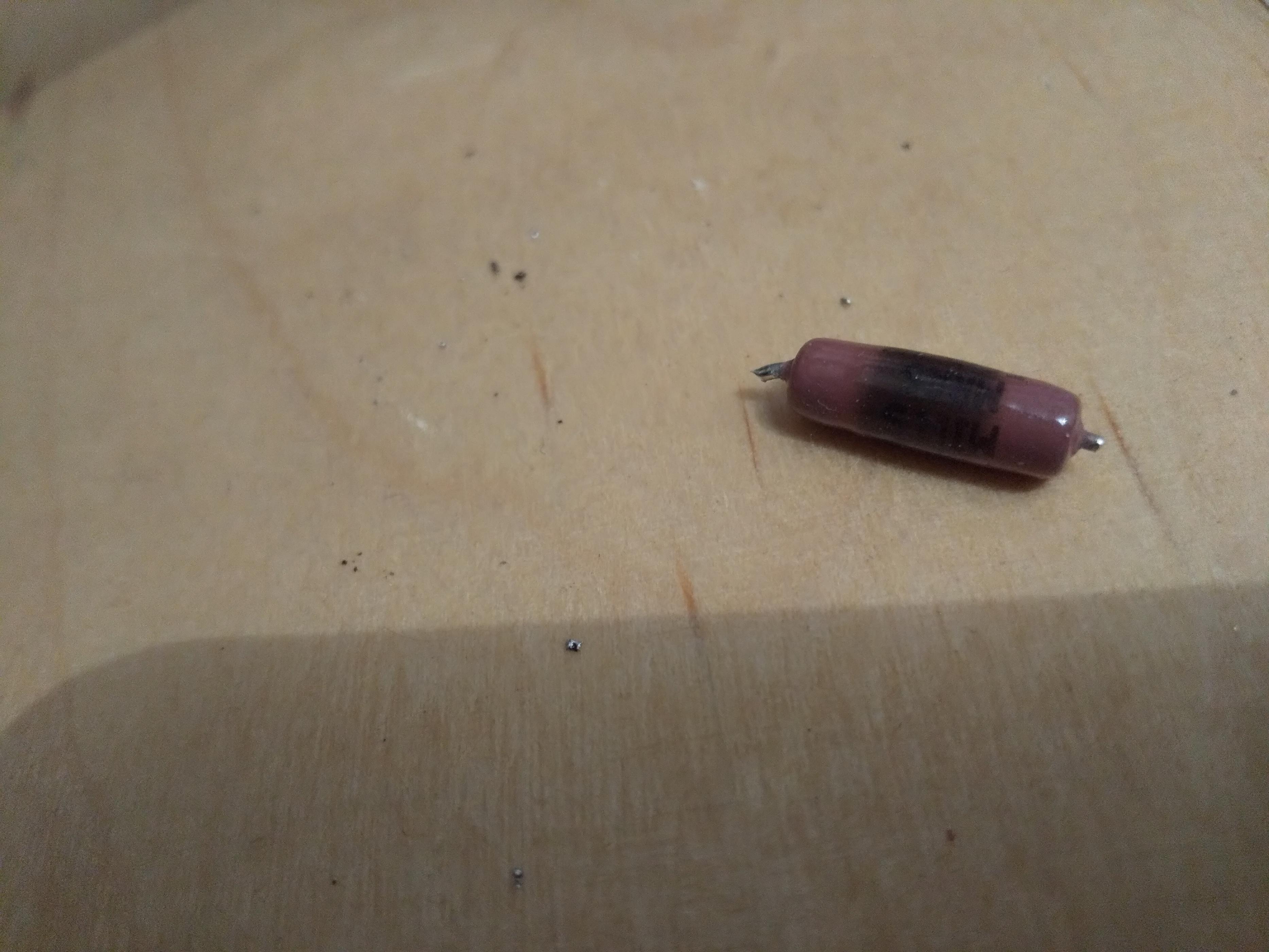

The smoke come from R1 right channel.
I changed R1 this morning,then measured voltage at R2.
It was 0V.
Changed all caps. Vgs are 3.3V both.
If smoke was coming from the resistors and the mosfets no longer turn on even with 4.5V Vgs then most likely your mosfets, may now need replacing

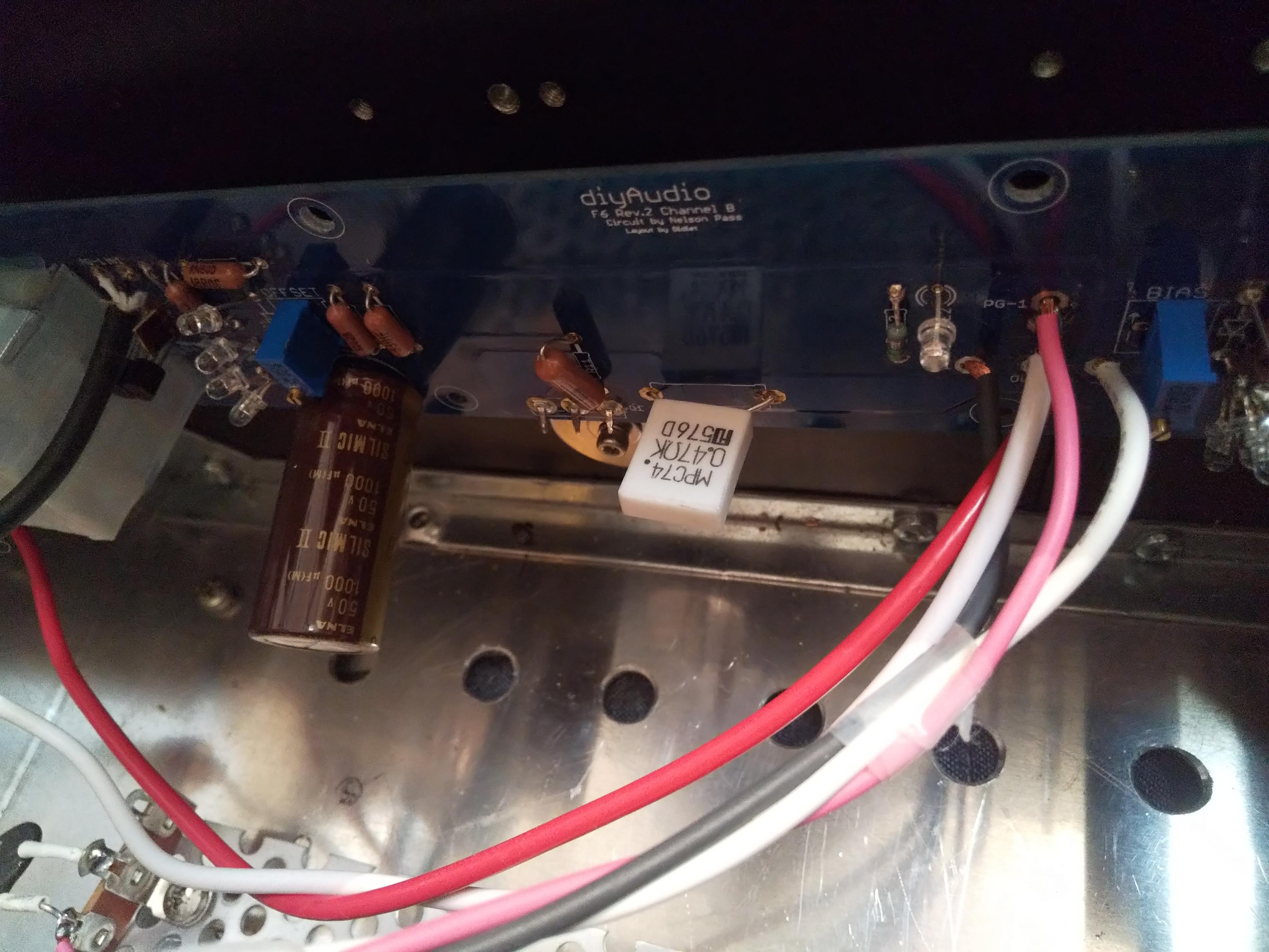

I changed mosfets but nothing problem.
When I plug from bulb tester, bulb lights one second
Then all LED light up.
After 10seconds,LED turn off then bulb turn light again.
I'm checking every resistors but can't find any failure.

What can happen.
Eg
You have set your trimpots wrong, Vgs is too high
At start up
1) PSU Caps Charge - Bulb On
2) LEDs On - Bulb Off
3) C1, C2 Charge - Bulb Off
4) Mosfets turn On Really hard, - Bulb On
5) Supply rails drop in value due to voltage drop at bulb
6) Leds go out
7) Mosfets go off
Measure Voltages at psu when light bulb tester is connected.
Please adjust trimpots to mid point.
When I turn on with bulb tester,
PSU have + - 25V.
But 5-10seconds later,PSU down to +,- 10V.
PSU have + - 25V.
PSU have + - 25V.
What is the wattage of your bulb ?
Looks like its too low when the amp is trying to operates, therefore you got a huge drop in your secondary rails. 24-->10v
