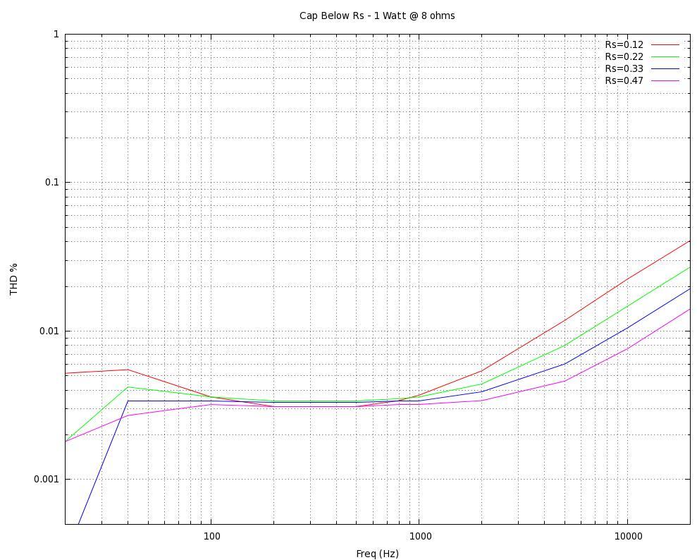

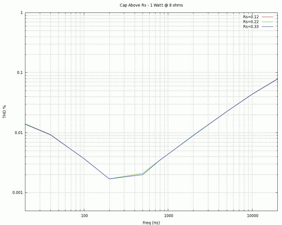

My Rs is .25 so the difference is more obvious.I would venture to guess that it is a result of more distortion in the above Rs position. Below Rs, the amp is more focused, but shorter. Now to discover how to keep the THD spectra of the one with the overall distortion of the other, shaping the sound of the amp.
Ilquam, have you measured distortion both ways.
I might have actual circuit measurements both ways, but it might take some searching to locate them. Here are Spice sims both ways. My experience is that the simulations do not accurately model the transformer behaviour. I will try to find in-circuit measurements.

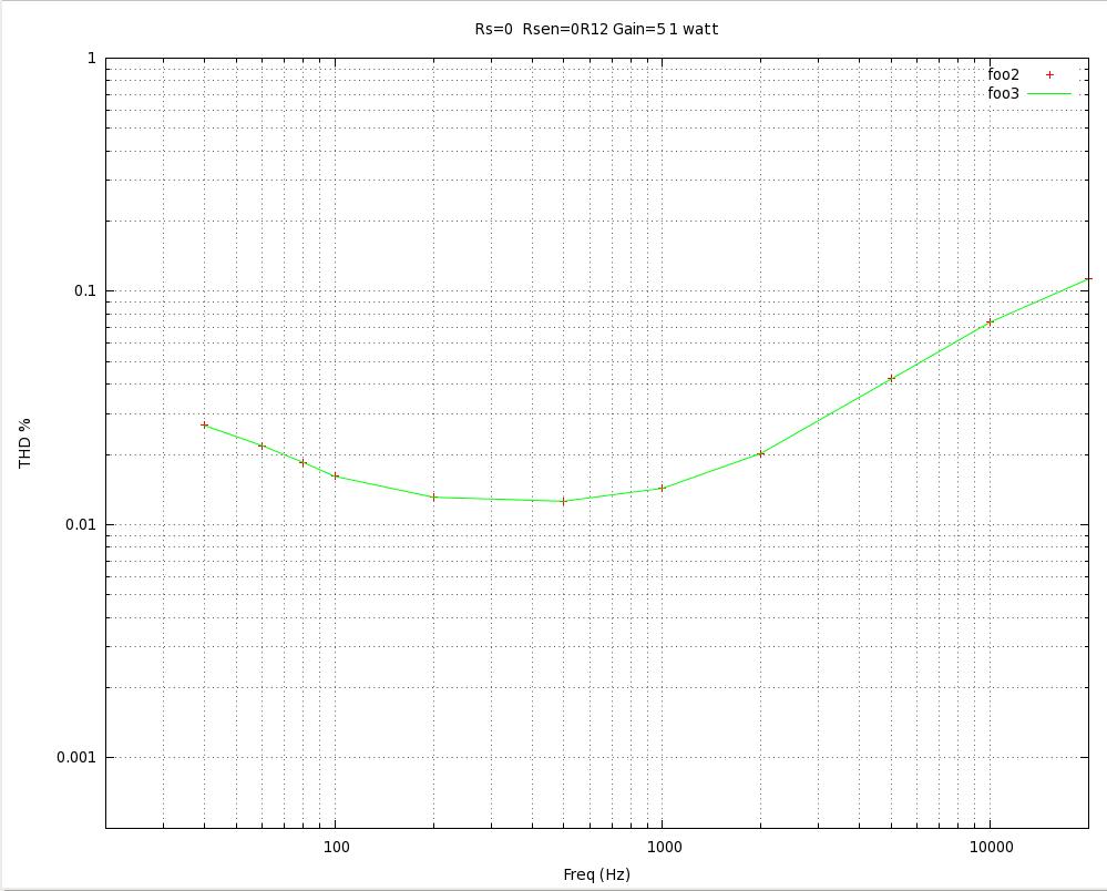

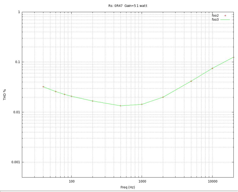

OK, here are the only in-circuit measurements I can find. The left plot is with the cap connection below Rs with Rs=0R47. The right plot is with the cap connection is above Rs, with Rs=0R12. They are very similar in THD, but the the one on the right has much higher open-loop gain, thus more feedback and lower output impedance, thus higher damping factor.
Unfortunately, these measurements are of the amplifier channel with the suspect R100 JFET(s).
I need to get my test setup kicking. Want to get a view of the breakdown of the THD, showing 2nd vs third, and so on. There is something going on other than DF, especially in your case, where Rs is minimal.
