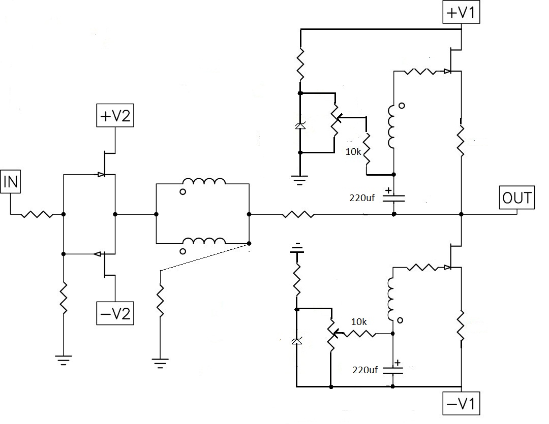

I got mine 90% done. Started out wrong and did input stage like F5, but with signal coming out after 10ohm Rs of Jfets. Got the pot for offset trim. I used BA-1 style bias circuit, dropping teh resistor for Jfet ccs feeding 3 led string. This has parallel 10uF cap and feeds a 5K pot for gate bias. basically looks like Bodu's circuit. I am using laterals instead of SS. Have to reduce feedback resistor since i dont think Laterals will give em much gain to work with. Thinking about overall gain of about 10.

A 1uf, 100K RC filter will have 30 degrees phase shift at 2.6Hz.
But, as I mentioned in the earlier post, my AC Bode plot might incorrect since it is the In to Out response of the amplifier, not that of the feedback loop itself. I think I am doing the phase margin tests incorrectly. But that does not explain why the actual build oscillates under some condition.
I am using Tenma 32V, 3A switching regulated bench supplies for my testing. When the oscillation hits the rails, the supplies limit the current. With the 1 watt signal levels, the amplifier should never hit the rails.
I suggest you strip this down a bit.
Delete C3, C6, and C7
Set R1=0, R12=10k, R19=10k
and let's see what happens.

Another thing, your thd vs frequency plot tells me that your C4 and C15
values are low.
OK. My capacitor selection is somewhat limited, but I have some electrolytics scavenged from a PC power supply. These are extreme values: 4700uF! They seem to work well but the THD vs Freq plot is about the same as the right hand plot in post #1178. I have not managed to trigger any oscillation. With an RC of 47 seconds, it takes a long time get reach bias voltages (like 5 minutes). I will obtain and try some other cap values like 100uf and 200uf.

  • imho the real reason for the effect might be that
  • you use a bootstrap for the top bias
  • the bias of the top is C4, 44μF connected to the output (and I just note that value differs from C15).
  • sonically this is an electrolytic in the signal path!!🙄
  • an alternate method would be to connect the bias to the output and insert a big bootstrap in the middle of the R20 (1k4+1k4) (and treat it similar with SAME cap in a split up R21).

if you disconnect the transformer from one of the outputs does it still oscillate/motorboat?
- just for instance the top one gets no modulation, it will be a BA-1 output stage.
I like a method of bias with just a MP cap!
