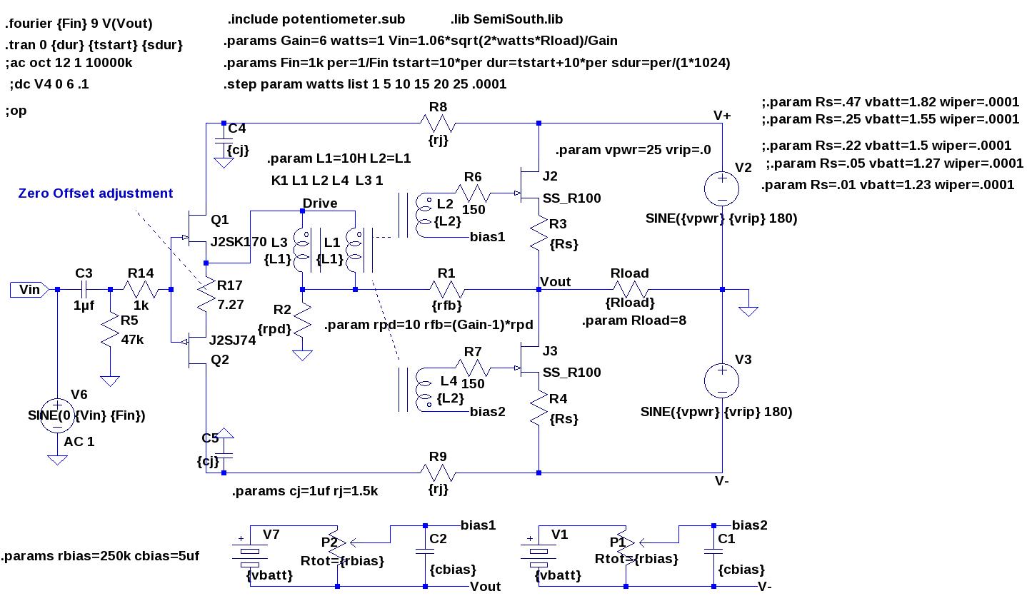

Here is my attempt at the F6 design
This is a Spice simulation that looks pretty good, whatever that means. I do not have a lot of faith in the R100 models or the transformer model.
I have most of the parts needed to breadboard this circuit. In about 6 days the remaining parts will arrive and I can do the smoke test.

An explanation of the bias circuit:
Nelson actually suggested (perhaps in jest) using batteries. I did the following calculation: battery-life-years= battery-milliamp-hours/(milliamp-drain*hours-per-year). A typical AA battery has more than 1000 mah. 24*365=8760 hours/year. A 1.5 volt battery with a 250k ohm pot has a 6uA current drain.
battery-life-years=1000mah/(6ua*8760) = 19 years.
Thus, the issue with the battery is selecting a battery type with constant voltage over a long shelf life. The now unavailable mercury battery would have been a good choice. AA lithium batteries claim 10 year shelf life, but I do not know about their voltage constancy. AA alkaline batteries rarely are advertised to have more than 4 years shelf life.
The schematic contains ".param Rs=.01 vbatt=1.23 wiper=.0001". I do not suggest that you will find a 1.23 volt battery. If you have a 1.55 volt battery, the wiper must be adjusted for 1.23 volts bias.
The input jfets can be matched for identical IDDS, or a source resistor (R17) added the the JFET with higher IDDS in order to zero the output voltage of the input source follower. This is necessary to prevent DC voltage flow through the transformer primary.

I think a Lithium Manganese Dioxide battery is what you are looking for.
They have a flat discharge rate, maintaining their voltage consistently through out their life. They have a low internal discharge rate, comes in a 1.5 volt AA package. See Radio Shack link: Lithium Manganese Dioxide Batteries
I used the 3 volt version in a Vacuum tube preamp for years, trouble is you forget about them after a while. As the voltage drops the current goes up and the heat, etc.
Rush
even if you choose battery for bias ,Papa's regular solution will be , ahem , more - regular :clown:
regarding DC through primary - remember that feedback path ; it depends also on output offset , and how patient you'll be regarding setting it
I am sure Papa will have a better, "more regular" solution. I went for a simple design with small parts count.
Yes, the output offset is also a problem. I did some simulations with a capacitor in series with the primary windings. The problem (perhaps a Spice artefact) was a low frequency resonance involving the capacitor - inductor circuit. I do not have enough experience using transformers in the signal path to know how to best approach it.

Is capacitor coupling acceptable? The direct coupling you show at the primary will not influence potential DC offset at the output.
I am not familiar with LTSPICE. Please jot down: voltage of power rails, current flowing through each JFET, and the maximum power output into 8 and 4 Ohm loads.
Can one have multiple upper and multiple lower JFETs to increase power?
