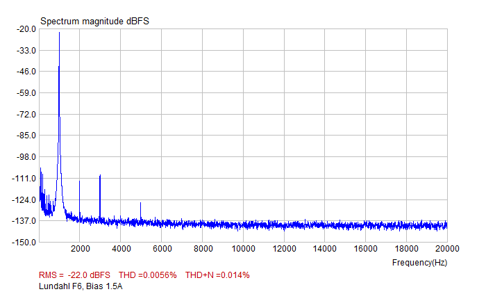

Palstanturhin what are you using to make the measurements?
Nothing fancy.
A PC-scope and a soundcard. ARTA software. Well, Victor generator for the 1kHz tests...
But anyways,
all you really need for audio is a good soundcard.
Something with 192kHz sampling rate at 24bits. Asus has one, for example, and so on...

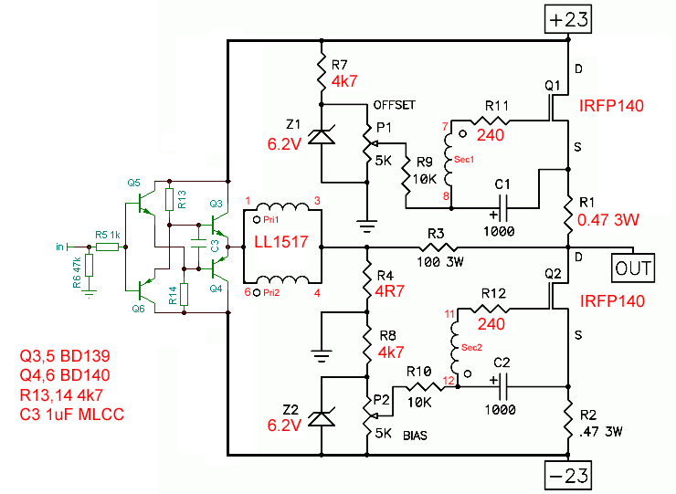

Final schematic and THD here.

LundahlF6 PCB
Is there any interest for a Lundahl PCB?
PCB size 250*50mm
and follows the diyAudio Store universal mounting specitication.
Symmetrical output stage. Select the side you want to use for the OPS mosfets, or why not USE BOTH SIDES for a double output stage!
Takes LL1517 or 1527 (and what not) or even the Jensen 123.
Diamond buffer, but JFET buffer also still possible.
I am aiming to bellow 10€/pc, but that will depend on the quantity as known..

Any chance you have a trimpot on output stage
Not possible, unfortunately. Has 4 degeneration resistors. You must play with the resistor values instead.
Uses the original F6 circuit where the capacitors are connected after the degeneration.

Just a quick question, is there any reason for using BD139/140 on the first stage of your diamond? I mean instead of say something like the BC550/60's or KSA992 or so (i.e. with more hfe)? It probably won't make a huge audible/measurable difference I guess...
Looks like you had them to hand (along with the 4k7 resistors 😀)

It does make a measurable difference actually.
Audible? I doubt...
But you talked me into it now.
Now I just have to prototype that too...
