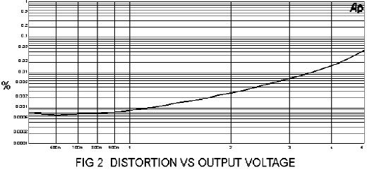

To follow up, Russell, if you look at the distortion figures for the B1, you can see that the circuit is best suited for small signal use. As you begin to ask for more voltage swing, you see that performance is dignificantly affected. It does incredibly well for what it was designed for, buffering a signal in the 0-2V range.
Got you on that. I will just rethink how I implement this amp
