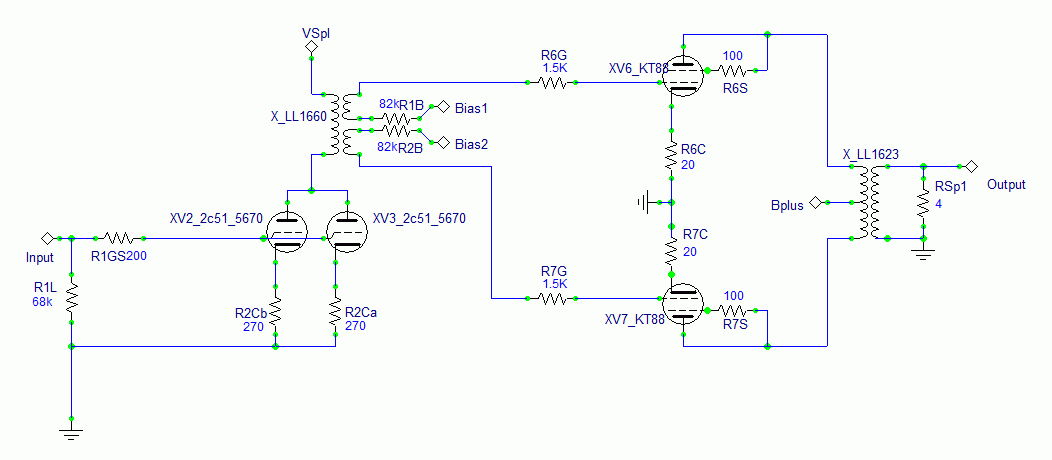

I wonder if it is possible to build such transformers at home, why not?
that can certainly be part of the fun and the DIY spirit !
but the transformer can have a big impact on the sound quality, usually it struggles the most at the frequency extreme's (although I think some people worry too much about that)
I have a pair of Hammond 1+1:1+1 transformers that I was saving for a circuit like this... hmmmmm 🙂
The use of a IT transformer is often done in the tube world.
In one of my tube amps I tried different phase splitters, the best sounding to me was the one with the interstage phase splitter.
In my tube circuit an IT splitter had the following benefits:
1. perfect balanced splitter
2. works as splitter and interstage coupler, no coupling caps needed to the output tubes.
3. works also as a choke for the driver tube.
4. bias of the output tubes through the IT
I still listen to that tube amp besides my F5 😀
Grts,
Danny
