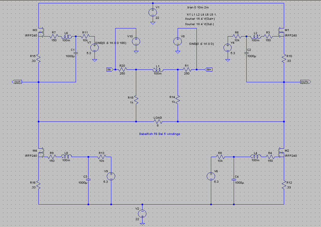

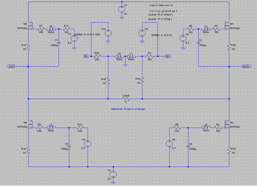

before the blog
Dja (but if I had an LO transformer with decent specs AND enough windings I wouldn't be asking you stupid questions, now would I)
5-fillar is enough for balanced input , with floating primary
5-fillar with one winding CT (kosher) , or 6-fillar (count in gain difference) are full monty
