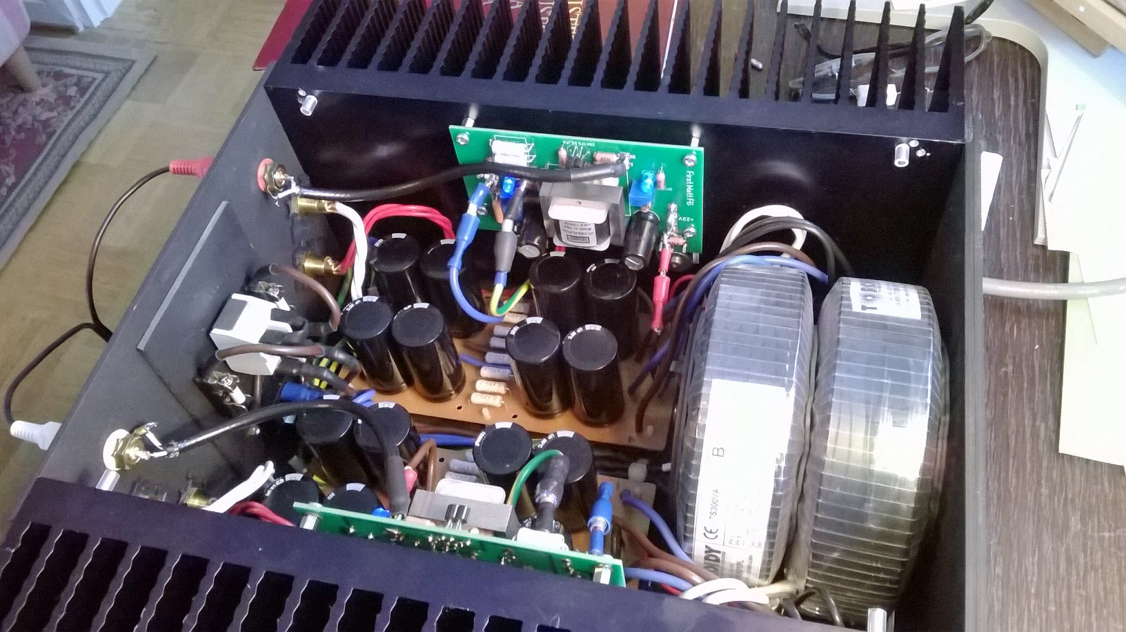

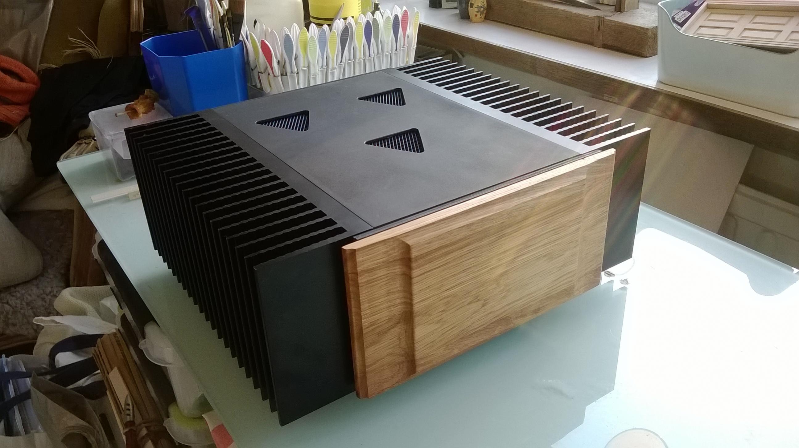

All the power stuff still connected with Abiko connectors, but once things are settled, I'll shorten the wires and solder everything together. :cool:
Techically I think the signal wire is not coax but a shielded signal wire (Hypex made for NCore) but I'll try thin/twisted too.
Also on the power supply I have ready made tabs to connect/try additional caps.
Georg, you've been a great help with parts and advice - thanks! :)
No meaningfull listening impressions yet I'm afraid. I suppose pretty much what others are hearing..? What I heard through the desktop speakers was nice and quite engaging but that in it's self doesn't say much. I'll still have to listen properly with the amp in my main rig and try the harmonics tuning. Then after settling in with the prefered ajustments it will be compared to my Hypex NC400s and to my VAC monos. I post impressions then. :violin: :)
