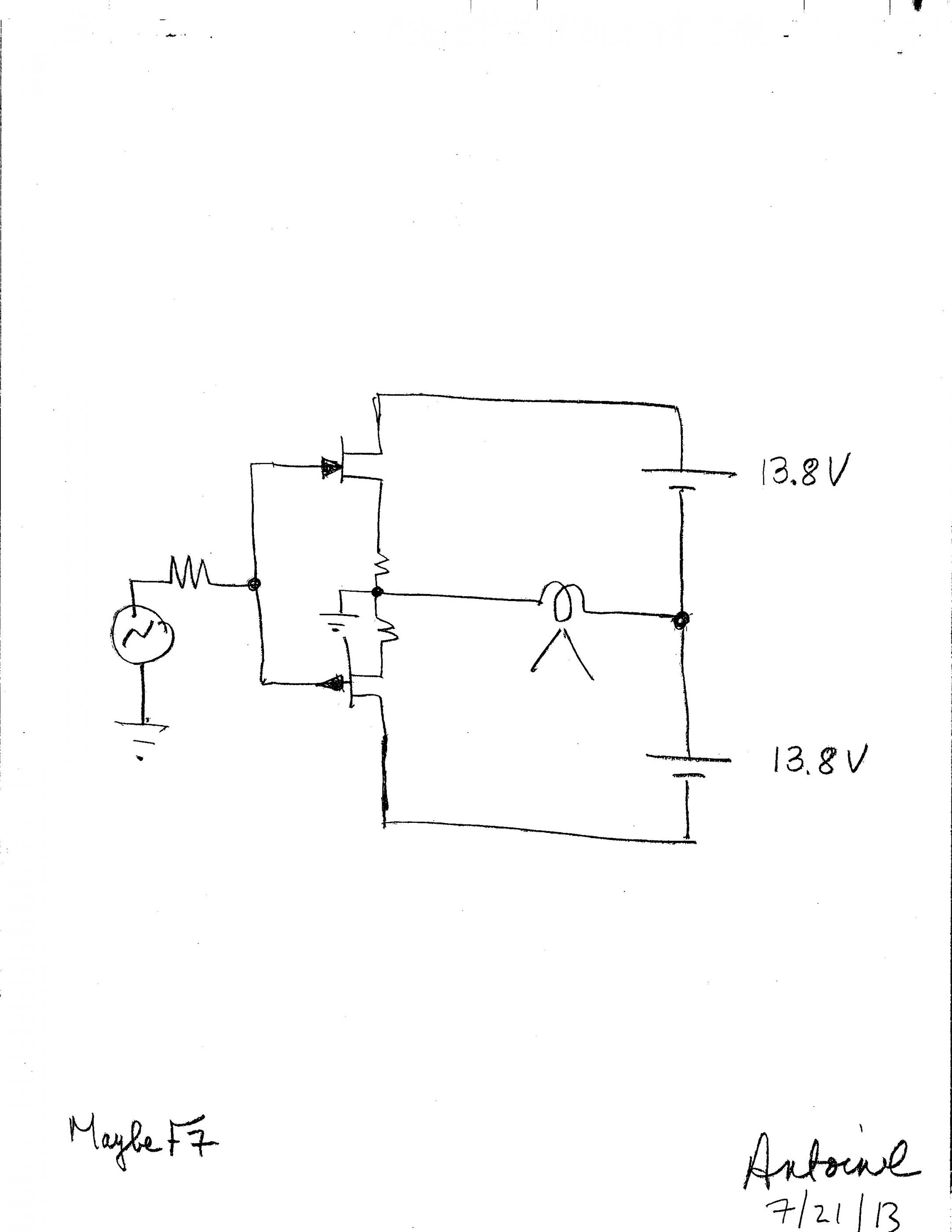

Maybe F7
It is derived from the "Beast with a thousand JFets" by Mr. Pass. It has the simplicity and efficacy of his design doctrine, plus the usual front end of several FW amps.

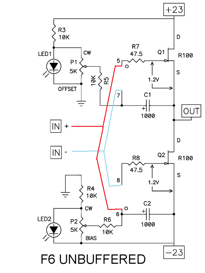

Another thing I thought about:
If I've understood correctly the purpose of the transformer is to act as a phase splitter. If you already have a balanced source, would it be possible to skip the transformer, the feedback and just connect the inputs directly?
ya can see those 1KuF as shortie , for AC signal
so while you're trying to feed upper gate , lower 1K is silencing it
while you're trying to feed lower gate , upper 1K is silencing it
you have one spare winding in quadfillar ; so , having more than several ways to skin balanced cat

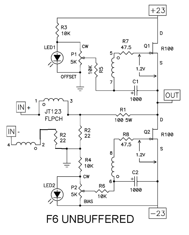

Hmm, the pursuit of knowledge continues...
Would this work or have I forgotten something this time too? 😉
And on another note, If I've understood correctly the F6 has very much in common with the JLH / PLH except that now a transformer splts the signal. And that the "sound tuning" is about letting one side doing more or less ( or equal ) load of the other side.
If one would go pure SE and disconnect the trafo from one of the parts would it be enough to connect a jumper wire on the then ccs side? Would be fun to build one and compare against my F2.
