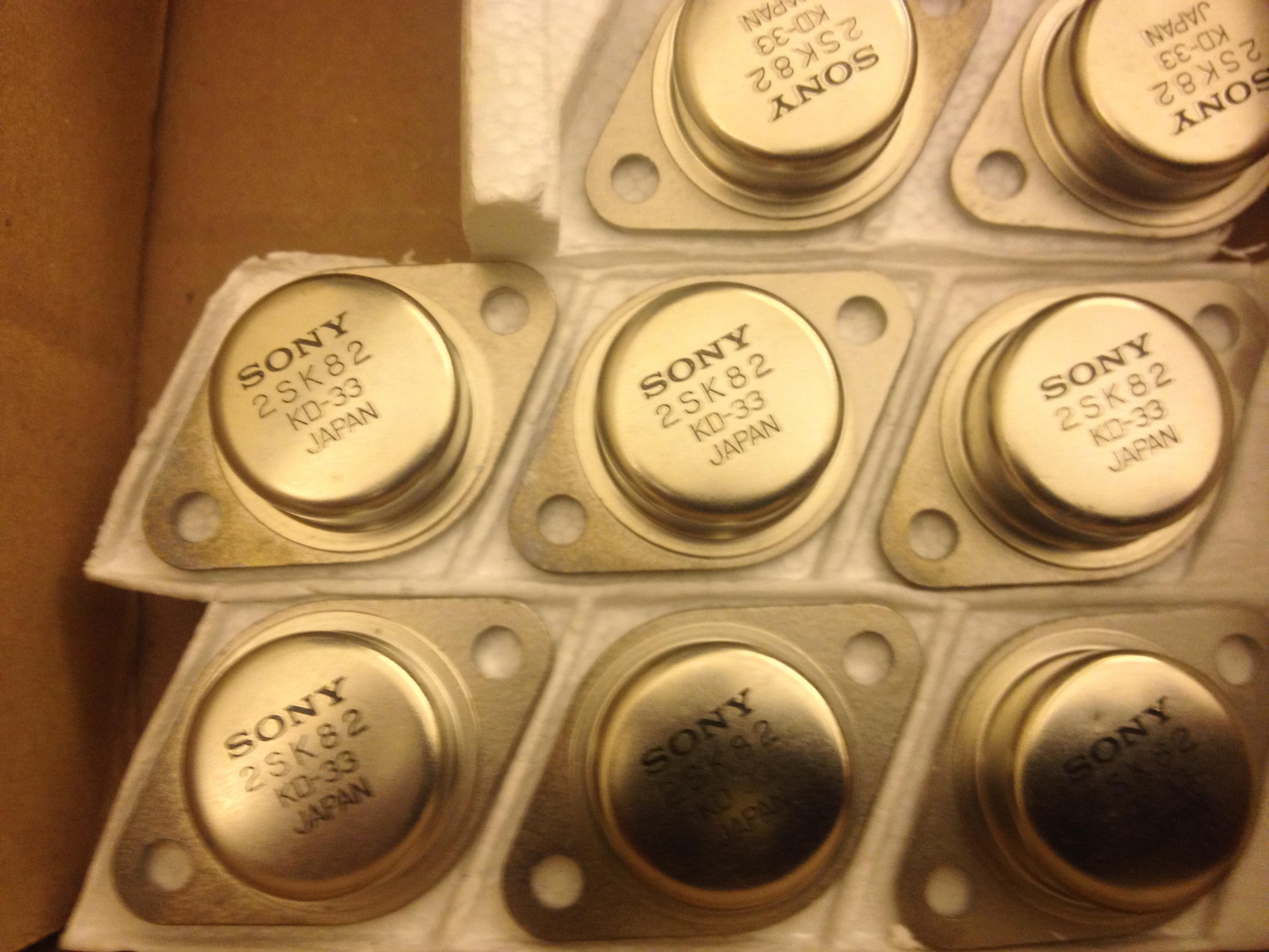

Complementary means no dodo Good news
ah .. wouldnt count out dodo parts just yet ... remember complementary VFETs ?
He wouldn't.... would he?
Still available at acorn man n yes, I do believe that he Could....
Thanks - most intriguing .... Must check it out. Digikey ?
