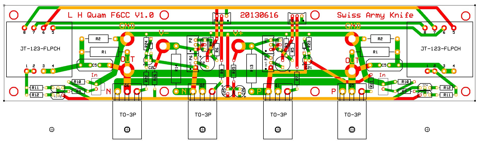

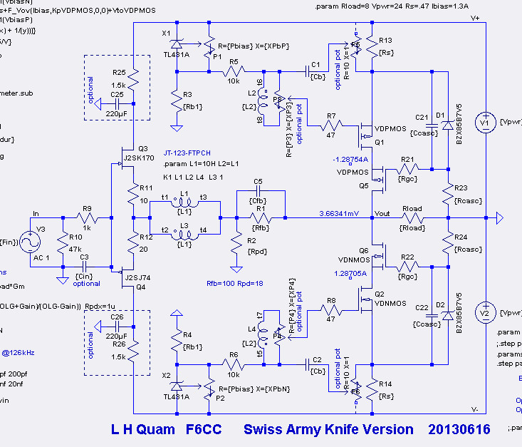

Simulations of a circuit based on post #4540 http://www.diyaudio.com/forums/pass-labs/216616-f6-amplifier-454.html#post3527968 suggest that it would perform very well with NO FEEDBACK, having an open-loop gain of about 70 into 8 ohms and -3dB at 67kHz.
The artwork is finished and I intend to order PCBs tomorrow.

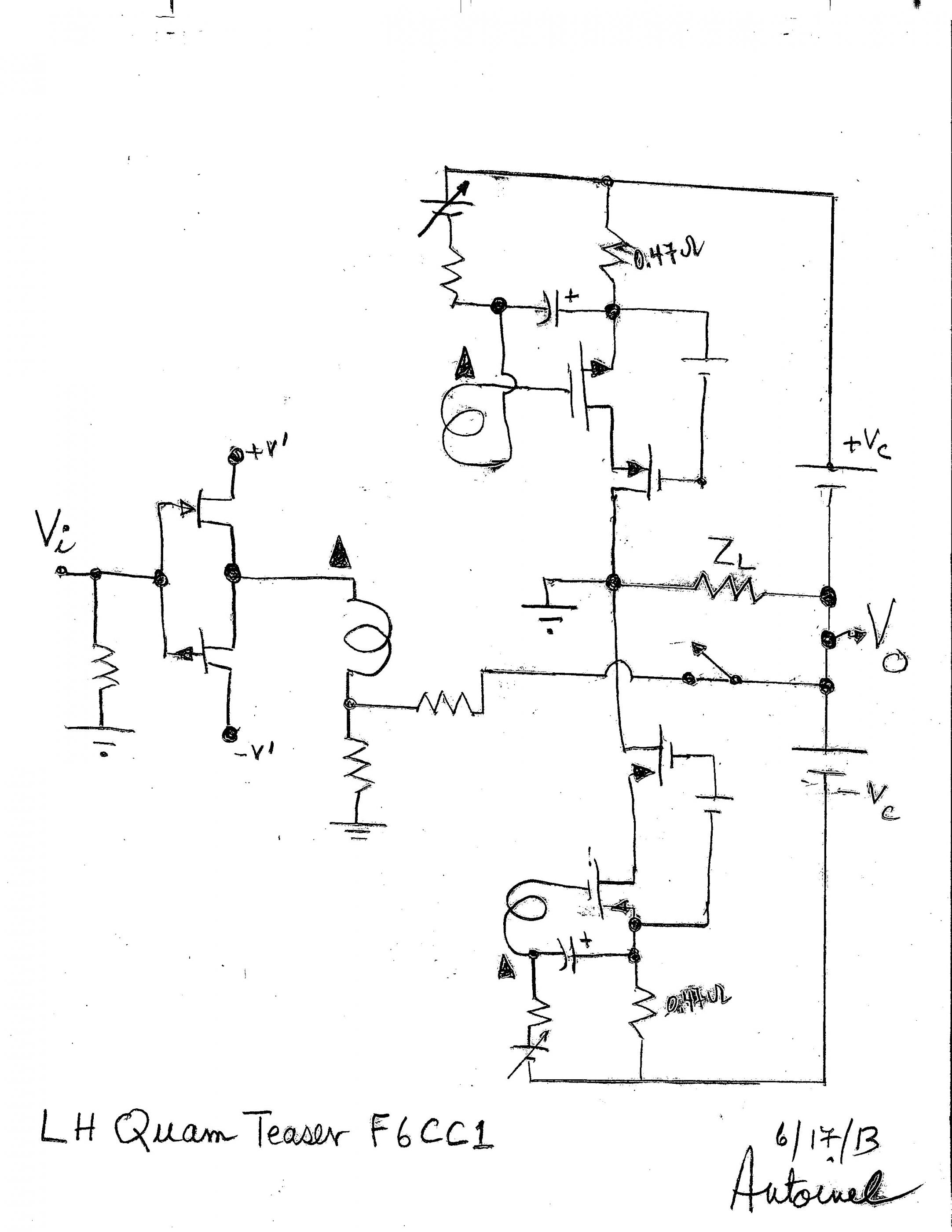

With your PCBs in my hands, I maybe able to expand the versatility of your circuit. Please see the attached picture of my hand-drawn circuit of it.
  • Use the junction of the opposed drains of the cascoding transistors as COMMON or Ground
  • Derive the power output port [Vo] at the junction of the two power supplies.
This new circuit has the performance attributes of the parent [source and drain currents are identical]; plus an intrinsic low impedance prior to applying negative feedback. Its enabled negative feedback is not Pass but the classical Black. Thus the amp is expected to have pentode-ish characteristics.

I suspect that the upper cascode fet is intended to be PMOS -- the arrow is wrong. The bottom coupling cap is backwards. The bottom secondary winding is backwards.
Interesting idea. When you start to float the power supplies, the circlotron topologies come to mind. Here is my analysis of the proposal: Ignoring interwinding capacitances for the moment, I suspect that the two alternatives would be equivalent. When interwinding capacitances are considered, in your design the secondaries that an AC swing equal to Vout relative to the primary windings, which will generate 2nd harmonic distortion increasing with frequency. In my design, the secondary windings have very little AC modulation relative to the primary.

Thanks for your post. My apology for my mistakes above. May I ask:
  • What are the power rail voltages. Are you considering to use + and -23 V?
  • What is the split of a power rail voltage between Vds for the gain transistor and the balance for the cascoder?
  • Is Vds for the cascode transistor fully utilized as Vout?
  • Is the transformer able to deliver a secondary voltage equal to the resultant Vo[pp]; because this schematic shows a unity gain output stage; unlike the parent [yours] which has a voltage gain of 70.
  • In earlier posts of this thread, Zen Mod proposed a schematic using complementary SITs. I do not recall whether this output stage had voltage gain or not. If its voltage gain was one; then ZM may have an idea which step-up transformer to use. I 'll look again at his schematic, and tie things up.

Lots of questions.
  • The rail voltages can be about anything above about 16V, consistent with the capacity of the heatsink, with only minor adjustments to a few bias resistors.
  • The cascode gate voltage is set for Vds of the drive MOSFET of about 2-3 volts.
  • Yes, Vout should be able to swing to near to drain voltages of the drive MOSFETs, which are set be the cascode gate voltages.
  • The transformer is unity gain. The output stage has voltage gain since it operates in common-source mode.
lhquam. Post# 3431 shows the schematic proposed by Zen Mod which uses complementary SITs. The output stage has voltage gain [Vo at opposed drains] like your circuit and not unity as I proposed. Still, please count me in for 2 PCBs when the dust [or etching] settles.
Zen Mod's circuit has intrinsic triode-ish properties when it operates open loop. They are further emphasized or augmented by Pass Feedback. Interesting and new consequence of topology.

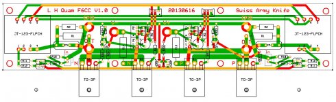

Yes, indeed it does conform to the diyAudio UMS. I do not use Molex connectors for power, gnd, and output. I use #6 thread hex aluminum standoffs instead, primarily because they offer more flexibility in placement.
Here is the LTSpice schematic and ExpressPCB artwork. I will rework the schematic to provide component values instead of expressions once I tweak the design on the bench. The PC board layout permits the transformer, input stage, and feedback network to be placed at either end like Nelson does in his F6. I accomplish the same with a single board rather than one designed for each side on the chassis. The cascode MOSFETs are located in the best spot for heat dissipation, assuming a heatsink approximately 10 inches wide. There are a number of optional components, as indicated on the schematic. If the components are not used, jumper wires must be added. I considered the alternative adding traces for those connections which must be cut if the option were to be used. If people like that idea I can do that in the next run of boards.
Great job on the schematic and PCB. Your creations are an example of innovation. I like the inclusion of the resistors [1.5 K] on the drains of the front end. They are an opportunity [for me] to feedforward signal and/or simultaneously bias the output stage.
