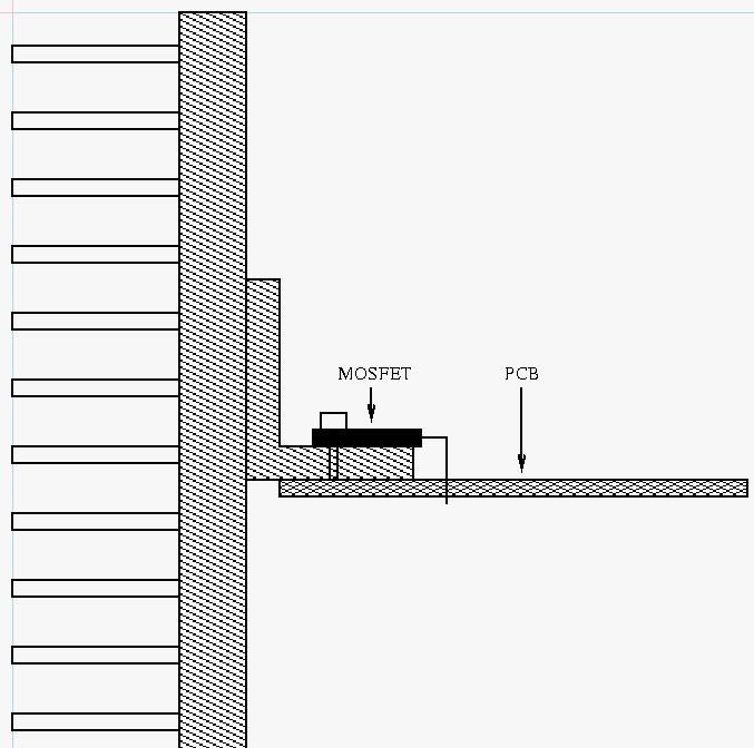

I have been studying the FirstWatt enclosure and the way boards attach to the heatsinks, which I find to be very appealing:
  • The boards attach to 90-degree aluminum flanges that allow the boards to mount perpendicular to the heatsink.
  • The boards mount underneath the flanges, allowing circuit traces to run on both sides of the output FETs.
A good example of boards is with the FirstWatt F4: Look at page 15 of FIRST WATT F4 for the board layout, and the 6Moons F4 Review for pictures of the packing 6moons audio reviews: FirstWatt F4.
The question is how much the flanges impede heatflow to the main heatsinks.

Essentially none -- the flange is on the interior face of the 'sink, where little heat is dissipated. The outside of the heatsinks is where all the heat goes.
The source of the heat is the MOSFETs. What is the temperature difference between the flange under the MOSFET and the main heatsink at the closest point to the MOSFET? See figure:

Thermal runaway is a somewhat separate issue from heasink characteristics. Depending on the particular MOSFET, the datasheet will specify a maximum junction temperature and thermal resistance from the substrate to the MOSFET package. Depending on the mounting technique (mica and grease, therafoil, ...) an additional thermal resistance exists from the package to the heatsink. Combining the heatsink geometric/thermal model, air temperature, airflow, and MOSFET power dissipation, one can estimate the junction tempereature.

Check out Conrad's site. They have a write up about this very thing, as they have flanges on their sinks.
Here ya go
Conrad Heatsinks - Technical Details
The Conrad WMF30-1F-75 appears to be appropriate for the 60-70 Watts per channel needed for the F5, F6 and other 25W/ch amplifiers. It is very long at 300mm. I much prefer to form factor of the HeatsinkUSA 10.8 heatsinkhttp://www.heatsinkusa.com/10-080/. Unfortunately it does not have the flange.
I know there have been a couple attempts at GB for the sinks. Major pain though and extremely expensive otherwise due to shipping. Rigt now, the store chassis or Heatsink USA are the best options. For my next big amp, I was going to mount 8"x3/8x20" plate to two HUSA 10.08 profiles, but have to have them machined flat to do so, so I am looking for alternatives. Can't say that I care about flange that much ask prefer directly ting to plate. EUVL used flat back version in his F5X, if that tells you something about comparison.
