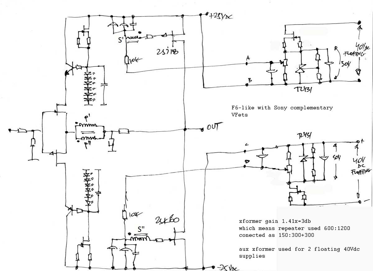

"I'm thinkin' of F6 lookalike with 2SK60 and 2SJ18 ( so having complementary pair of VFets) , using 600:1200s ( meaning 150+150:300+300) repeater .
logically ,connected as 150:300+300 , having some 3db in xformer phase splitter itself
but , that's on loooong rope , having at least 3 projects tied on same line"

here's quick draw of Sony Vfet complementary F6 concept
time for another public disgrace of Mighty ZM
:devilr:
I'm not going to try it in next ...... 6 months ......... or even later 😛
disclaimer - my main spks are 16 Ohms , so for my needs everything is relaxed , regarding OLG , CLG ,NFB,yukyuk
edit : recommended reading , needed for circuit calc : https://dl.dropbox.com/u/20665608/SONY VFET AES.rar , tnx to RK R
dunno how long it will be there , so down it
editedit : for sorta useful logic for circ calc , see Pa's BA3 article ; scroll down to my comment , where I done all work 😛 😀 , decrypting differences between explanation and schm nomenclature

not much for chewing
just look at it in blocks - front same as in F6 , bottom out same , upper out flipped
biasing for bottom - depletion , keeping gate well below source
biasing for top - depletion , keeping gate well above source ( aaargh! I wanna P type toobz !!)
floating bias supply for top , floating bias supply for bottom - each made of 28Vac winding going to Graetz,small cap , then rest - made of small Jfet pushing 10-15mA to TL431 shunt reg , then simple resistive divider for establishing proper bias
luckily - they're saying that Sony VFets are pretty well behaving regarding tempco , so no need for further complication
whatever - as every concept , it needs verification in praxis

BTW why do you want to take a complementary pair of SITs and no two SK82? Many of us may have at home....
because I have ( well , not exactly "I" , but Bata Bane - he acquired them for rejuvenating his Papa's TA-5650) leftovers - 2+2 pairs ;
whatever - it's easy to accommodate biasing scheme for complementary , taking care of Pa's arrangement (upper ref. to gnd) ; I would still go to both biasing circs based on floating supplies , it's easier to grasp
