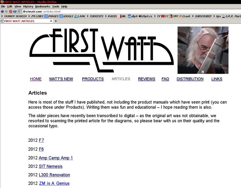

dunno - ask Pa for that
he's changing that page all the time ........ :clown:
