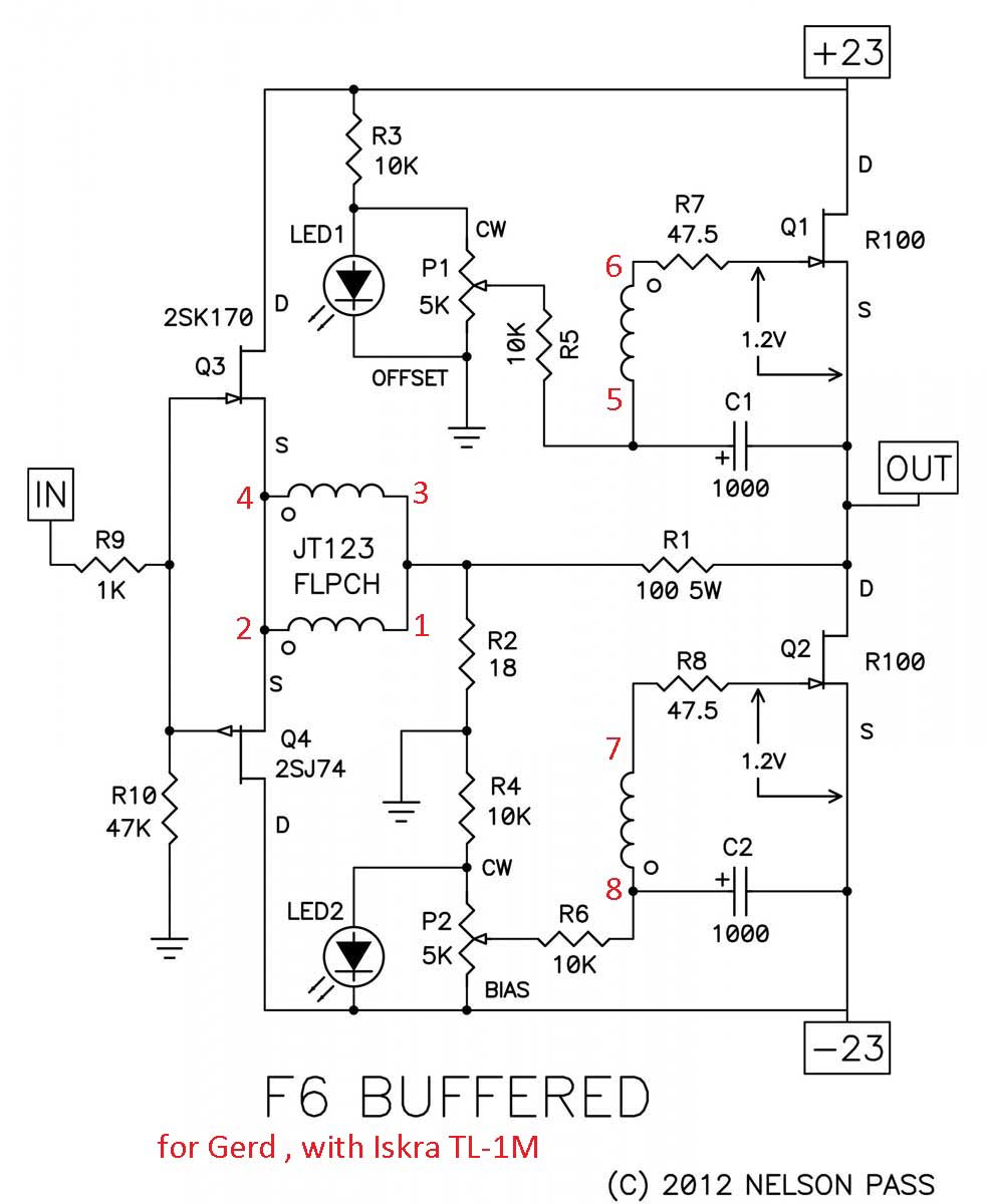

Hi!
ZM said the 2SK170 and 2SJ74 should have an Idss of 8mA.
I have two pair of the GR-types here, which have an Idss of 4,70/4,80mA. Will they work in this circuit?
What do I have to change in the circuit to make it work?
What are the disadvantages when using GR-types? Do you recommend to get some BL types?

just toss them in and make entire shebang
when/if you can find pair of BL matched ones , replace them
generally - with higher Idss group , xconductance is guaranteed to be higher , so output impedance of buffer is lower , which can't be bad thing

Do it, it is one of the easiest PTP I made, only thing is to check twice the polarity of the windings to be correct.
@ ZM ISKRA adventure continues tomorrow, my wife has a cold and I have to do the household and some more....😀
moi hope that Frau is better , by now
anyway , lookielookie .......
red dots on photo are positive end of windungs
