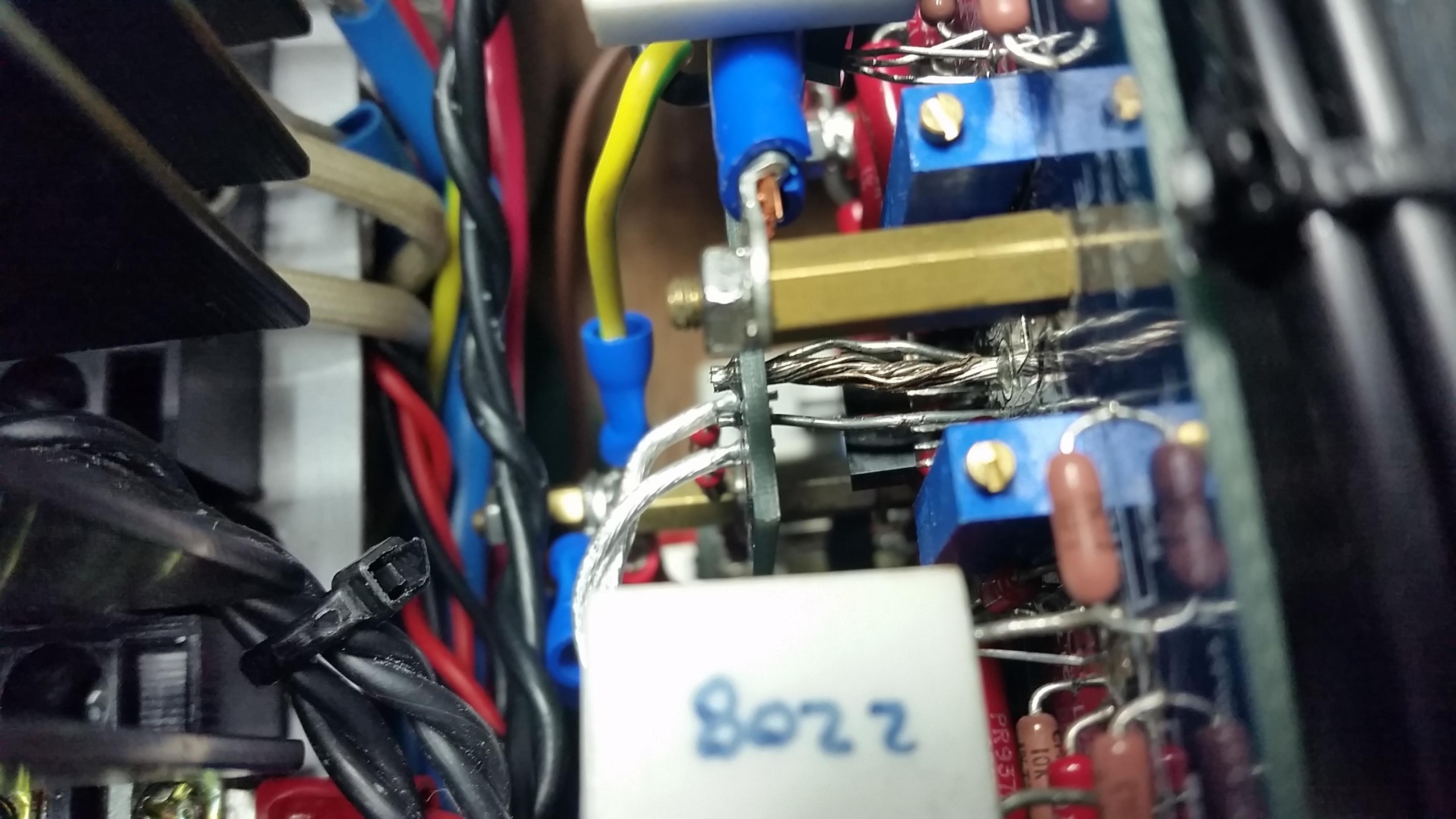

It even bend the jumpers from the input board to the main amp board. Any clue to which part that I should start investigating?

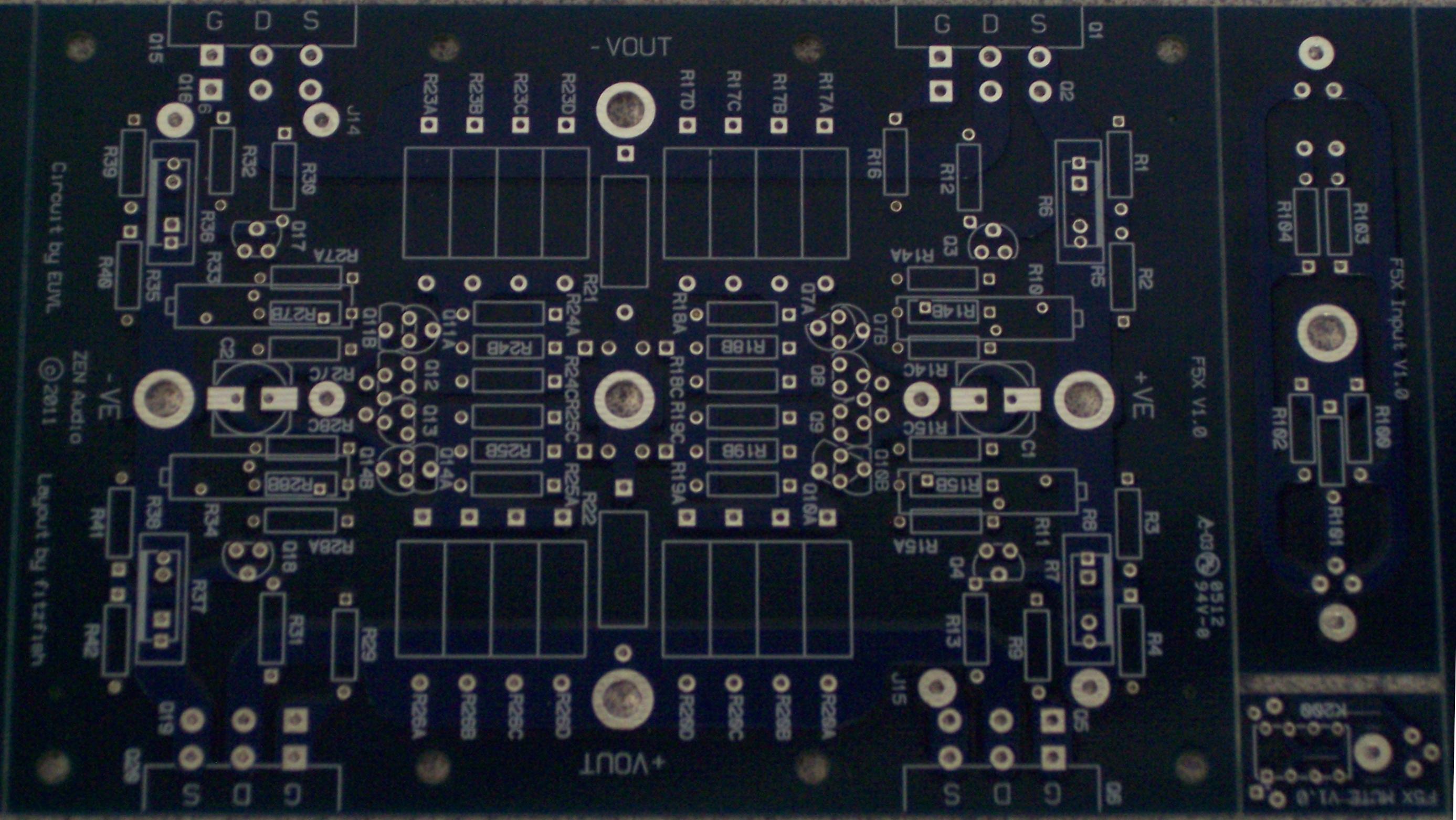

I connected the gnd from the input board to the chassis gnd. Somehow, it is connected to the (-) output of the amp. Is this so? I thought it was supposed to be floating.
Input ground > amp ground > disconnecting network or CL-60 or similar > chassis/earth ground.
(-) and (+) outputs might be connected to amp ground via 220Ω (R21 & R22), if you chose to use it.

> Yes, I used the R21 and R22 resistors.
No, they have nothing to do with your problem.
Everyone, including me, used them and we have no problems.
> Should I remove these or should I just remove the CL-60 thermistors?
None of the above.
You have a short of your output to Gnd, according to you.
I would first check that, e.g. whether the Drains of your MOSFETs are touching the heatsink electrically.

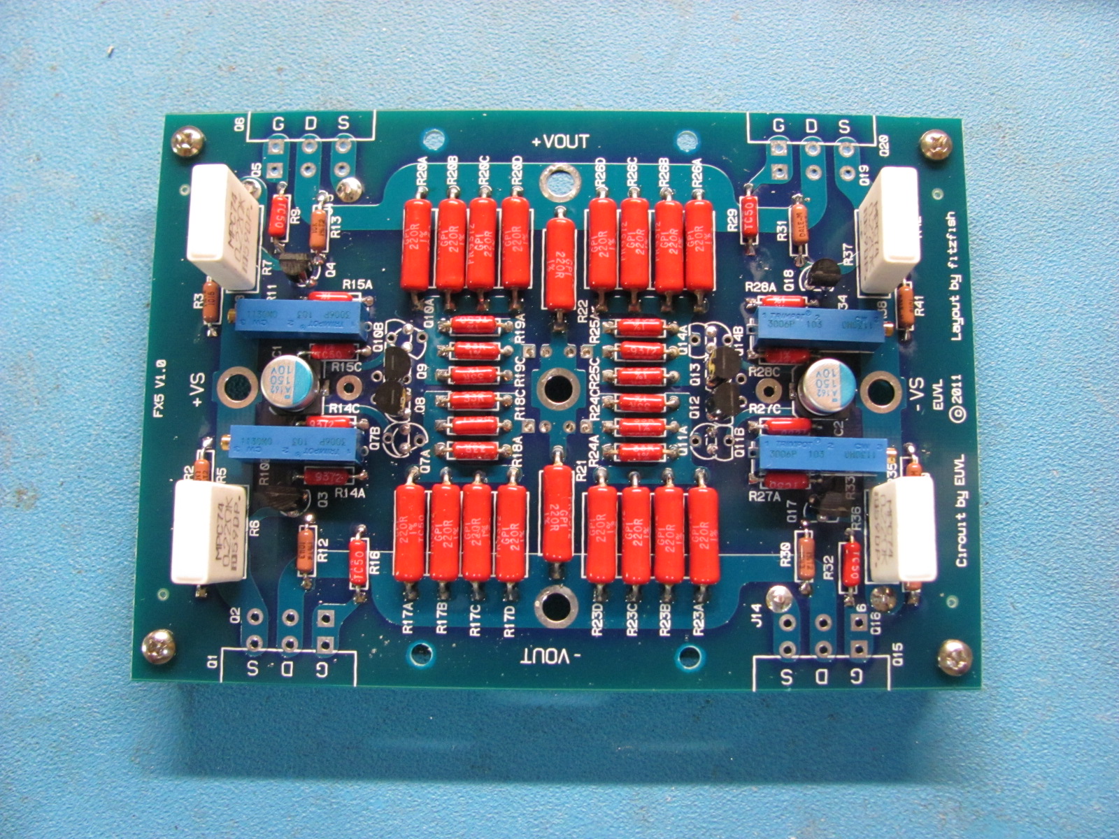

> I just noticed there are 2 smd capacitors between the trim pots.
Optional, and you should not have soldered the electrolytic cap if you are not using cascode, as shown in your photo.
I suggest you do your testing with lab power supplies with current limit.
And you should short the inputs to Gnd during testing.
