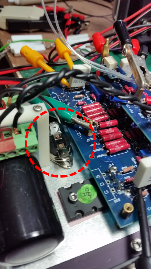

Are these thermostatic switches reliable (circled in picture)? I put 2 of these between the Mosfets, one at 60c and the other at 65c. I then raised the bias to 0.250v and it triggered both the switches. I then went back down to 0.213v and on the (+) side of the Mosfets, it even triggered the 65c switch. So. it seems one pair runs hotter then the other pair. If these switches are true indication of the heat on the heatsink, then it seems I can't go beyond 0.213v bias.

These thermal switches are not accurate.
Trust your digital kitchen thermometer.
Whether you want to switch off the amp with a thermal switch, and if so at what temperature, is entirely your personal choice.
If you wish to do so that you want to use 2 in series, one on each heat sink.
And you want to be sure they can take the current and the voltage.
Patrick

Thanks, Patrick. For a moment there I thought I need to reduce my bias further down. If these switche are not accurate then there's no point in fixing them. Take too much trouble too.
You can check the accuracy by putting in ice water and then in boiling water, as Scott suggested.
You should get somewhere close to 0°C and 100°C.
Then you know it is accurate enough for your purpose.
There is no magic about 60°C or 65°C.
