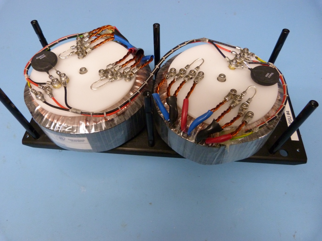

When I was searching in this thread for a nice solution on how to integrate the power transformers and how to solve the transformer connectivity mess I saw that I was not the only one who was on the search for proper solution.
For those how might be interested this the solution I ended up with.
Since I know this question will come:
I have 12 V and 3 V secondary coils such that I can combine them to 9, 12 and 15V. The shown configuration privides 15V each.
Markus

Hi Pmchoong,
the white pieces are flanges made from plastics, more precisely from POM (PolyOxyMethylen). The flanges are sitting on the potting material the center holes of the toroids are filled up with. On the bottom side the transformers are sitting on support rings that are also interfacing to the potting material. The coil itself is free from any mechanical contact and related mouning stress, only the potting material experieces the monting stress.
I attached the sketches of both parts.
Cheers
Markus

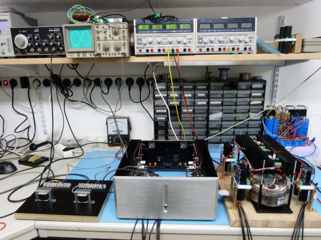

Considering a bigger housing and bigger heat sinks is certainly not a bad idea. The first for ease of integration and extendability and the second for lower operational temperature.
If you could fit besides the amp boards also the associated rectifiers and regulators to outer heat sinks then integration and testing will become much easier since you have everything needed to operate one channel besides the transformer mounted to one heat sink. Hence you could do all the wiring and pre-integration tests outside.
I will continue my bottle ship hobby with the original housing ...
First listening test were not to too bad BTW.
Cheers
Markus

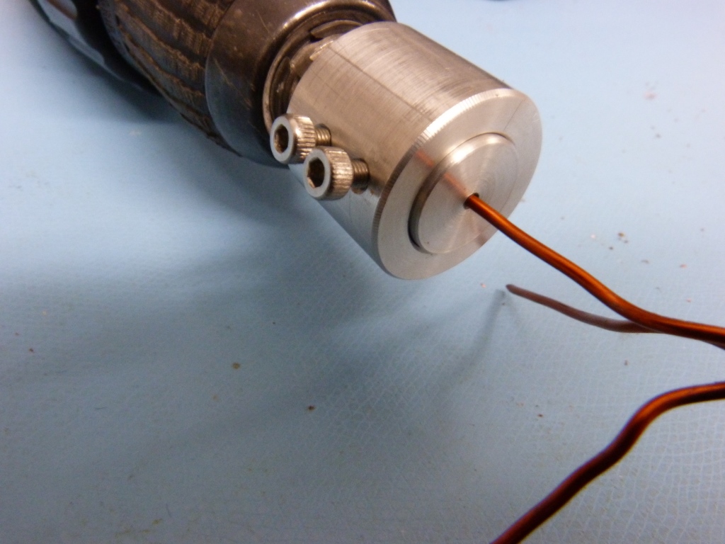

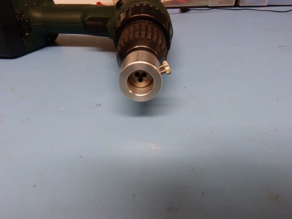

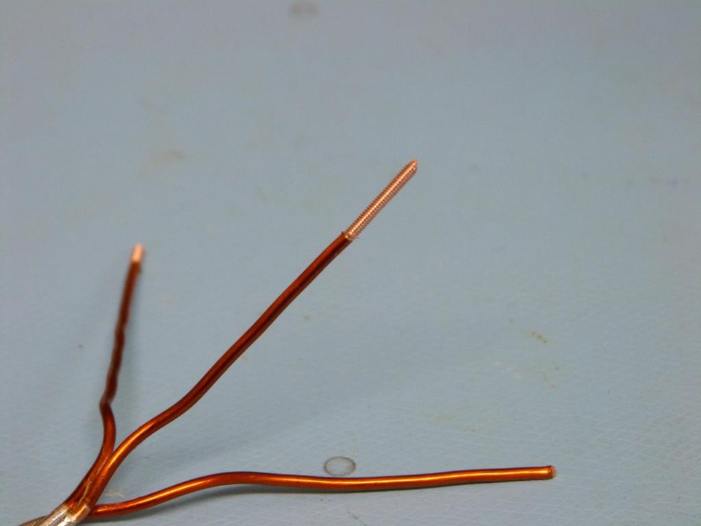

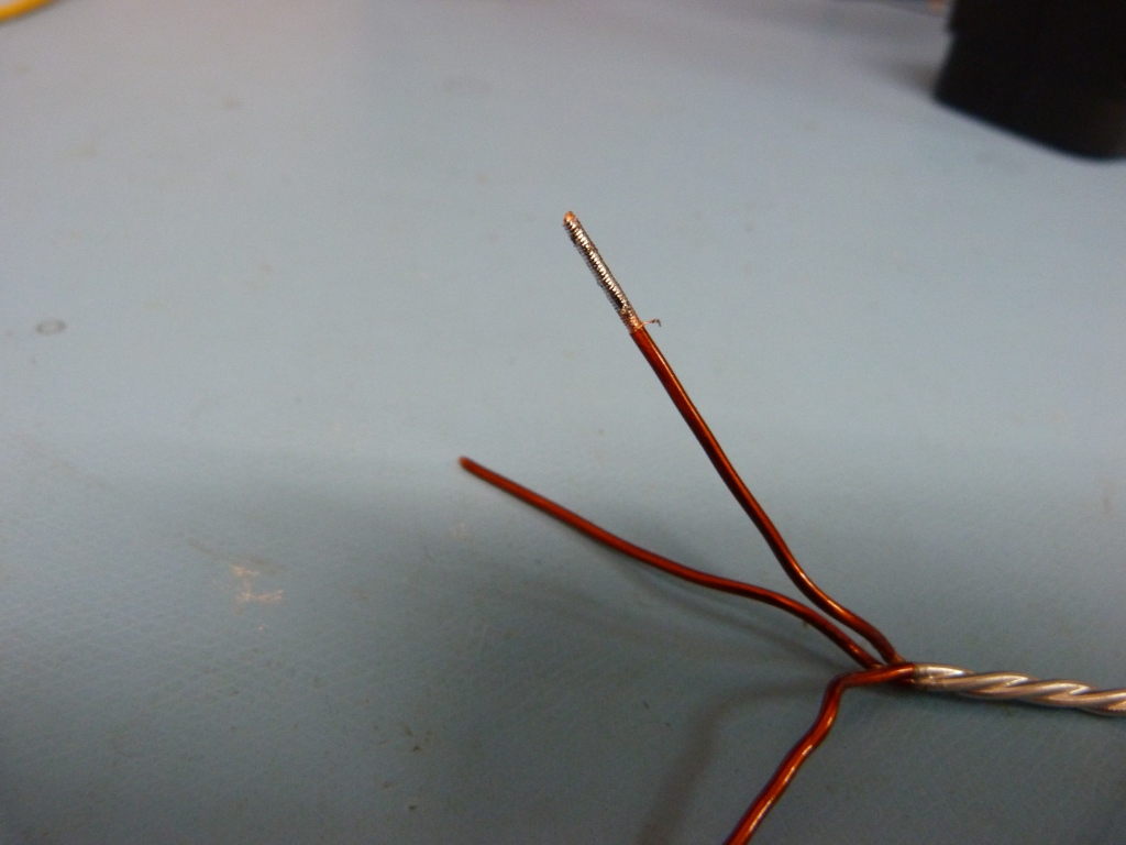

Stripping off enamel insulation from trafo wires
Since we had to shorten the transformator secondary wires we had to strip off the enamel insulation but this turned out to be a very time consuming task ( I have 2 amp units, 2 transformers each, 4 secondaries each, 3 wires each, 2 ends each = 96 wire ends) and the results were also not always of the desired quality. If there are residuals of enamel which are hard to see with bare eyes the solder does not wet properly.
I looked around for appropriate tools but the professional tools with a motorized rotating blade cost more than 500€.
So I invented my own simple and cheap tool. The idea is to cut a thread on the copper wire and herewith to remove the enamel. I use a M1.6 die for stripping off a wire with 1.55mm diameter. This works perfect, one wire is stripped off within less than half a minute and the solder wetting test show very good results.
Cheers
Markus
