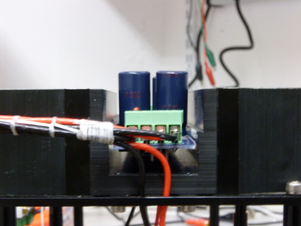

During a trail fit we found that the caps on the regulator board are standing out too far ( by about 8mm) so we will not be able to close the top covers of the amps.
We could swap them for ones with less body lenghts of course but I am wondering if others have encountered that problem as well or if we did something wrong. The caps are according to the power supply BOM ( Digikey No. 10305-ND, 35V, 1000uF, 25mm body length).
The standoffs holding the PCB are 10mm high as specified.
Clues what we might have done wrong are appreciated.

My 35V 1mF are 22mm tall.
35V 220uF are 16mm tall.
I doubt you can find 1mF that will be 8mm shorter (17mm tall) and still fit in the diameter spacing available.
Is there a way to drop the assembly down into the U channel?

This has been discussed 3 years ago :
http://www.diyaudio.com/forums/pass-labs/208880-f5x-euvl-approach-build-thread-14.html#post3578696
You may use Mouser 647-UVZ1V102MHD or 647-UKW1V102MHD.

Andrew, thanks for your remarks. I already checked if I could lower the PCB but the FET underneath only allows for 4mm at best, that´s not enough.
Patrick, may I ask if you could kindly commend on the design considerations that have led to 1mF caps? Two aspects came across my mind, filter bandwidth which is not effective when the zener voltage is reached or voltage ramp-up time constant during start-up. If the later applies I guess I could easily reduce the cap value by a factor two or three.

You can reduce by a factor of 2. You can also increase the resistor by 2x to retain the fo of the LPF.
But the caps I listed above will also fit, as the others have already tried.
Whether the Zener is regulating depends on your MOSFET Vgs, load current and your transformer output voltage (which varies from example to example).
It is there in any case to make sure the caps downstream does not see over-voltage.
And the Zener voltage noise is still filtered by the second R-C.

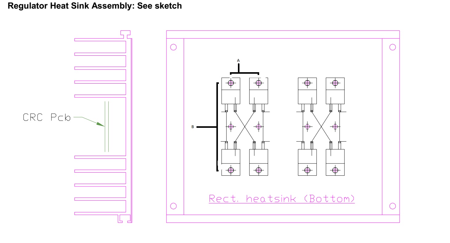

diode spacing
Can anyone tell me the spacing for the diodes on the heatsink?
After discovering the quasimodo thread I am looking to snub the transformers as well as replacing the diodes. Pre-building the bridges (PTP) would reduce the time the amp is out of commission. Anyone snub the primrose tx with the quasimodo?
Don't you have the mechanical parts from which you can measure ?
Off my head I think 50mm, but I don't have the drawings with me right now to check for you.
Patrick
