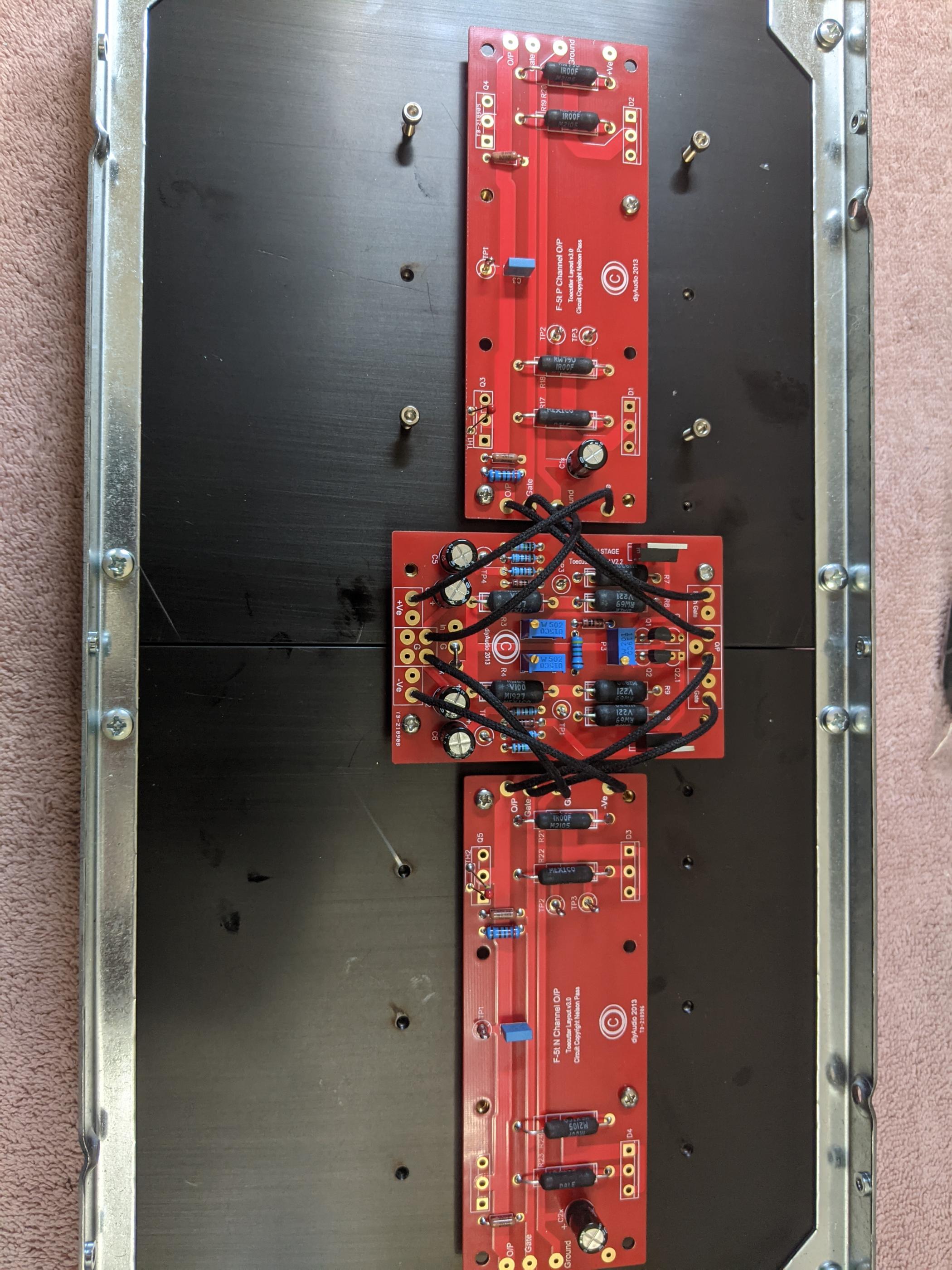

So I've done all of these interconnects in 20ga Dueland wire. Should some of these be a larger gauge? Like the Output and Ground?
On a side note: is there a reason to not turn the middle board by 180 degrees? Shorter and non-crossing wires as a result?
Basically just didn’t think of it. Guess I should have done that and swapped the output boards positions too. Just rotate the whole assembly of the boards.

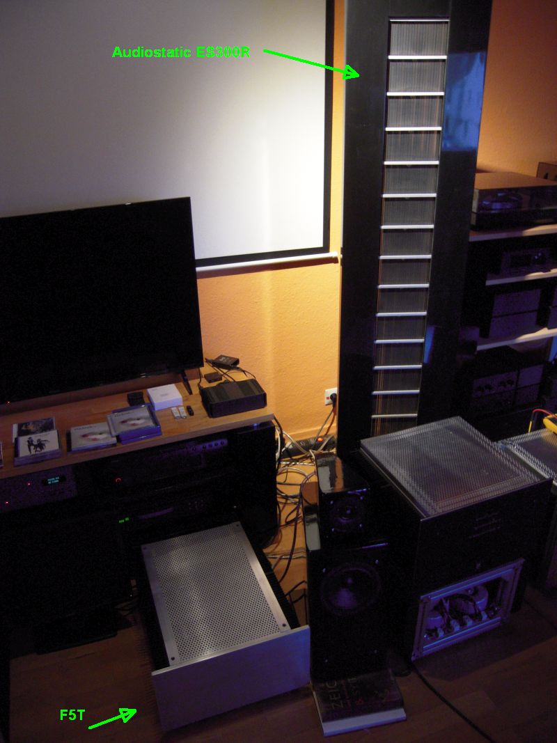

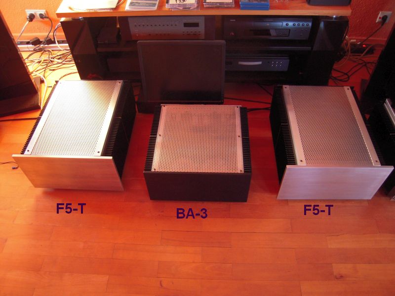

I have built F5T -V3-Monoblocks. They run on +-42.8V. Each Monoblock has a 1000 W toroid and some caps....
Excellent poweramps with my electrostatic Loudspeakers (Audiostatic ES300R)!
I use an active crossover for the sub at 80Hz. BA-3 poweramp is driving the subwoofer (JBL 15 inch).
