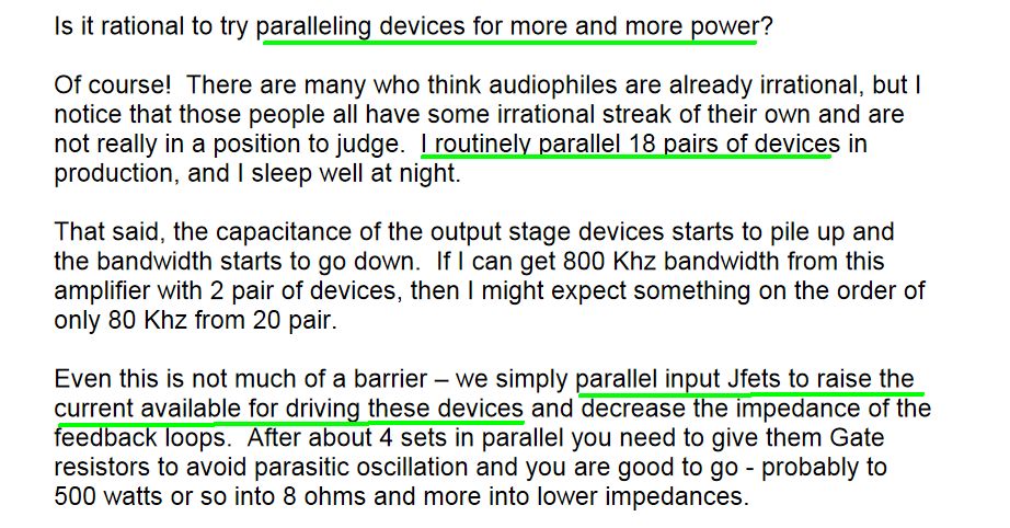

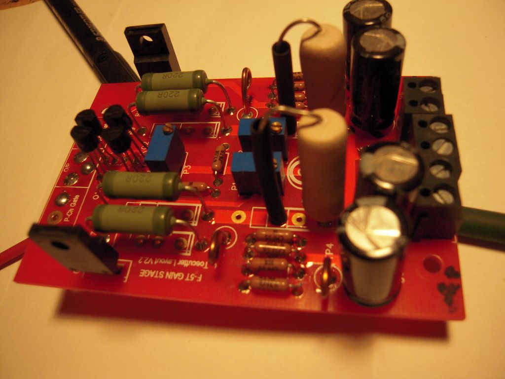

Trying to dot some I's and cross some T's here. Please tolerate cautious rookie questions!
On the new board is Q1.1 = Q3 on the BOM and Schematic = (2SK170BL)?
On the new board is Q2.1 = Q4 on the BOM and Schematic = (2SJ74BL)?
For non-cascode you need to jumper the top to the middle hole on Q7 and the middle to the bottom hole on Q8?
You also need to jumper the G hole to the LINK hole for a non-cascode single ended build?

OK, no response to the above so let me ask a different way...
Q1.1 and Q1.2 are on the latest version of the PC Board. They aren't mentioned in any BOM or Schematic I've seen. What are they? What version are they used for? What PN is used to populate them when/if used? Please help folks.
I'm not overly familiar with project (in physical domain), but I can try to help if you give me some meat - ref. schm and pcb pics
Q1.1 & Q1.2 are for v3 builds with more MOSFET output devices, not used and empty for regular build. Link to ground is jumpered and C to E on the unused cascode transistors. Look at page 1 of this thread for details.

if you increase the amount of output-devices (=Mosfets) in your F5turbo-build,
then you need more 'juice' to drive them (higher capacitance....).
If you increase your railvoltages over the maximum ratings of your JFets, then you also need cascoding - BJTs.
Mr.Pass describes this in his F5T-article. 😉

Found this... "The Q1.1 and Q2.1 position are left empty, they are there if you are going to make a huge F5T with more than 4 pair of output transistors, so you can parallel the Jfets and have more driver current."
