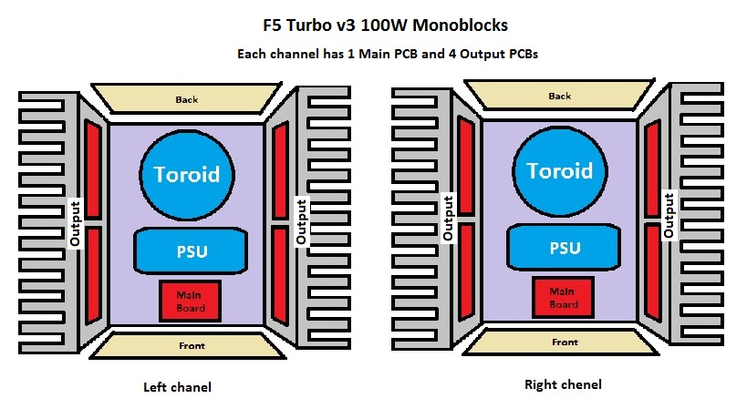

This is the consent of monoblocks for 100W setup....
Looks great!

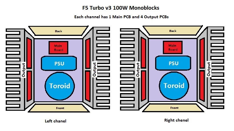

If you can put the FE at the back and the toroid at the front, it's much better.
Good point.
Done.
And better yet, mount the FE on the back wall to get the input wiring really short and free up floorspace for everything else. Similar to this -
I see your point, but at that case all wires from and to Output bards will be quite long. Is there no issue with interference of none-shielded wiring?
I would rather have those long than the input wires, when inside the case. Regardless, using shielded wire is a good idea...
I see. Thank you.

Why swap around the internals?
Short and compact Mains wiring would, to me, seem a better way to minimise interference. That would suit placing the transformer at the back near, the Mains input socket.
Twisted pairs, or even better screened twisted pairs, make very good signal wiring that is almost impervious to both internally generated and externally generated interference.
