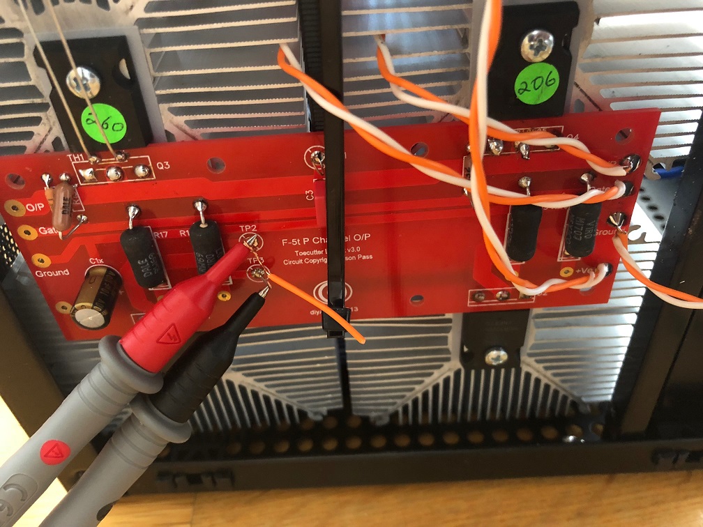

Hi friends

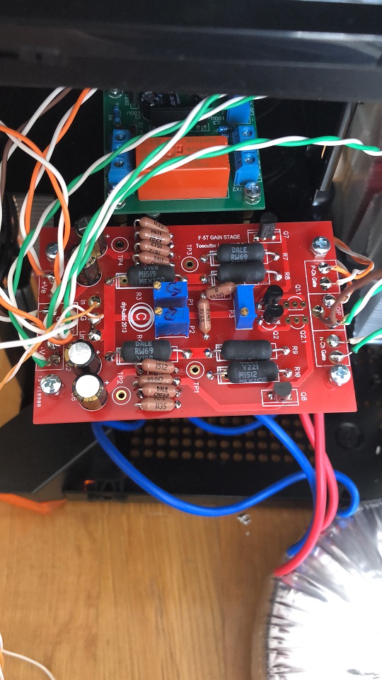

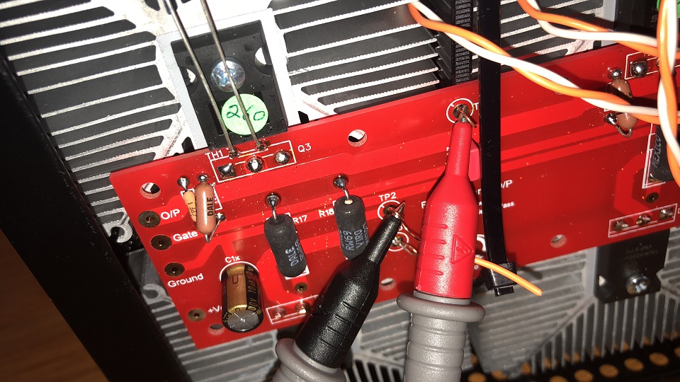

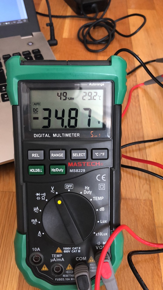

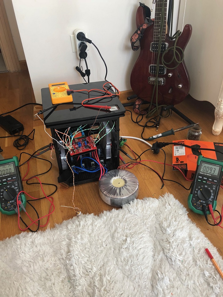

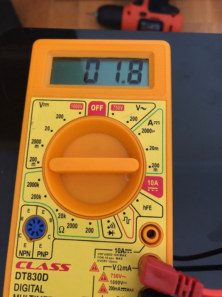

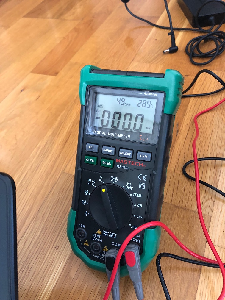

i have completed my f5 turbo project but couldnt set the bias. I ran out of trimmer turns. Dc offset is 1.8mv and didnt change during bias. Source resistor voltage stayed 0mv. Mosfets did not heat up.
I designed the amplfier two monoblocks each standard 50watts f5turbo. Fe board stuffed like cascoding. Each amplifier has its own 600va tansformer with +-35 volt dc unloaded.
hi sangramVoltage across JFET source resistors (10 ohm)?
do you mean R3 and R4? near the P1 and P2
First doublecheck your wiring, you've got a lot that's the same color, it's easy to make a simple error.
Also verify that the cascode transistors are installed properly.
Is there a fan in that case? You will absolutely need one, those heatsinks are incredibly undersized for passive cooling.
Dear 6L6
I checked the cabling will check again.
yes I have a 12 cm fan backside.
Did you mean by cascade transistors Q7 and Q8
They are Toshiba A1145Y and C2705Y
I am not sure about their orientation, did flat surface must look outside?
pls see the pic below (flat surface of the transistors looks inside)

I don't have that PCB or a view of the schematic, so part numbers are difficult to decipher.
Dear 6L6
Since i am not cascoding (no paralel output boards for now) should i consider cancel those cascode transistors and short Q7 and Q8) if yes how can i short?
